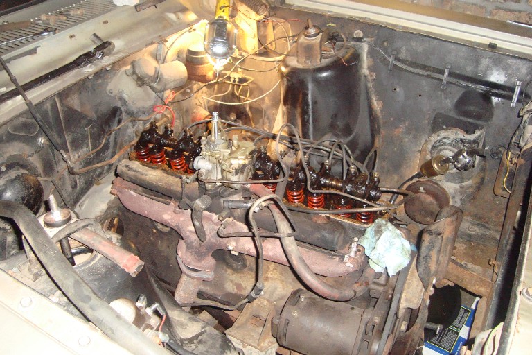

    Threw a rod on Sunday. Was gonna put a new motor in, but after hearing the advice of an experienced person and posting my misfortune here on The HAMB, I decided to rebuild. It's a 1962 Fairlane 500 that started life with a 221, but sometime in the 70's was changed over to a 170 out of a 63 Falcon. I'm good with that motor. Maybe put a C4 in also. Need to find out if I can mate a 1981 C4 to my 1963 170. I'll keep this thread updated as I go. The plan is to keep my FORD all FORD!
    03/23/2011
    Removed hood
    Disconnected exhaust
    Drained all fluids
    Removed radiator
    Disconnected fuel lines
    Disconnected all eletrical
    Removed all bolts on flywheel
    Removed junk hoses
    Removed junk starter
    Removed most bolts that mate motor to Ford-O-Matic
    Just need two more bolts and motor mounts to pull motor out.

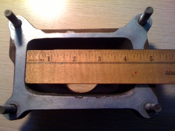

    Got my carb adapter in the mail today. This will allow me to go from single to two barrel.
    Not sure what carbs it will fit but it looks a lot like Jegs has..
    Please give me your opinion.
    Trans Dapt #969-2044
    Carb Adapter
    Holley 350-500-650 cfm 2 bbl to Ford straight "6" manifold or single venturi manifolds with 2-5/8" centers

    That is made to use a motorcraft two barrel or a Holley two barrel. That particular adaptor will work, but used directly to the log it will be at a kinda weird angle (still do able with a cable throttle), or it may be too tall wen used on the cast riser on the log to staighten it out. For a mostly stock 200, you want to use a 350 CFM Holley or Motorcraft two barrel. It will make a massive improvement over the stock 1 barrel. I'm using a Weber progressive 32/36 on the girlfriends 200 for her wagon that I used for many miles on my '62 Futura years ago. It was always a good balance of economy and much improved power, better idle too.
    I did think of one more thing to think about with '81 200 last night. It probably has a FOX body type oil pan on it and might not fit your Fairlane steering gear. No big deal to change to another, but just someting else to be aware of.

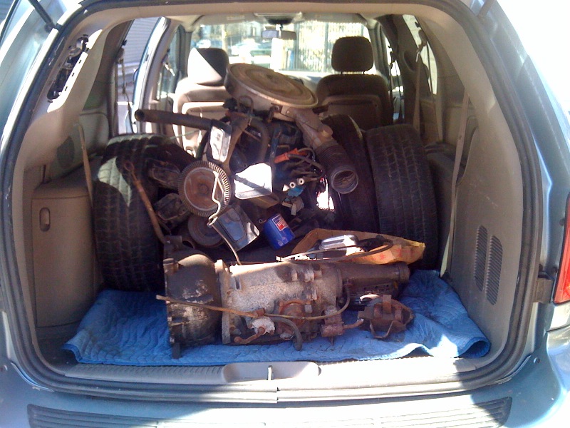

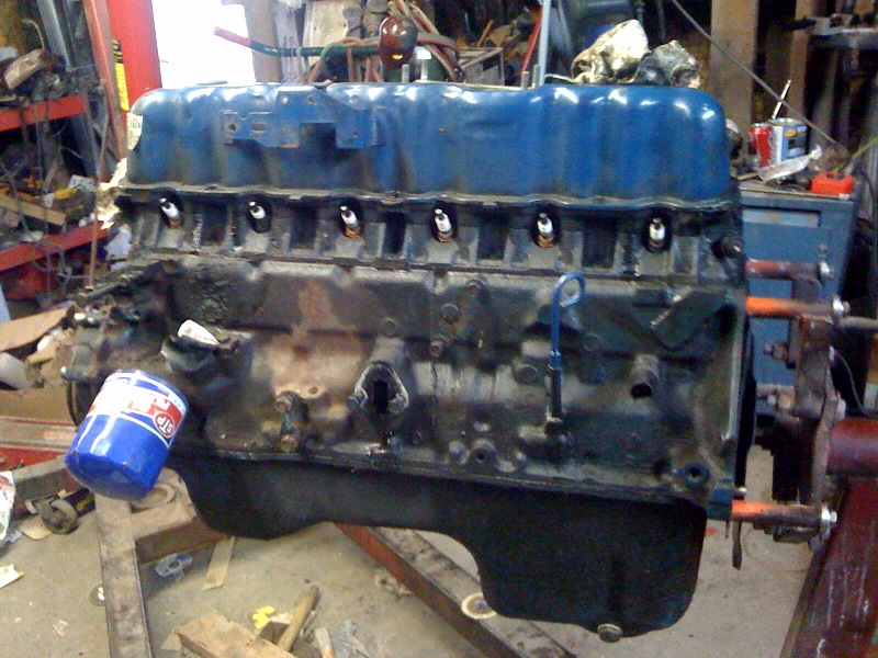

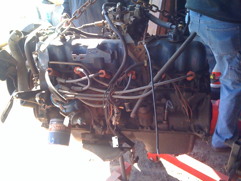

    Got my motor and trans home. 200 and a C4 out of a 1981 T-Bird. Bought off fellow HAMBer, Bubba57. Nice guy. Made the 90 mile hike out to Rochelle IL and then another few miles to the farm where his buddy lived.Some awesome iron out there. Had a good time out there. Think I may have made a couple of new
    friends.
    Plans for the motor... Take off the emissions crap, the a/c bracket, pulleys, rebuild the starter, replace manifold, replace oil pan, and I even got the yoke for the C4 to which I am adding a Hurst floor shifter. I'm excited.
    Oh NM the mini-van, my wife already ripped me a new one... I didn't care. :D

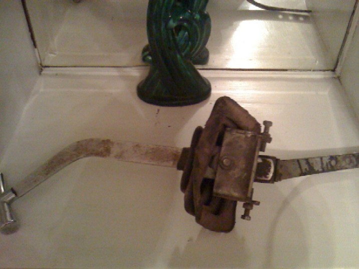

    Got this bitchin floor shifter for my car. It looks like the handle is rusty but it's actually dirty chrome. Gonna polish it up and get it ready for my trans. Looking to get a new boot.

    You made the best decision motor/trans wise. Why are you pulling the manifold and pan? Gaskets? Save the old 170 manifold if it is not broken, They are hard to come by. Sounds like you are having a lot of fun..keep it up. Ron

    I'm pulling that stuff off to go through the motor to make sure it's all good. I bought a new water pump, timing chain, fuel pump, and main bearings... all for under 100 bux on ebay.
    Also got me a Holley 350 CFM for $180.

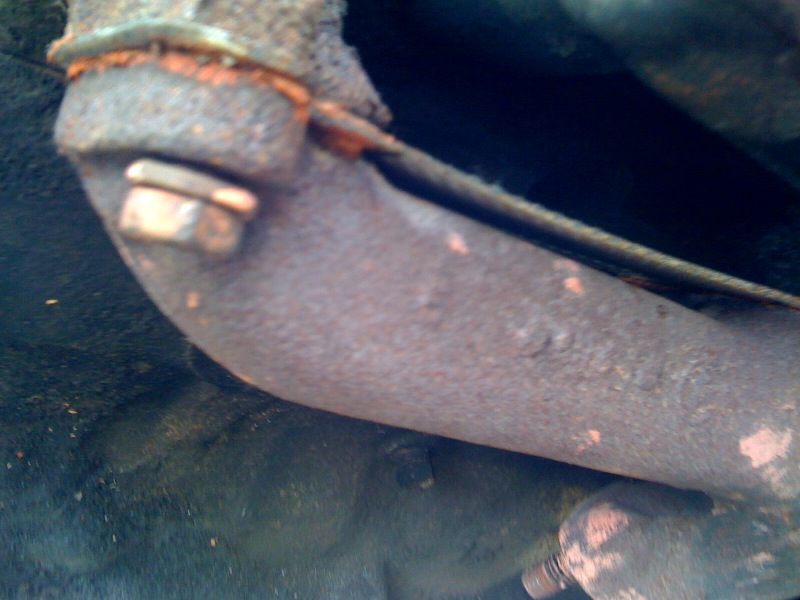

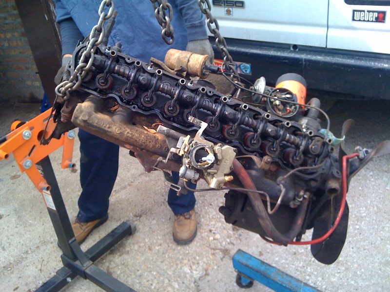

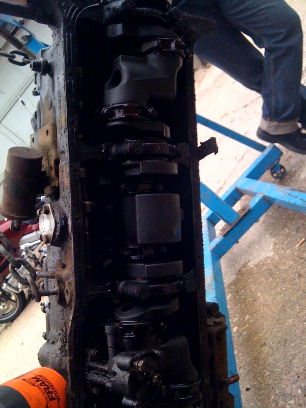

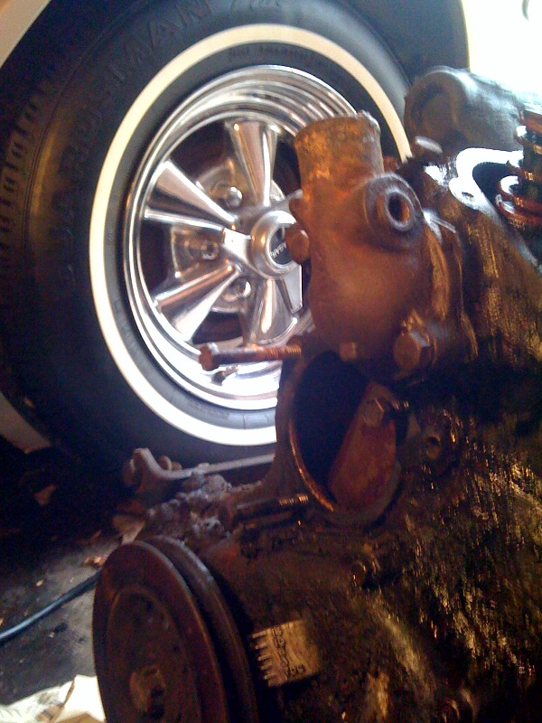

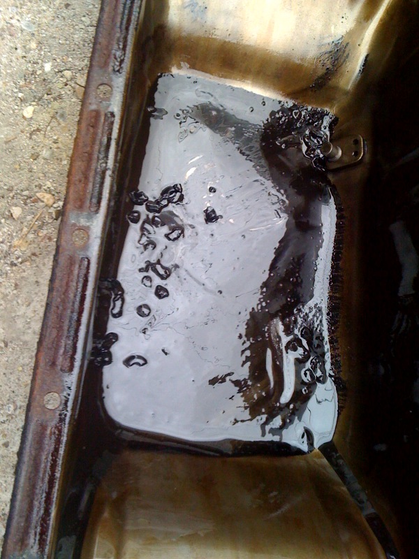

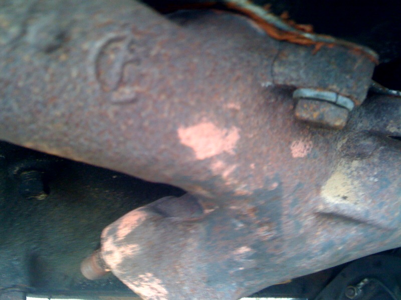

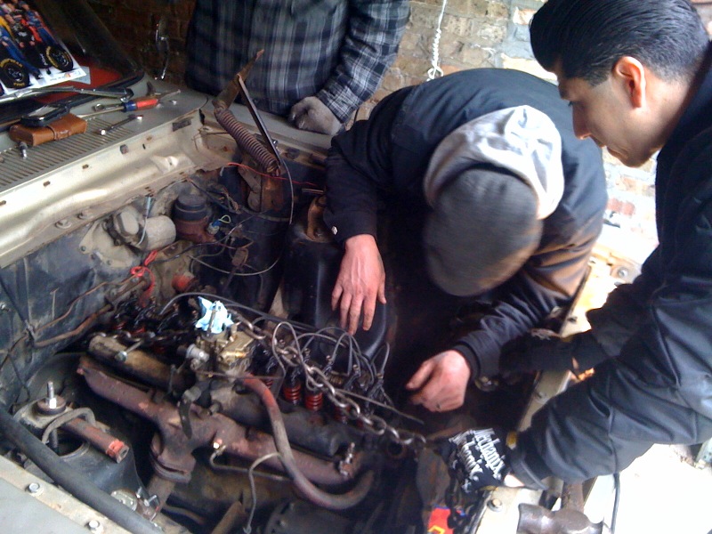

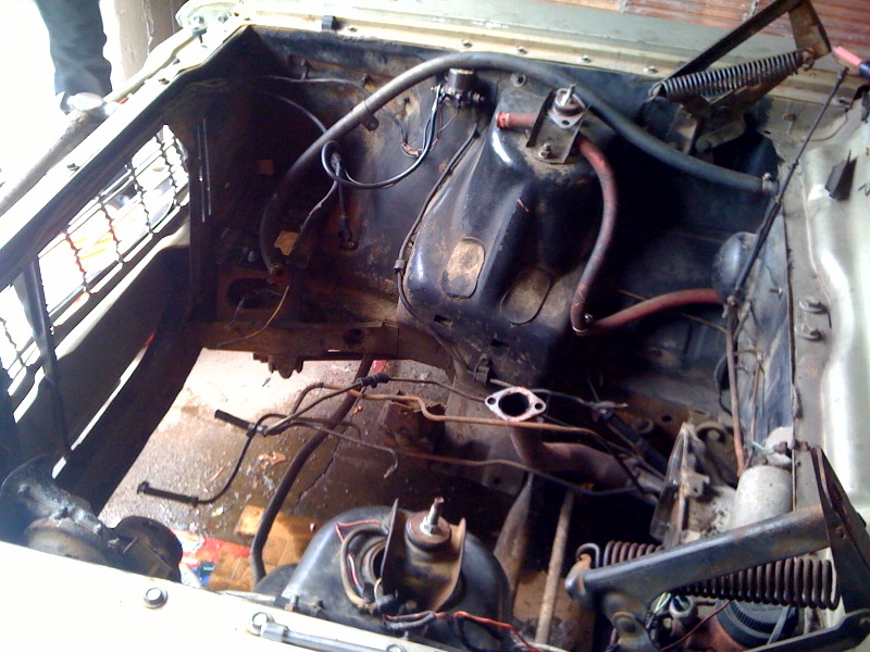

    Motor has been pulled. Man it looked like crap! Chunks of rubber and metal in the pan. Cracked manifold. Missing or mismatched bolts. Cracked cylinder head. Take a look at the tiny space in which I have to work. Thank God for my friend Hot Rod Al. He's letting me rebuild the new motor and trans over in his shop. I kept my pulley and oil pan. Replacing the generator with an alternator, but took the old bracket. This should be good. Good bye 170 and Ford-o-matic, hello 200 and C4!!!!!
  22. Blades
    Joined: May 25, 2006
    Posts: 1,188
    Blades
    from Chicago
    Loose bolts and cracked manifold. It's a wonder this car even ran. :eek:\\
    One thing more.. Today I feel good and accomplished! Something I haven't felt in a long long time.

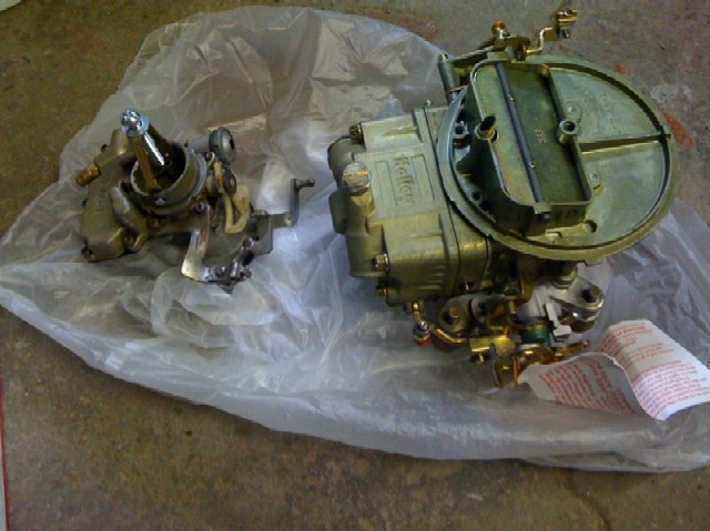

    Today I got my new carb. No I wont be updating everytime I get a new part. I thought this was worth it. I wont get mad if you laugh... I did.:D
    Of course the one on the right is the new one

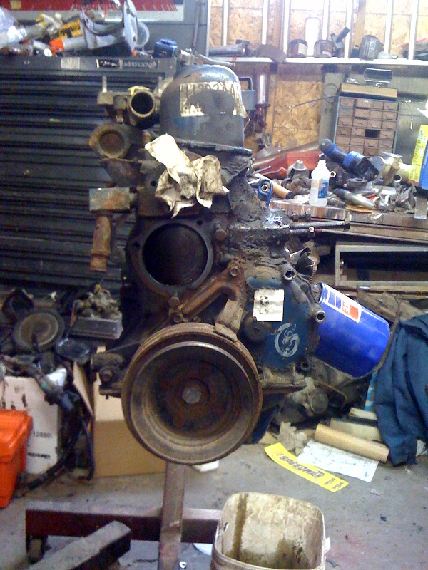

    04-09-2011
    Started the teardown on my 200 today. Realized when I got home that I won't be converting from points, but for a good reason... $$$$
    There was a Home Loan approval letter waiting for me when I got there. I'm a few bucks away from the required down so, I'll make due with what I got....
    New timing chain, water pump, oil pump, valve cover, carb, alternator, gaskets, hoses, fuel lines, floor shifter, filters, plugs, wires and C4 rebuild kit. That ought to do it. notice the mess of stuff that came off. :D
