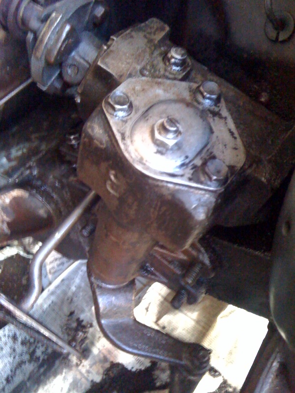

    Today I almost got killed, but I did manage to disconnect the ****** fromm the car and cleaned the hell out of the steering box. that pile under it is not dirt, it's 49 years of built up crud.

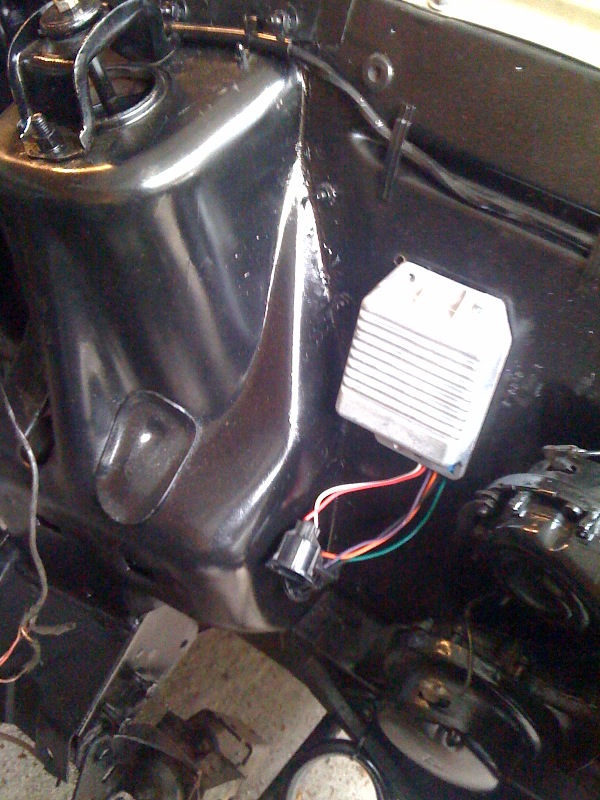

    One last thing - how about a wiring diagram for the Duraspark unit? I stole this either from here or Fordsix.com. You just have to clip and reroute one wire in your stock harness... Dead simple! Just did Judy's today.

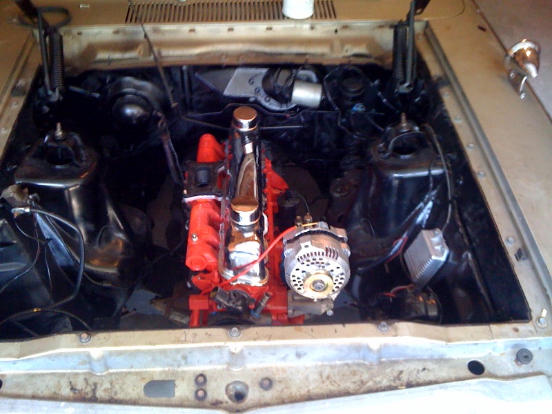

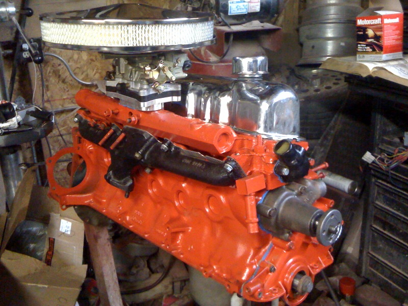

    Busy busy day. Got a ton of stuff done. Changed all the bearings, painted the block, oil pan, and exhaust manifold. Gave the engine well a new lease on life after a good degreasing and 2 coats of fresh paint. Took my c4 to the car wash and power washed the hell out of it. I'm using the old oil pan out off that 1963 170. It fit good. Also using the exhaust manifold from that same 170. Only bad thing is that I lost the bolts, can't find them anywhere. I put all the bolts in sanwich bags and labeled them, but still managed to lose those exhaust manifold bolts. WTF? Well look at the pics. I'm shooting for 2 weeks till I have a running car.

    I decided to break with tradition a little and leave the old blue behind and go with red

    Red is where it's at!

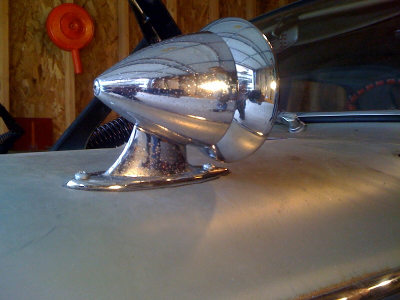

    Todays progress is kind of okay. I s****ed that hood of all that insulation junk. Seemed like a fire waiting to happen if you ask me. I also put that *****in Mustang mirror on and I placed the module in the right inner fender. I figured that was a good place to get it close to the distributor.

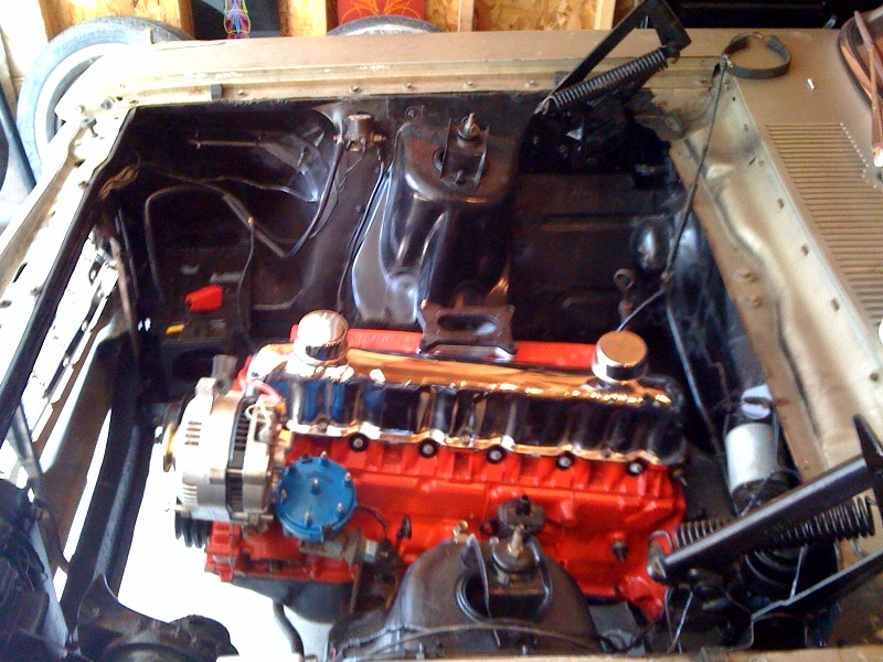

    So today I got a little more work done. Not much (my hands hurt), carb, exhaust manifold, oil filter, plugs, fan. Wasn't really feeling it today. Last 3 weeks have been long and today was 1st day to sit. Another thing learned on this build... gotta take breaks, can't work 12 hours then go home and spend three more in the garage.

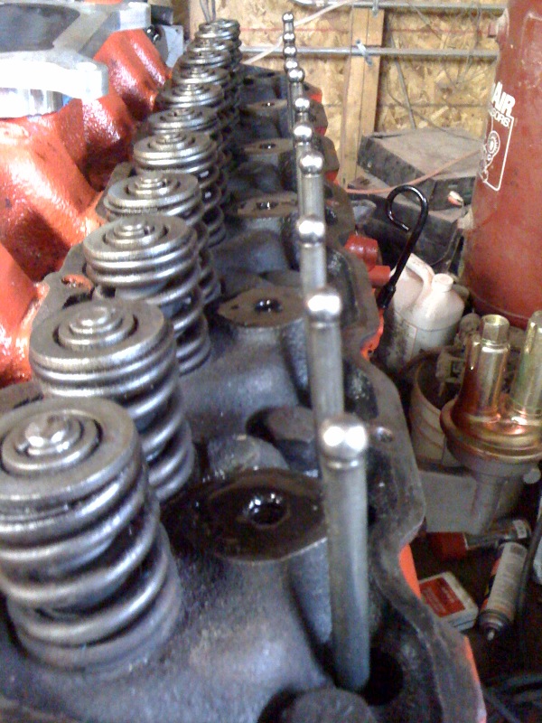

    Installed new valve stem seals and new push rods. The old seals were like bake-a-lite. So hard, I had to squeeze and crack them off. motor is 99% done. Just have to cut oil pick up down about an inch because I used the old oil pan of the '63 170 and the pick up tube in the '81 was different, as well as the shapes of the oil pans. Ignition coil is on, pulleys are on, alternator is on, everything torqued. Just have to finish up that tube and install oil pan and belt, After that.... done rebuilding

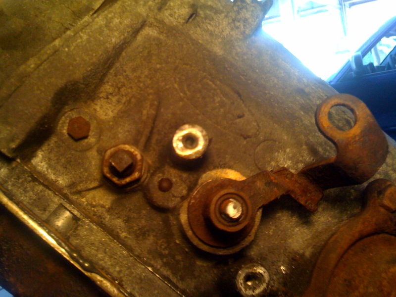

    Whoa! What a ride this has been (so to speak). I tried to drop my motor and ****** in last week and I ended up breaking the down shift detente lever which in turn pushed that screw in and broke some stuff inside. Located the parts on Friday and it was fixed. Here we go, 2nd attempt today. YAY! It's in. Driveshaft was perfect even though I ended up using the yoke that came with my c4. Car sits with out a drivesheft rite now. I was too tired to look for new U-Joints. I now need to situate carb, trans lines, fuel lines, drive shaft, radiator, hoses, carb linkage, figure out the extra pigtail off the ignition modulator, and 1 or 2 or 3 minor things. I figure another 4 to 6 hours and I can fire my baby up. First picture is of broken detente. My new yoke has a balancer on it. IS this ok?

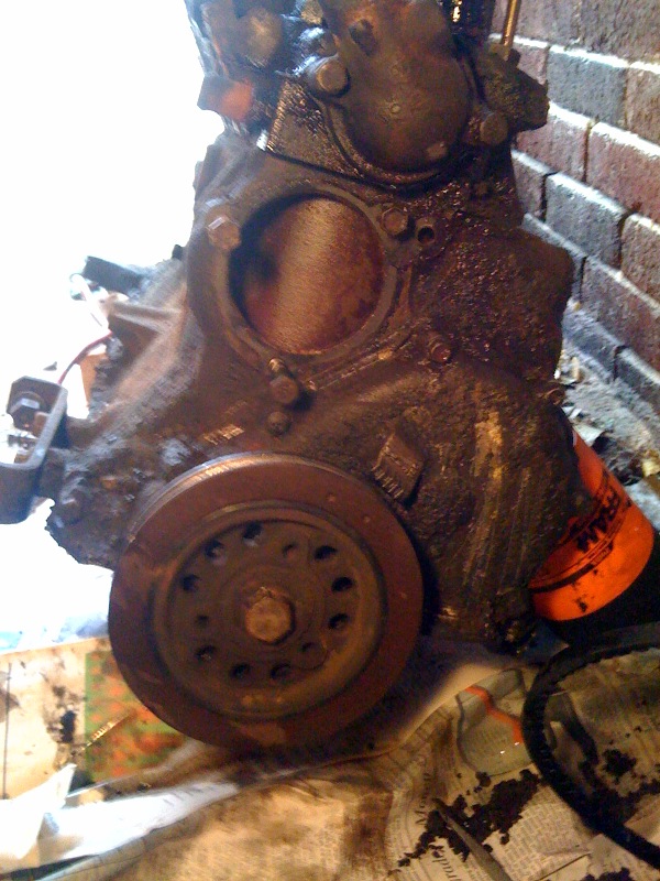

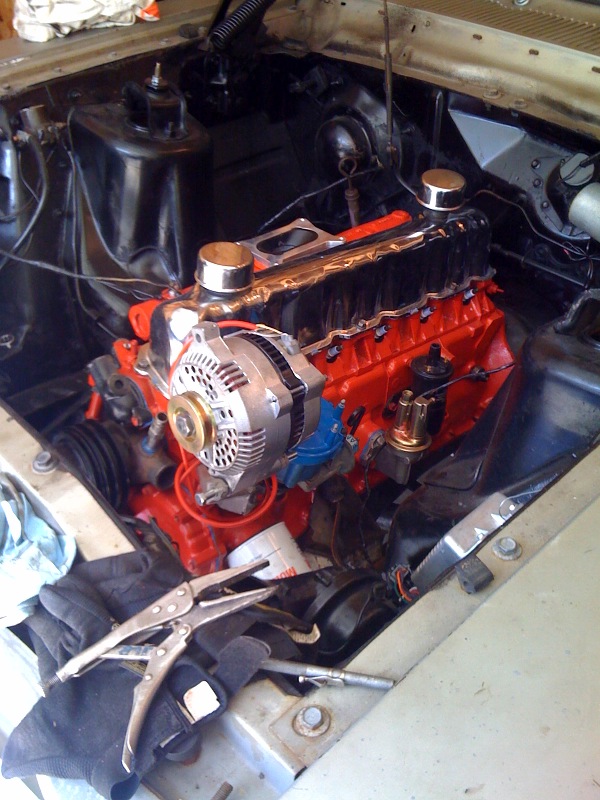

    My fan from the '63 motor is hitting the balancer from the '81 motor. I s****ped the old one this morning, like a dumb ***!!!!! I had a feeling to take it off, but didn't have an extractor. I think I have to stick with that fan because of radiator clearance. Uggggh, small set back... still a pain in the rump!
    1st pic is the old one, 2nd and 3rd are the new.

    The 200 has the balancer and pulley on it.
    These engine profiles really look similar, was the balancer from his old 170 interchangable with the 200, the forward profile of the old 170 sure looked great for clearance.

    AAAHHH young gr***hopper... Now you learn why nothing gets s****ped while you are still working! it looks like the pulley might unbolt from the front of the balancer on the late motor, but does it still have a groove? Otherwise, I would talk to falconparts.com for a new one.
