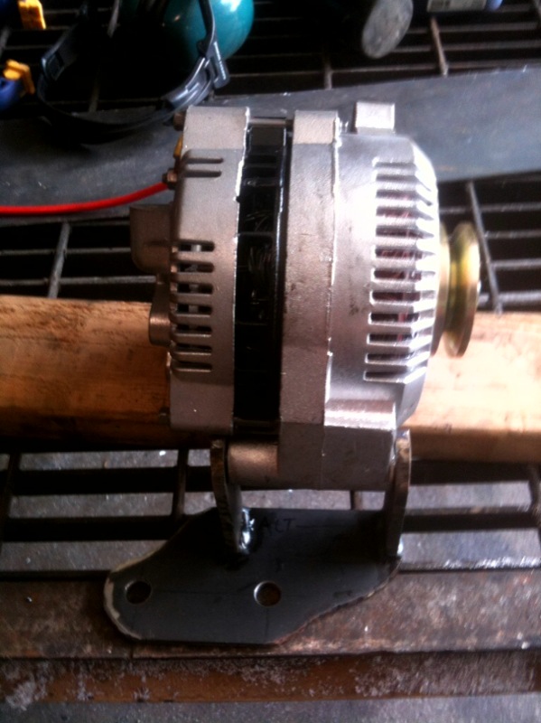

    I solved the alternator problem, yes it was on the wrong side. I feel like a douche. Well actually my friend Tim solved it with his metal working magic. He measued some stuff out and took my alternator back to his shop and made me this *****in bottom bracket, I then went over to the local parts store and bought a chrome universal top bracket. The end is almost here. I can feel it

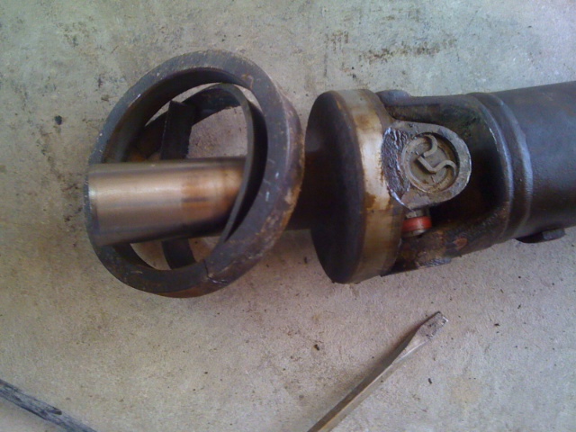

    Well as you may know from my other threads, the yoke problem has been solved by a hammer. I simply removed the damned balancer with a buncha whacks. But I noticed that my sway bar links were shot. The bushings were bad. Looked in my Fairlane catalogues and decided to try Autozone. SCORE! In stock. $6.49 each with all the hardware. I'll be changing those so I can I put my oilpan back on. My distributor wont sit right so I took off the oilpan to see whats up with oil pump. Luckily I have a new extra one and GMC Bubba sent me both size shafts when he rebuilt my distributor. Hopefully this weekend it will all be done. Check out the pics of the swaybar links.
    Not much left to do but the pedal, trans lines, distributor connect, 1 fuel line, and fluids.

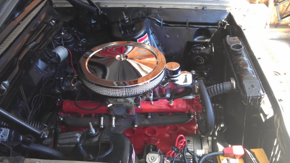

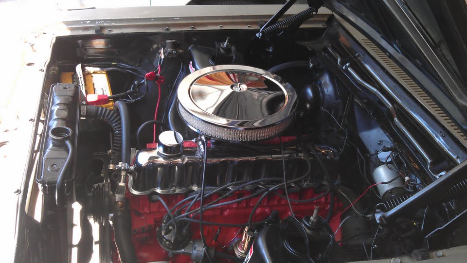

    09/14/2011
    Okay guys the motor is finally done. Running and purring like a happy kitten. I know I kinda left this thread hanging, but I was so busy trying to get it right.
    At last I minute had to change out the Mustang 1wire 150amp as it was just too much for the car. It was screaming and causing a draw. Ended up using a Chevy 60amp. The Holley 2bbl turned out fine and is finely tuned using all the specs I got from Bubbas Speed shop when he rebuilt my distributor. I started out with the Duraspark II, but ended up having that rebuilt and converted to points with the specs for a 67 model year. The Duraspark and the module involved too much splicing and I'm not one for cutting wires. Francisco Plombero helped me install the Lokar linkage and the 73 Maverick accelerator pedal that I got from NeedLouvers. So now the bellcrank stuff is gone. The shift linkage all had to be modified (look at pics), basically cut the original rod and elongated it and had to make a new detent as the one from the 78 C4 wasn't being accepted by the linkage or the trans tunnel. The 200/c4 combo was perfect for the driveshaft and the driveshaft didn't need to be modified at all. I did have to use the yoke that came with the c4 because the one from the Ford-O-Matic simply didn't fit in the C4. The one I recieved had this stupid balancer looking thing on it and I simply knocked it off with a hammer so that the yoke would be able to fit in the tunnel. I used my original oil pan because of my swaybar, had to modify the bend on the oil pick up. I saved all the packages for the stuff I used so that I can buy them again as needed, things such as the belt, dist cap and rotor, wires, etc.... Since it was kind of a far fetched build, I used a lot of stuff from different years. If your doing something similar and need part numbers that worked for me, PM me and I'll be glad to help out. BTW... I installed gauges under my dash so that I ended not using stock oil pressure and temp switches.. proved to be a blessing because my drain**** took a **** on the 2nd day I had the car out and if it hadn't been for the gauge, I would have never known that the temp had hit 250+. I was able to pull over and save myself from a cracked block. INSTALL GUAGES!!
    Thanks for following this thread, and thanks to all the dudes that offered up advice and parts. Big *** thanks to Francisco Plombero for coming over to help lead a blind man out of the darkness.

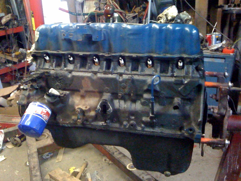

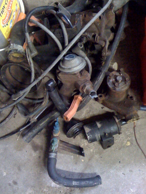

    I forgot.. heres what it looked like in April
    Last three are of the new motor as I worjed on it. Notice the pile f modern stuff that was pulled of it never to be used again. Kinda like backdating my motor :D
