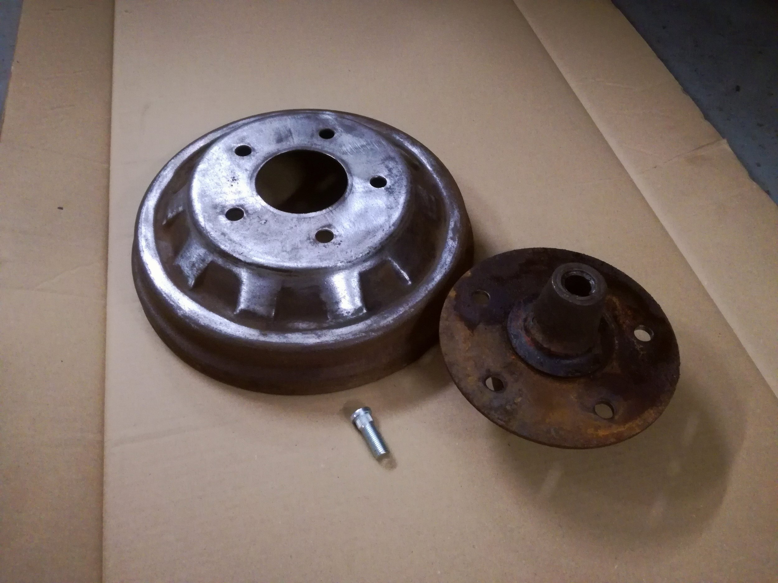

    The looks very much like 48' and up slip on F1 drums.

    Looks like a 40 Ford drum. Won’t fit up to 48 like the seller mistakenly said. I’ve got no idea about the quality though.
    italianhotrodder likes this.
  4. How come so much patina on a new reproduction drum? If correct it should fit post war with the correct hub, Ford sold them as an ***embly for 40-48.

  5. V8-m
    Joined: Jun 11, 2020
    Posts: 277
    V8-m
    from Alaska
    What's the difference? I'm not spe******t.
    Here is my 48 drum. Looks the same?

    It's probably old reproduction part, that's why patina is present. Never seen those drums as reproduction part.

    At the bottom of ad it says "old-stock reproduction", perhaps he means old-stock dealer replacement.

    The guy that wrote that ad is a bit goofy. He calls his drum "one piece", not so, they are cast iron lined steel, and he says the new reproductions are two piece when they are all cast iron one piece that I've seen. It looks like a stock 40 drum to me.

    Yours is also a 40. The drum mounts on the outside of the hub. If it was gonna mount to the inside of the hub it couldn’t have the lip at the center hole.

    i did a different google search and found out they are old KH reproduction now would like to understand if someone have the old Kelsey Hayes part book to understand for which model are made

    Two piece drum. 21A part number says '42, fits '40-'42. Looks correct.

    That drum would be a replacement for use where the hub is mounted inside the hub.
    Probably a good part if it is a KH replacement drum; likely made in the days before off-shore production.
    Originally '40-'42 like mentioned; but after all these years these parts can be mixed up and you have to see what you have.
    I've found outside flange hubs on earlier cars as well as inside mount hubs on '46-'48 cars.
    Ford only sold hub/drum ***emblies so if you go with replacement drums you will have to deal with properly removing the swedged studs and either getting new studs and having them swedged on ***embly or converting to pressed in serrated studs and letting the drums slip on.

    All I know is that for that price you may as well pick up the boiling bros slip on Lincoln drums, and convert your hubs to slip on configuration with press in studs
