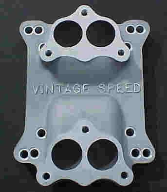

    You can buy four barrel intakes for these engines that accept standard, square-flange Holley carbs. You could then use a dual Stromberg/Holley 94 adapter to run two vintage two barrels on the 4v intake if you want to do so without running Webers or making your own intake.

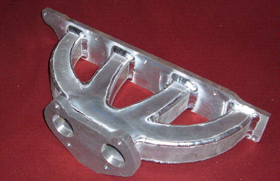

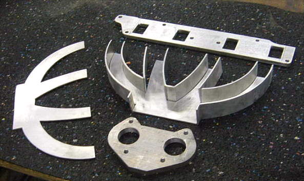

  7. mac miller
    Joined: Jan 13, 2007
    Posts: 524
    mac miller
    from INDY
  8. Yeah.....what Mac said. Nobody makes an intake to mount a Weber side-draft on a Pontiac Iron Duke so I built this.
    Yours would be even simpler.

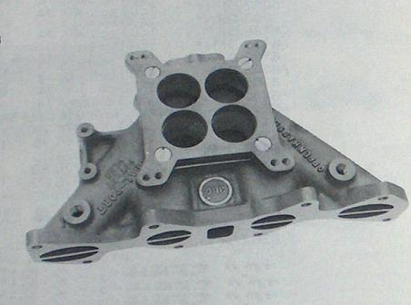

  9. brpowel4
    Joined: Jul 31, 2006
    Posts: 107
    brpowel4
    Hopefully, the intake picture attached. But this is the intake i was referring to. I'm sure these are hard to find.
    Anything that resemples this setup would be what i'm looking for. Would something like this be hard to make?
    Thanks for all the input so far!

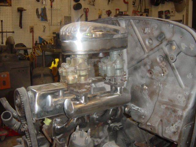

  12. That is a picture I posted. I bought the manifold off ebay. It's for a 2.0. I don't know if it was made for a 2.3

    i bought the 2.3 engine and 2 identical completely redone Holley 94's. what i am planning on doing is using the stock efi intake and "knife edge" the ports for better flow. i'm going to use a 1" aluminum Flat open plate to make an adapter to fit a Vintage Speed 2x2 to 4v adapter to. the Holleys will be on top of course. any flaws in this setup?
    i'm looking at the progressive linkage setup. In the new Holley 94's, the primary has a 7.5 power valve while the secondary has a 3.5. would i need matching power valves or does this already suit a progressive setup?
