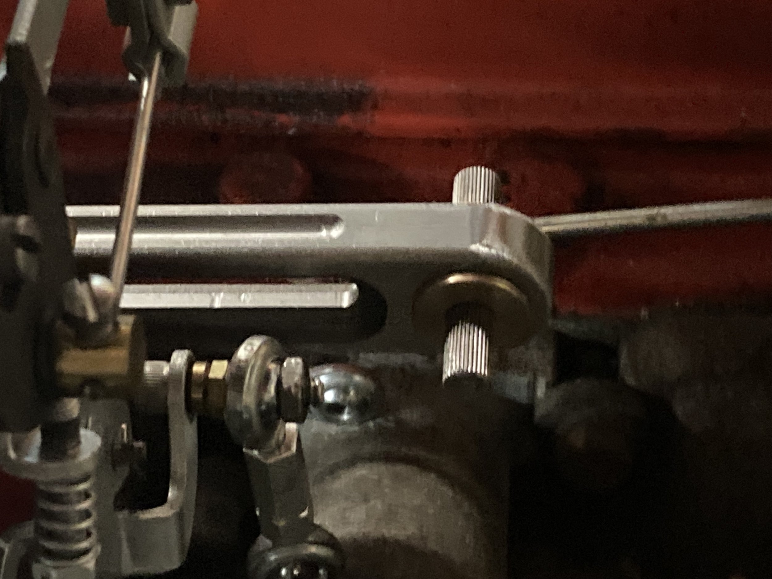

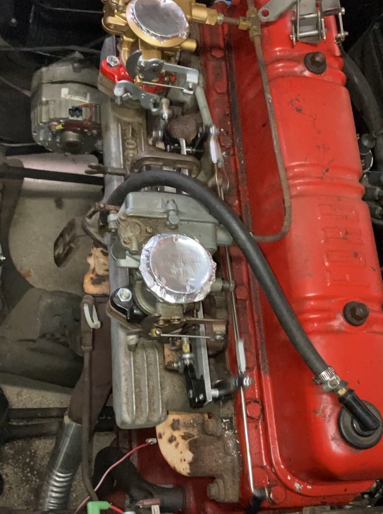

  12. Adriatic Machine
    Joined: Jan 26, 2008
    Posts: 1,026
    Adriatic Machine
    Bump!
    The linkage rod that comes with the Offy dual intake is bare bones and it hits the choke brackets at about 3/4 open throttle. I got it to work but I was never pleased with how it functioned, plus it wasn’t exactly adjustable.
    These throttle shafts are situated 90 degrees from typical orientation and they get rotated back / away from the engine, adding to the complexity.
    Does anyone have any pictures or experience with piecing together carburetor linkage for a 223 with dual Holley 1904 carbs? I know the Fenton has built in pieces but I’m running the Offy.
  13. Adriatic Machine
    Posts: 1,026
    Adriatic Machine
    I figured it out and I’m really happy with it. However I got a nice package from McMaster Carr with all SS fittings so I’ll be duplicating this with industrial grade stuff.
