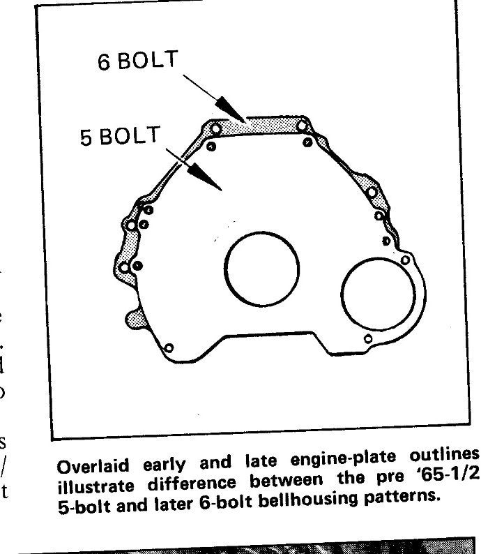

  2. squirrel
    Joined: Sep 23, 2004
    Posts: 60,365
    squirrel
    I've never heard of a 5 bolt flexplate, but the bellhousing bolt patter on the 260 and early 289 is 5 bolt, they changed to 6 bolt some time in 1965. Perhaps he meant that you need a flexplate for a 5 bolt bellhousing.
    Vibration might be related to the flexplate, or maybe not. The lurching...probably not related to the flexplate. We'd have to have a better description of the symptoms, maybe?
    dana barlow and captaintaytay like this.
  3. captaintaytay
    Joined: May 24, 2011
    Posts: 1,225
    captaintaytay
    I'm sorry I meant to say bellhousing. I will edit it.

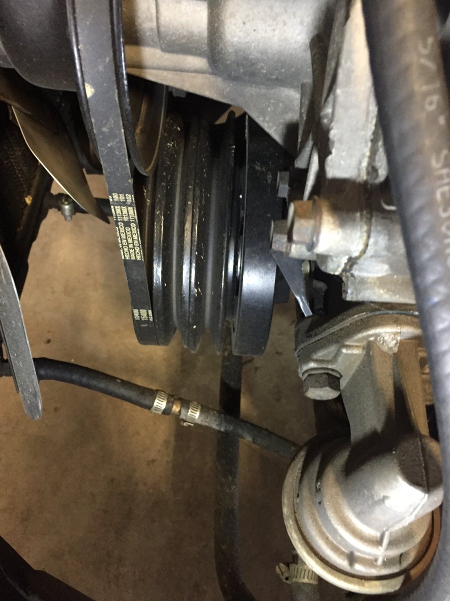

  22. Marty Strode
    Joined: Apr 28, 2011
    Posts: 9,786
    Marty Strode
    captaintaytay likes this.

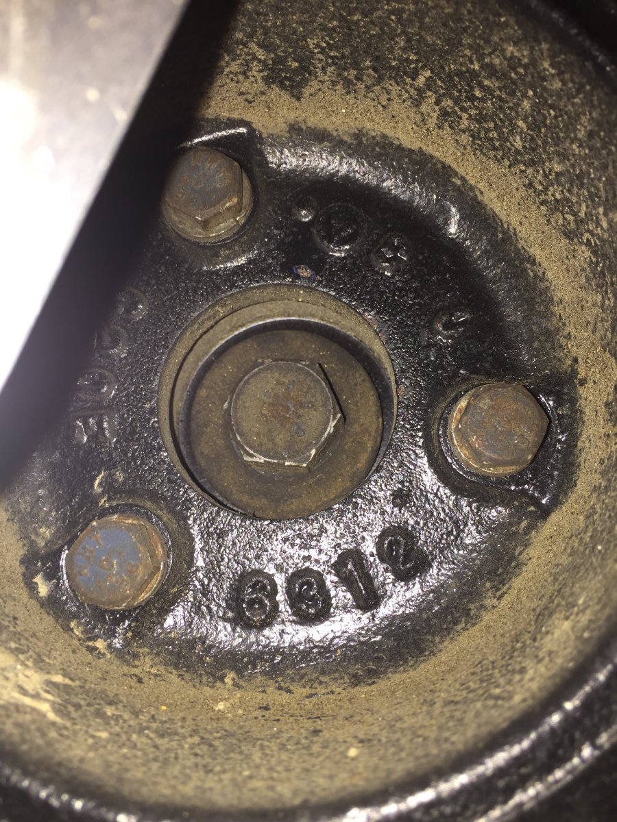

  23. warhorseracing
    Joined: Dec 26, 2006
    Posts: 2,865
    warhorseracing
    from cameron wv
    They are very different, you just have to know which one you are looking at. If it only has three bolts that secure the lower pulley to it then it is correct for the 260 or early 289, 28 Oz. Google will be your friend to determine which one it is there if four bolts secure the pulley to the balancer, 28 VS 50 Oz. But if there are four bolts instead of the three it is not a 260 or early 289.

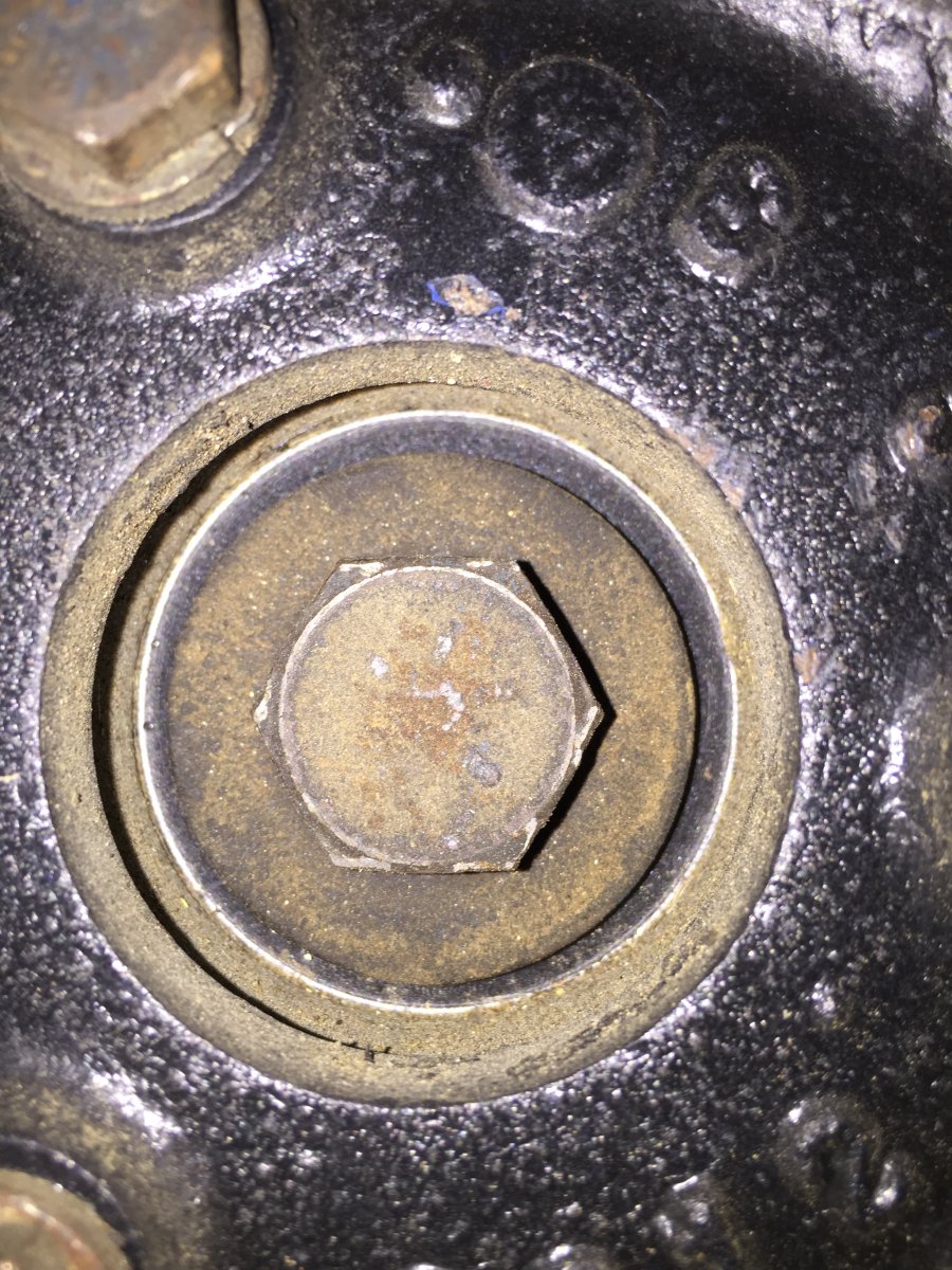

  24. captaintaytay
    Posts: 1,225
    captaintaytay
    Here is some pics, looks right to me.

  26. greybeard360
    Joined: Feb 28, 2008
    Posts: 2,098
    greybeard360
    C20E 6312 casting number on pulley is correct for 62.
    A vibration at that low of rpm and lurching in gear sounds like a cylinder with a misfire or a dead cylinder.
    I would do as suggested and pull the plug wires at the distributor cap one at a time to isolate a dead or weak cylinder. Check the plug and wire on that cylinder, maybe do a compression test if those look ok.
  27. MAD MIKE
    Joined: Aug 1, 2009
    Posts: 996
    MAD MIKE
    from 94577
    Looks like camera angle to me. you can see the flats on the lower side of the damper bolt head. That would indicate a shot looking up. Thus bolt would appear to be 'down' in the hole.
    I would check flexplate design, 28oz usually has a few holes around the perimeter for bolts, but the 50oz will have large slots cut into the disc. Counter weights are similar in size so it is hard to tell that when under the car unless you have clear access.
    Worst case, someone retrofitted a 50oz crank into an early block, but that would take some work due to the differences in rear main seal.
    As for the surging, even if there is something wrong with the engine, it should not be so great that it overcomes the brakes. Might want to verify no leaky/blown wheel cylinders. Unless the Ranchero is still sporting 4 lug wheels, then you will want to look into fixing the brakes first.

  29. warhorseracing
    Posts: 2,865
    warhorseracing
    from cameron wv
    It is the correct balancer and pulley but I think you hit it on the head. It does not appear to be the camera angle as it is too great of a difference. Captaintaytay, can you get a picture more square on to the center as it appears it could way off. Did you install the new balancer or have you had this pulley off? Possible someone drilled a newer 4 hole balancer and got the new three holes off. That would cause an intermittent vibration. 011 marked.jpg
  30. captaintaytay
    Posts: 1,225
    captaintaytay
    I must have taken 50 pics. It's like a monkey inter-coursing a football!
    Horrible angle, fricken fan in the way!
    I'll put up a few shots. I just couldn't get a clean shot. And yes Mad Mike taken from underneath.
    Then I got too close to the magnets on my work light and set off my pace maker.
    Scared the **** outta me, didn't know where the beep was coming from.:eek::oops:
    I also pulled plug wires and got spark from all 8 cylinders.
