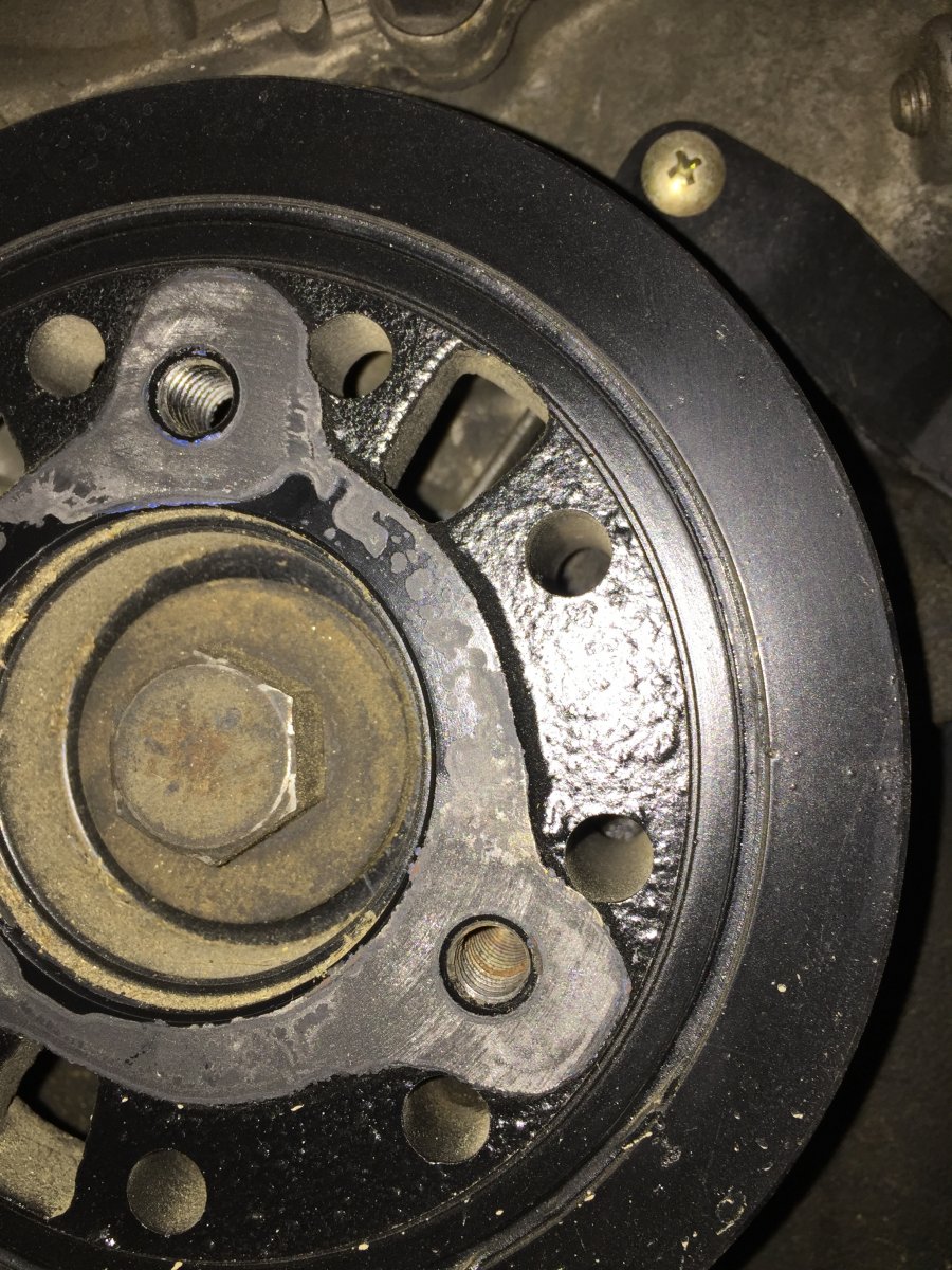

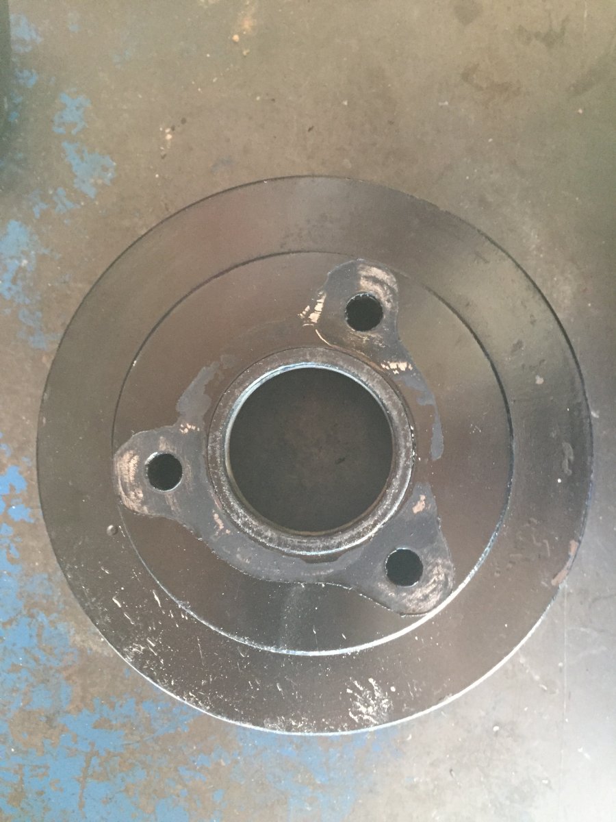

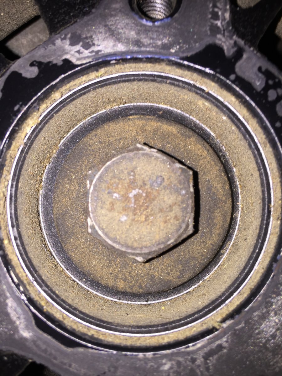

    Something does not look correct in the first and second picture. Could be shadow but this may be the issue. This weekend can you put a dial indicator on it and check the run out? ENOUGH for today. Get your pacemaker settled down.

    It does not look like the left side is flush bit the right side is. When running can you see a wobble in the lower pulley?

    If it does indeed wobble when running it is not properly seat due to either rust or paint. Remove the pulley, clean the area and reinstall.

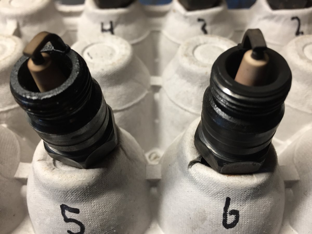

    Did a compression test.
    1- 155 2-155 3-154 4- 154 5- 153 6- 154 7- 153 8- 154
    Installed new plugs, points, condenser, cap and new wires.
    The old plugs looked real good. It had two bad plug wires.
    The vibration is still there, not as bad but still there.

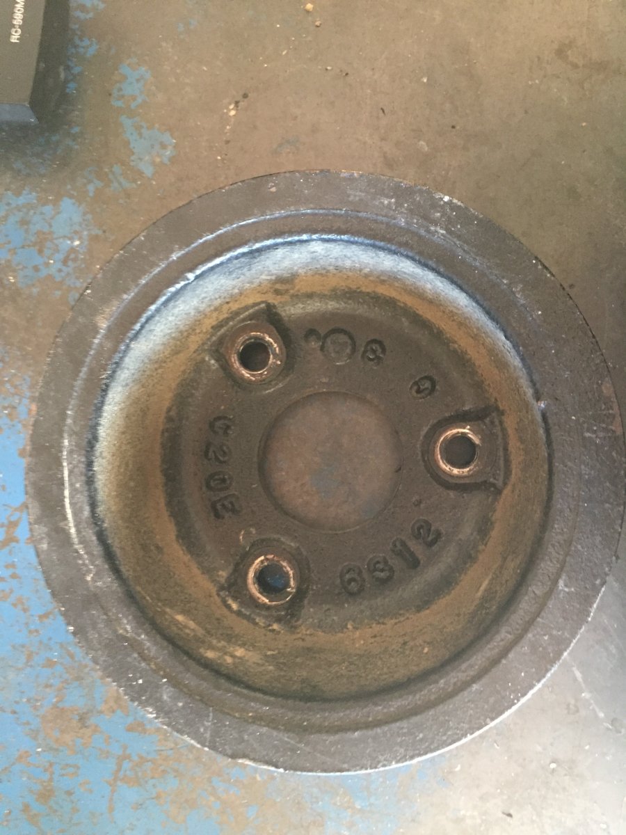

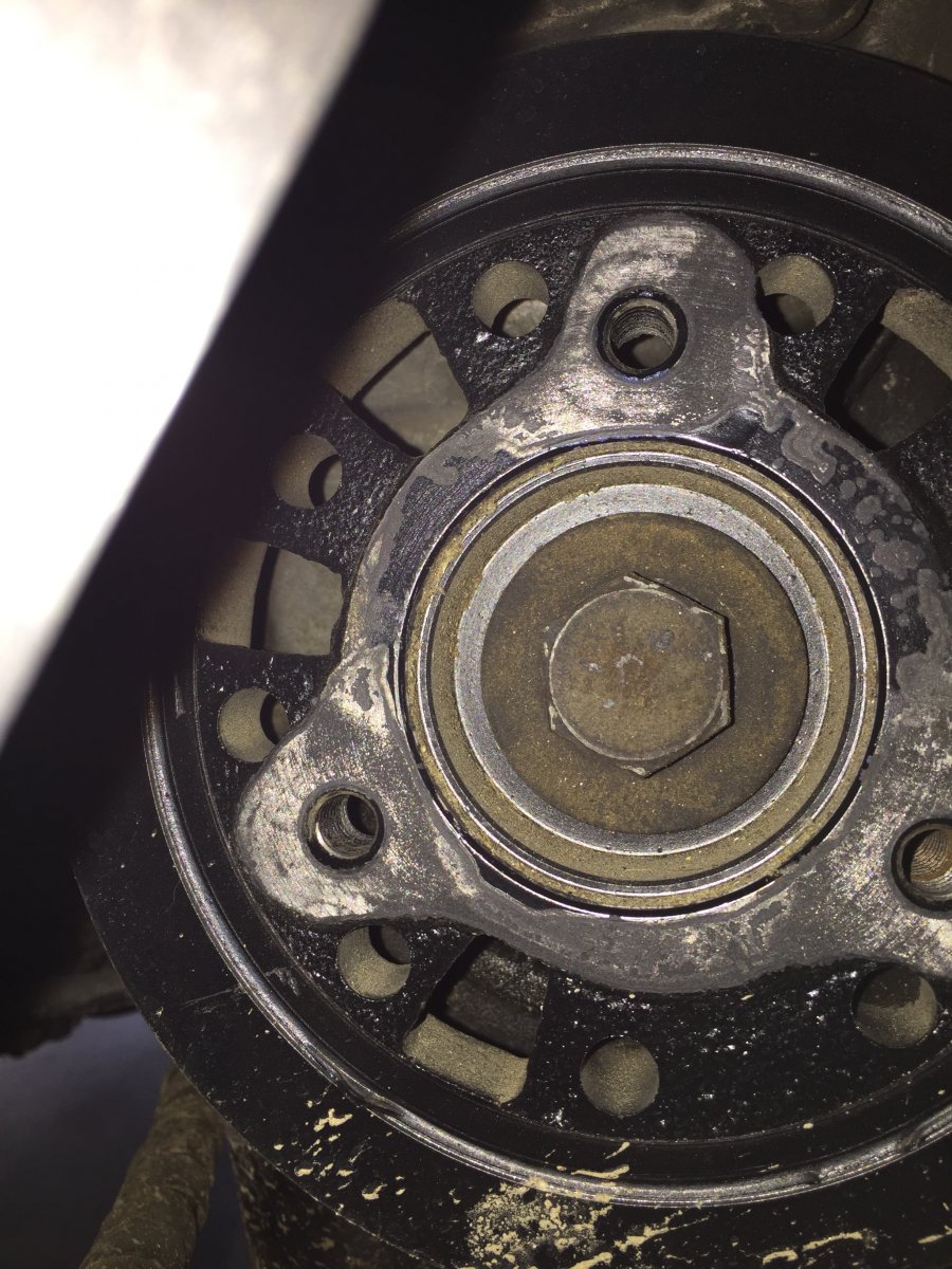

    We pulled off the crank pulley today.
    We ran the car briefly and it still vibrates, actually the whole car shakes not violently, kinda like its in
    slow motion, in some it looks good, in others it doesn't look good. Motor and trans mount look good.

    I had the same vibration in the 283 Chevy in my roadster, same rpm range. Turns out it had a flex plate for a 400 SBC with a nice big weight on one side that it didn’t need.
    Ford small blocks have always been screwy with weight/no weight, 28 oz/50 oz. I’ll bet it has the wrong flexplate / weight, but since someone put this unknown combination together it’s hard to know what it should have. It may take some trial and error.
    How about some photos showing the whole front of the pulley and of the damper too. Any lumps or bumps that may make it sensitive to clocking?
