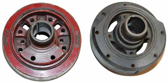

  25. captaintaytay
    Joined: May 24, 2011
    Posts: 1,224
    captaintaytay
    I have complete confidence is this shop, they communicate well.
    Whoever welded the weight on the flex plate was trying to lose weight on it by grinding it. 22_27.jpg
    I remember when checking crank pulley and damper it had the one on the left in pic.
    We will see what happens, hopefully there is no more surprises.
    He ***ured me it will be right when done.
