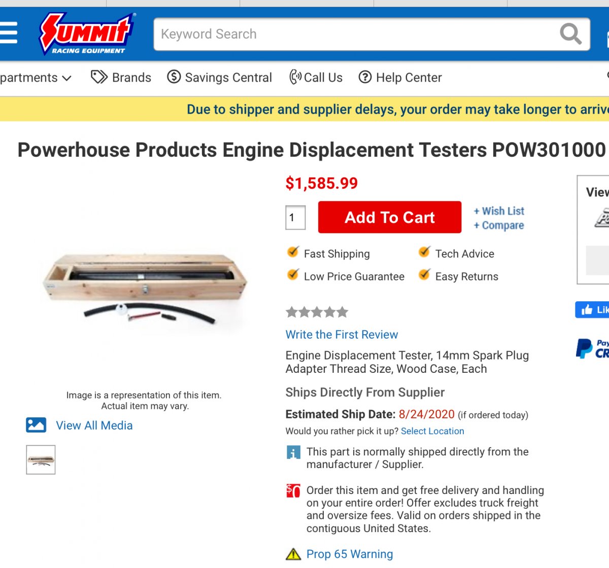

    See if someone has a gauge to Pump one of the cylinders with a cubic inch gauge and you will find out what size motor you have. The gauges are a little pricey so see if some racer has one. A6EF5BE1-E109-4156-84DC-CEBB7397FFA5.jpeg

    It would be alot cheaper to pull the oil pan and check the crank like @Crazy Steve suggested.
    Being I'm lacking history on this ride, I can only speculate as to why all the weird **** was done to this ride. I'm just going to have him finish the re-build and see what happens. What a mess! I'll let you guys know when its out of his shop fixed or not. Thanks for putting up with me.
