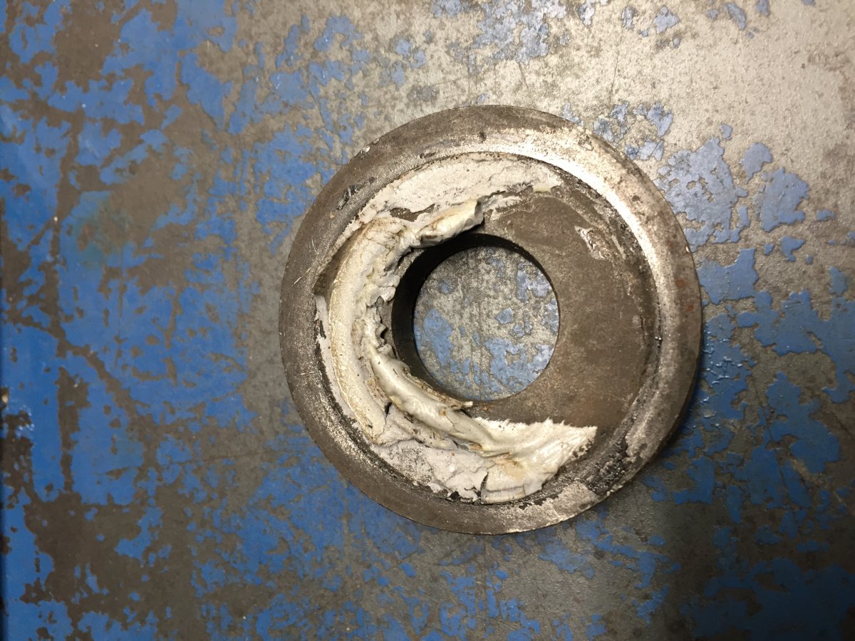

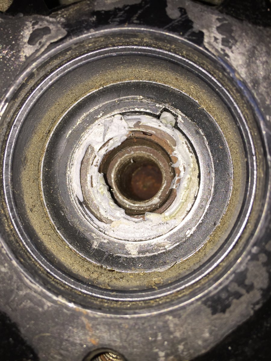

    Maybe the plot thickens, maybe not.
    Removed the crank bolt and wondering why someone used RTV silicon on back side of washer and inside balancer??? maybe the key-way but this **** was all over the place.
  4. Kustom Komet
    Joined: Jun 26, 2007
    Posts: 640
    Kustom Komet
    You're supposed to put a smear in there to prevent an oil leak, especially around the key way. If I recall correctly, a 260 has a different imbalance vs a 289, something like 25 oz vs. 28.2 oz. A 260 harmonic damper may be required.
  5. warhorseracing
    Joined: Dec 26, 2006
    Posts: 2,834
    warhorseracing
    from cameron wv
    Yea Captain taytay, there should be alot less RTV there and as Kustom Komet says, to prevent oil leaking. As far as the imbalance weight being 25 Oz. I am not sure and that will take some research.

  11. F-ONE
    Joined: Mar 27, 2008
    Posts: 3,717
    F-ONE
    from Alabama
    Sometimes the simplest explanations are the best. The extra sealer on the damper behind the washer may simply be to hold that washer on during ***embly. That's not unlike using grease to hold small screws and nuts in place.
    captaintaytay likes this.

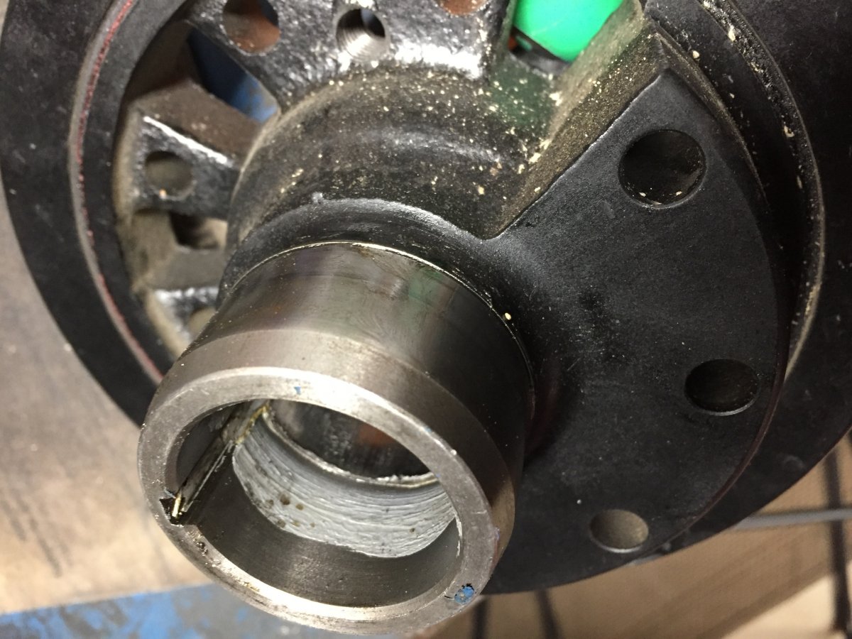

  13. captaintaytay
    Joined: May 24, 2011
    Posts: 1,205
    captaintaytay
    Well gentleman,
    I was putting on the new HB and it just slipped on.:eek:
    I tightened it down and torqued it.
    I just needed to see if the vibration was gone.
    It's a ton better, not completely gone but enough I can live with.
    But I know it's not right, it just fitted to loose for my comfort, it just pushed on.
    The old one needed a puller and came off with no issue.
    Who knows maybe it's a defective HB. I'm going to pull the timing cover because I also
    think the woodruff/keyway is bad. It's pretty hard to get to.
    I'll let you know what happens next.
    Johnboy34 likes this.

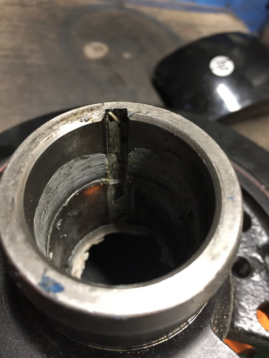

  14. yellow dog
    Joined: Oct 15, 2011
    Posts: 530
    yellow dog
    from san diego
    Make sure that you have an interferrence fit with the crank snout (0.001-0.0015")....its more
    than the just a keyway issue. Maybe this is why somebody tried slopping RTV on the snout.
  15. captaintaytay
    Posts: 1,205
    captaintaytay
    If its not a defective HB, then it looks like the snout is worn. I'm at least going to try a new key-way while I have it apart again.
    If so I'm just going to put it back together and put a ****ter shield around the car.;)
    No really, If the crank snout is junk I'm just going to run it until she blows.
    I'm just not equipped to break down motors.

  25. captaintaytay
    Posts: 1,205
    captaintaytay
    Actually guys I didn't listen well to in school. Instesd of just moving on,
    I was wondering why the old HB came off like it should , with a puller.
    So I pulled the new one and checked the diameter vs the old one.
    Old one 1.3845
    New one 1.4005
    So I went and returned it for a exchange.
    Next one 1.3925
    It took the install tool to put this on but it still went on with no resistance.
    It was a $80.00 HB, you get what you pay for.
    All back together now there is a nice improvement and I'm
    going to go shake it down for a long drive, I'll tell the wifey
    to be ready for a rescue just in case it breaks.:eek:
    Thanks for the info "Beanscoot" Makes me want to tear it down just for my curiosity.
    But I'm just going to drive it now and do another motor when I'm able and can afford it.
    warhorseracing likes this.
