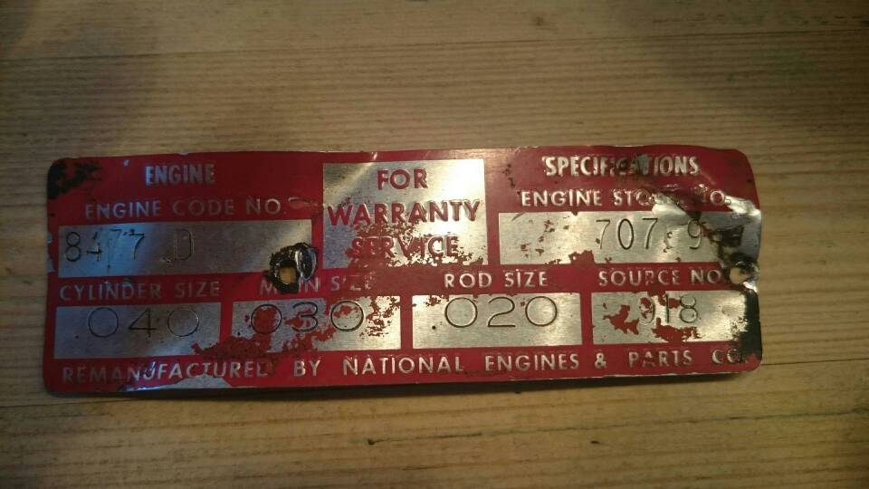

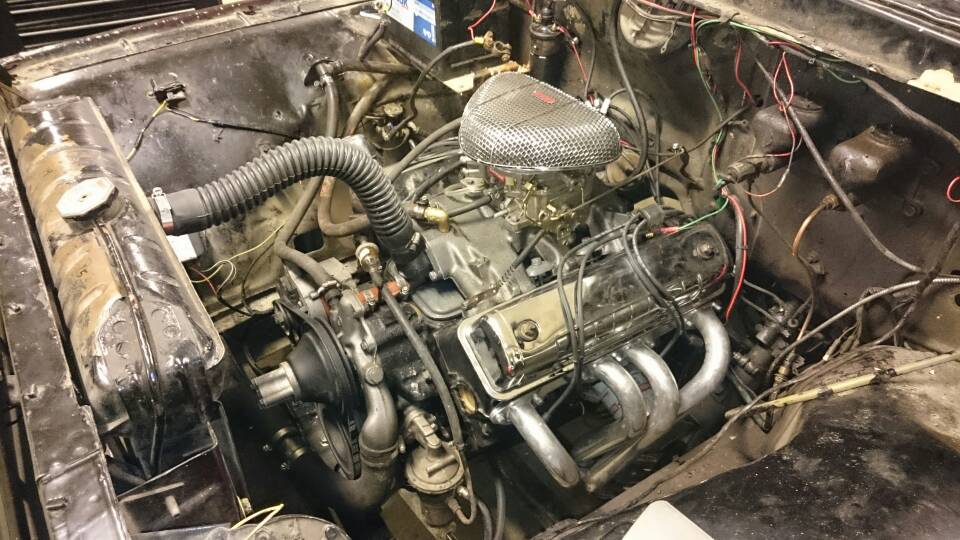

    I recently bought a 292 with a 312 intake and a 4 barrel carb to replace my 223 six...the guy I bought it from told me it was rebuilt and I believe him cause it had a warranty tag on the block...anyways..yesterday I took it out for a test drive, and It runs perfect! But I later took the valve covers off and saw that the heads were covered in dirt...I read before that the oil p***ages in these engines can be clogged..do you think that is the problem here? Tried turning the engine with the starter to check if the oil reached the heads, but it didnt, but I think I will try that again when I get a new oil filter, since the one I got probably is filled with dirt too...any advice on an easy fix?

    Ok, thanks everyone! About the rebuild, I dont know how much was done, cause it was done in the USA, and I bought it from a guy here in Norway, and he never even started the engine..just pulled it out of his 54 f100...so its impossible to tell how long its been sitting..but it looks pretty good...is the oil in the heads suppose to have high pressure? Or just flow out of the holes? Thankful for all the help...

    If you can go by the tag it was a proper overhaul.

    Thank you all so much! I didnt find pb blaster here in Norway, but something similar..ran it, changed the oil and filter..and now the oil is getting thru! But not much, think I will try the grease fitting thing..maybe that will clear the p***ages even more..how much oil is suppose to get to the heads? Sorry for the newbie questions, but im totally new to the Y block..but when some oil is getting to the heads, its a good sign that its not a main bearing problem? Right?
