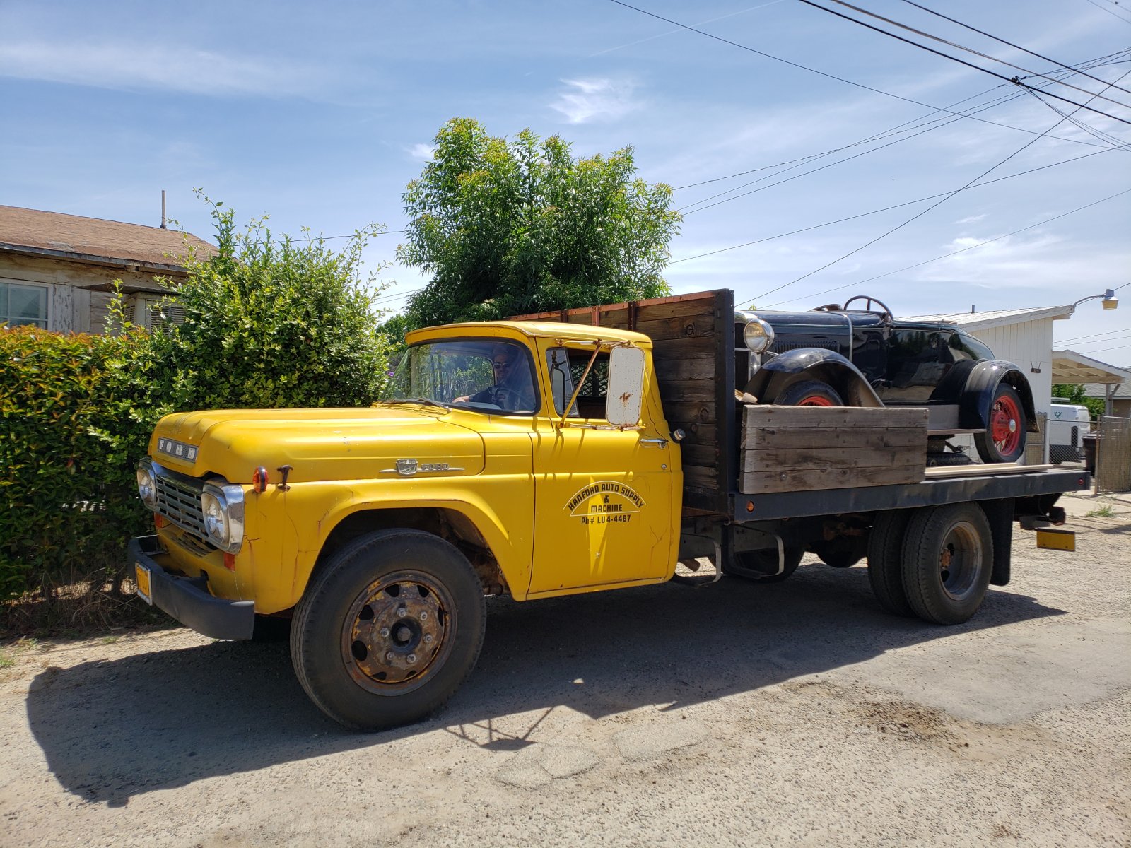

  23. 292? I like them. They make good power and if you know what you are doing and don't mind getting your hands dirty you can build one for not a whole bunch of money.
    They have a nice sound and look better than most engines when dressed properly. I have one in a 1959 F-600 that will pull a big load and I have one in a 1928 Ford roadster that has run 196 mph. They are very versatile.
    Boneyard51, warbird1, CSPIDY and 8 others like this.
