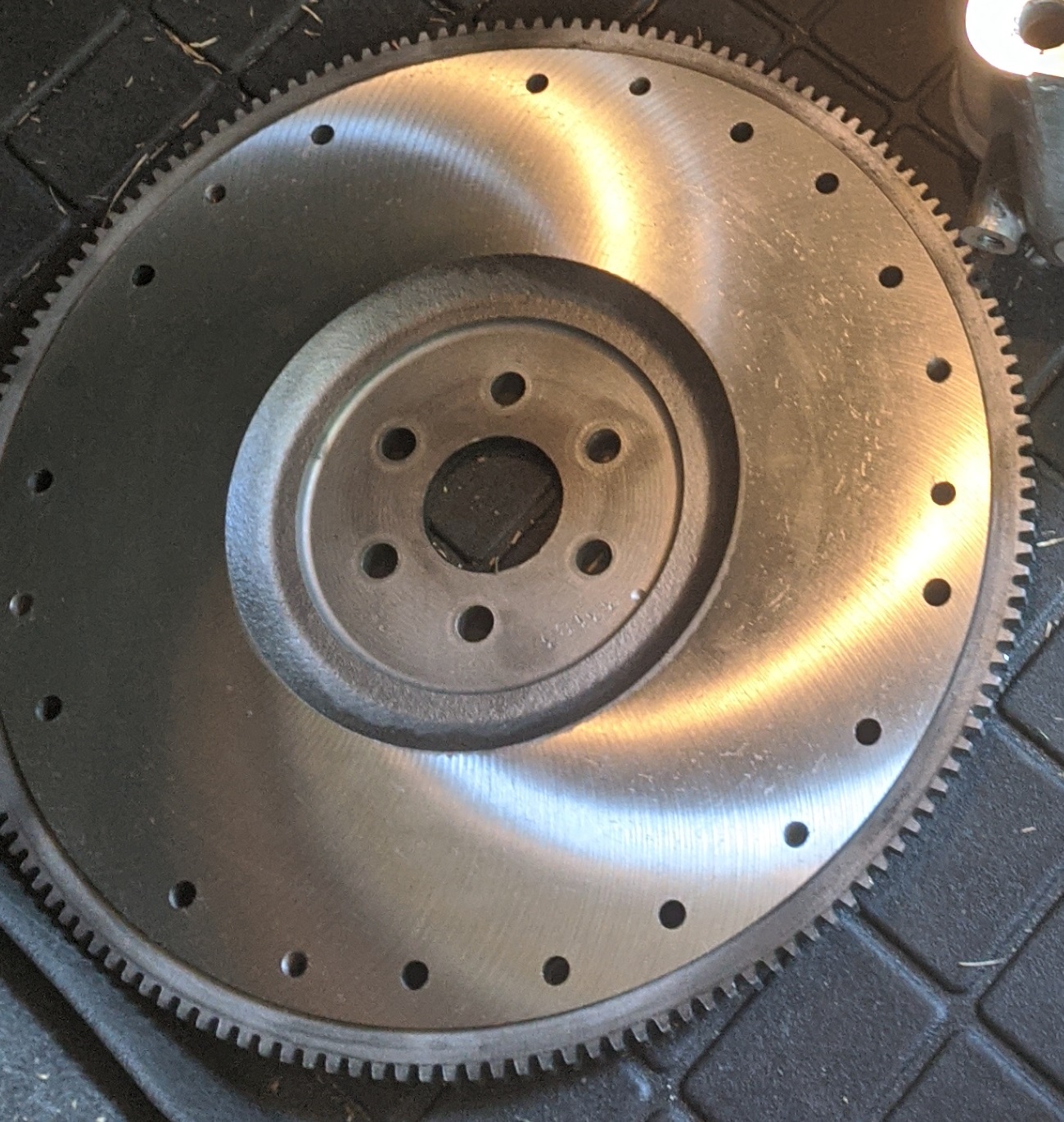

  23. 34 5W Paul
    Joined: Mar 27, 2020
    Posts: 417
    34 5W Paul
    from Fresno CA
    I do love how a freshly reground flywheel looks. Thing of beauty. My local resource seems to have the right equipment. SBF example...

  24. Tealy1964
    Joined: Oct 19, 2022
    Posts: 21
    Tealy1964
    WOOOO! Shiny!
  25. jimmy six
    Joined: Mar 21, 2006
    Posts: 16,912
    jimmy six
    Looks like it’s drilled for more than 1 pressure plate pattern.
  26. Fordors
    Joined: Sep 22, 2016
    Posts: 6,398
    Fordors
    I agree that that ‘wheel is drilled for different sizes and styles of pressure plates but what’s up with the spaces marked with red? It appears that there are three missing holes.
  27. ekimneirbo
    Joined: Apr 29, 2017
    Posts: 5,263
    ekimneirbo
    from Brooks Ky
    Yep.....Thats how a properly resurfaced flywheel will look when it comes off a blanchard grinder. Almost no automotive machine shops have blanchard grinders. They simply lay the flywheel on the table and turn on a magnet to hold it in place. If its an aluminum wheel, they surround it with steel plates to keep it from moving. Then turn the table rotation on, turn the water on, and bring the grinding wheel down slowly. Takes maybe 10 minutes to grind one. Leaves a beautiful finish............and its parallel to the mounting surface.
  28. Fordors
    Posts: 6,398
    Fordors
    I don’t think you want to just place the flywheel on the table, that will never insure that the clutch surface is parallel to the crank mounting surface.
    The crank mounting surface of the ‘wheel must be set on a round spacer or blocks that have been ground parallel, that will ensure the surfaces are true to each other.
