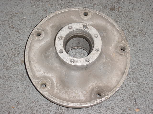

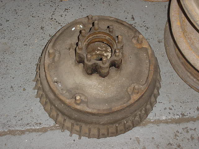

    It is difficult to find drums for the stock rear truck hubs. If you want to replicate a wide 5 bolt pattern similar to the truck hubs you can make up a set by using 60-70's version race car hubs like the one pictured. this will take an original 37-9 Ford passenger car brake drum or a machined Buick brake like the second picture. I have used aluminum hubs but they have 5/8" stock car studs.
