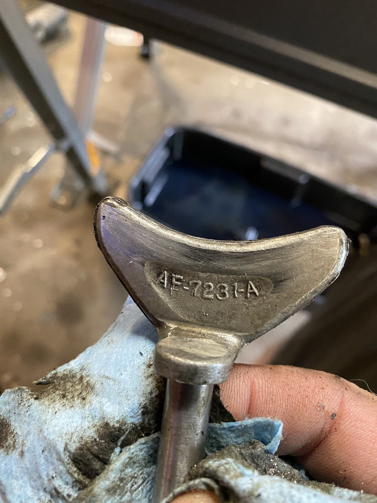

    I reinstalled the cover with the shift forks installed and the only way I can duplicate the exact way the 1/r lever felt is only if I put the shift fork in backwards. And at that point either 1st or revers is hard to get because the shift fork won’t travel far enough to properly engage. But I can make it happen if I try.
    my question for you guys is should I reinstall the trans assuming I fixed it or proceed to do something else. I’m honestly wondering if the shift fork was in backwards and or maybe poorly adjusted some how to keep the gears touching. And maybe kicking out of 2nd is an adjustment thing? The synchros look alright??

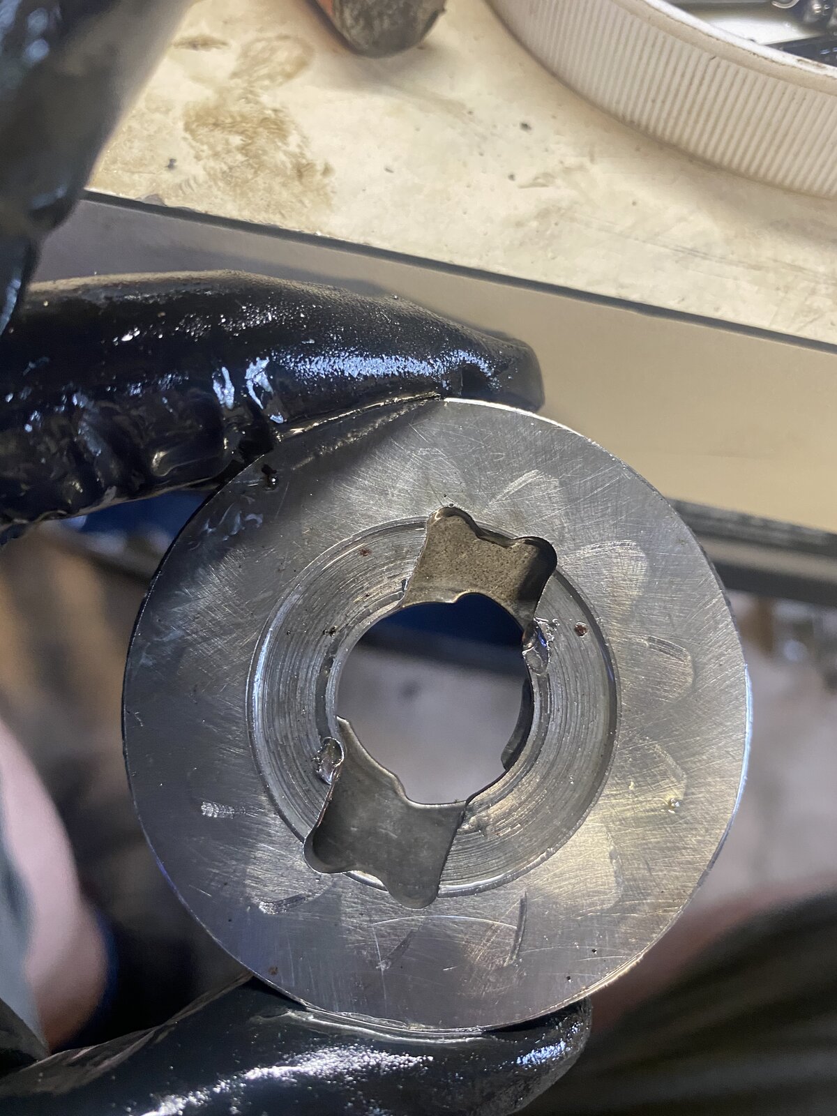

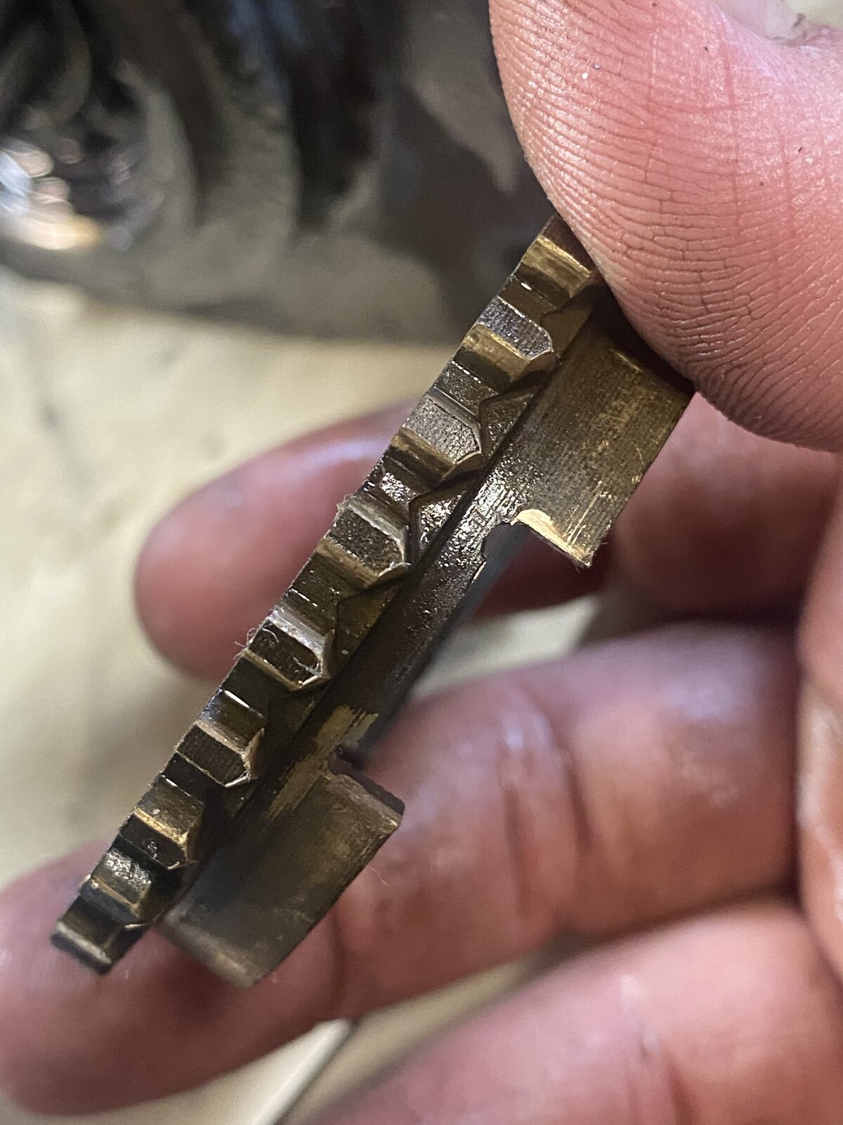

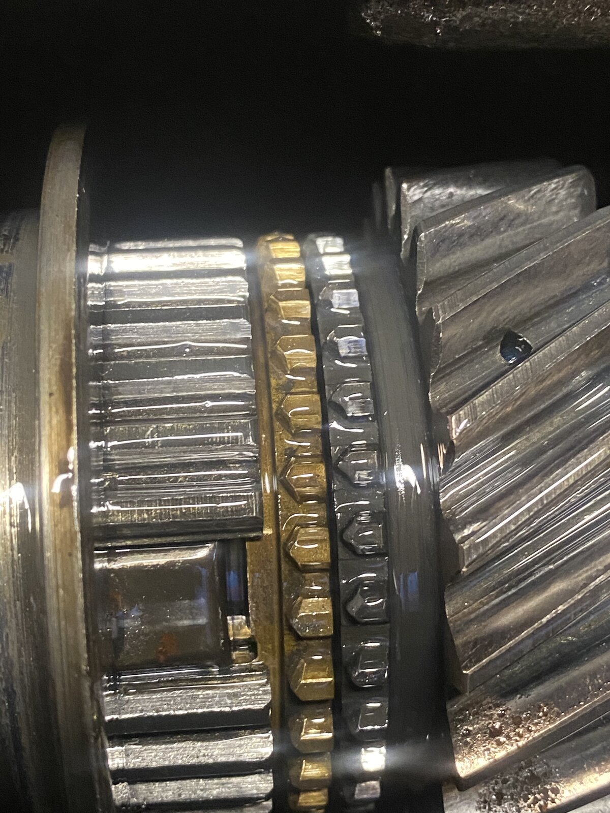

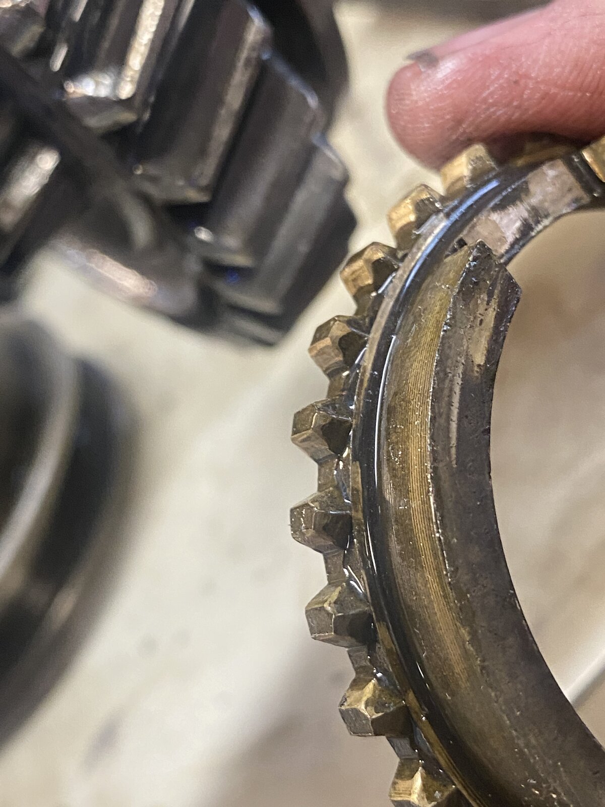

    The clicking sound as you rotate the gears isn’t necessarily a problem…..the low/reverse slider gear is slightly rear of its neutral position and thus raking the teeth of the small reverse idler gear. Normally, the fork for this gear holds it in between the various gears when the transmission is in neutral.
    The picture you included of the forks fitted to the gears shows the correct orientation of the low/reverse fork on that gear. I suspect that the shifter linkage may need adjustment to the true neutral position. Also, check the shifter housing to make sure that the two shifter shafts click into their three positions properly (a spring and two balls hold the shafts into position). Because of the interlock feature, you can’t shift either shaft to a gear position if the other one is not in the neutral position.

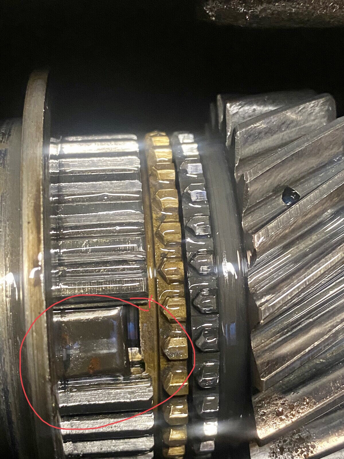

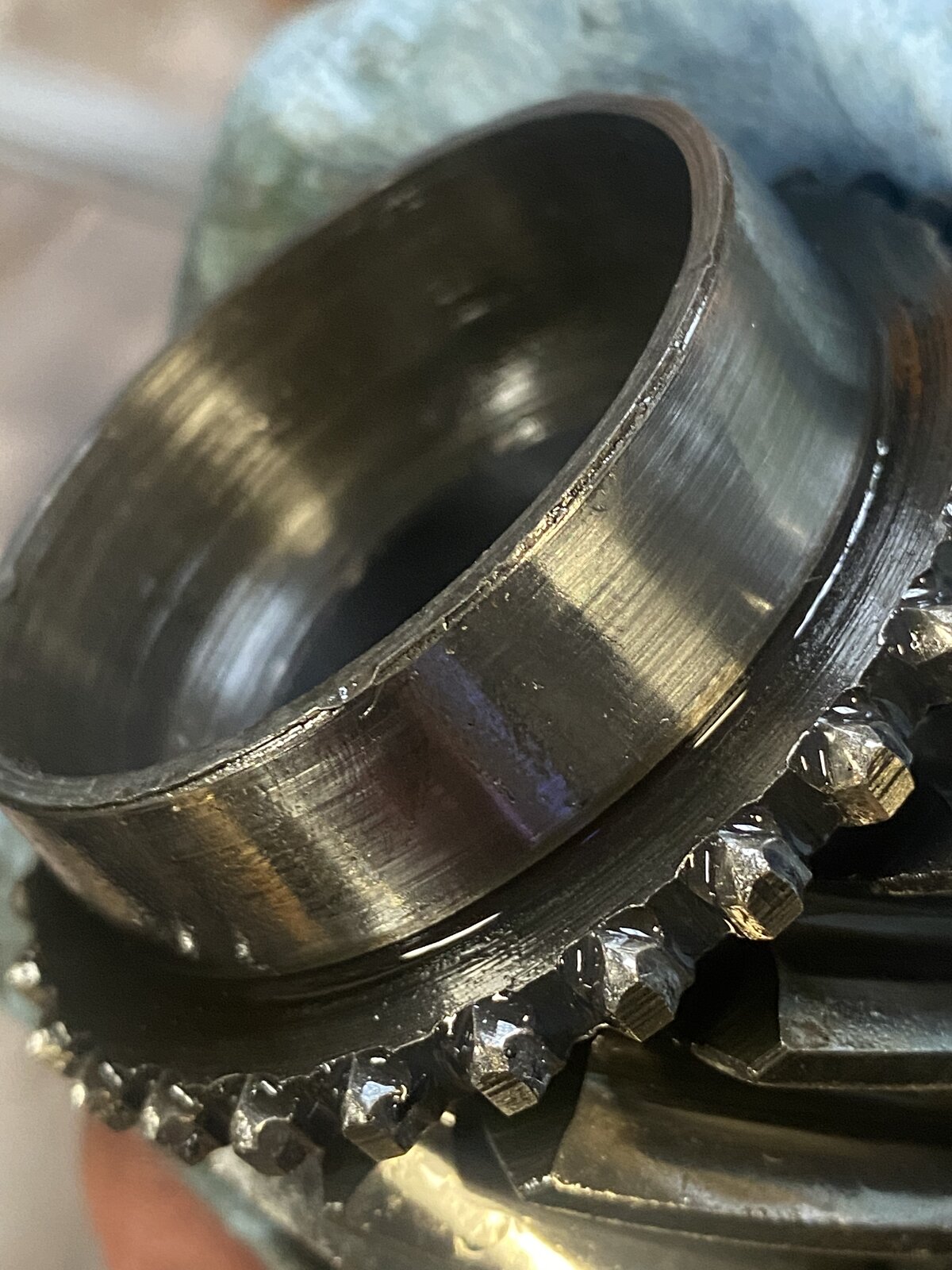

    The picture of the synchro insert shows it in its normal position….no problem from what can be seen in the photo. There are three of them and you can only inspect them properly when it’s all apart.

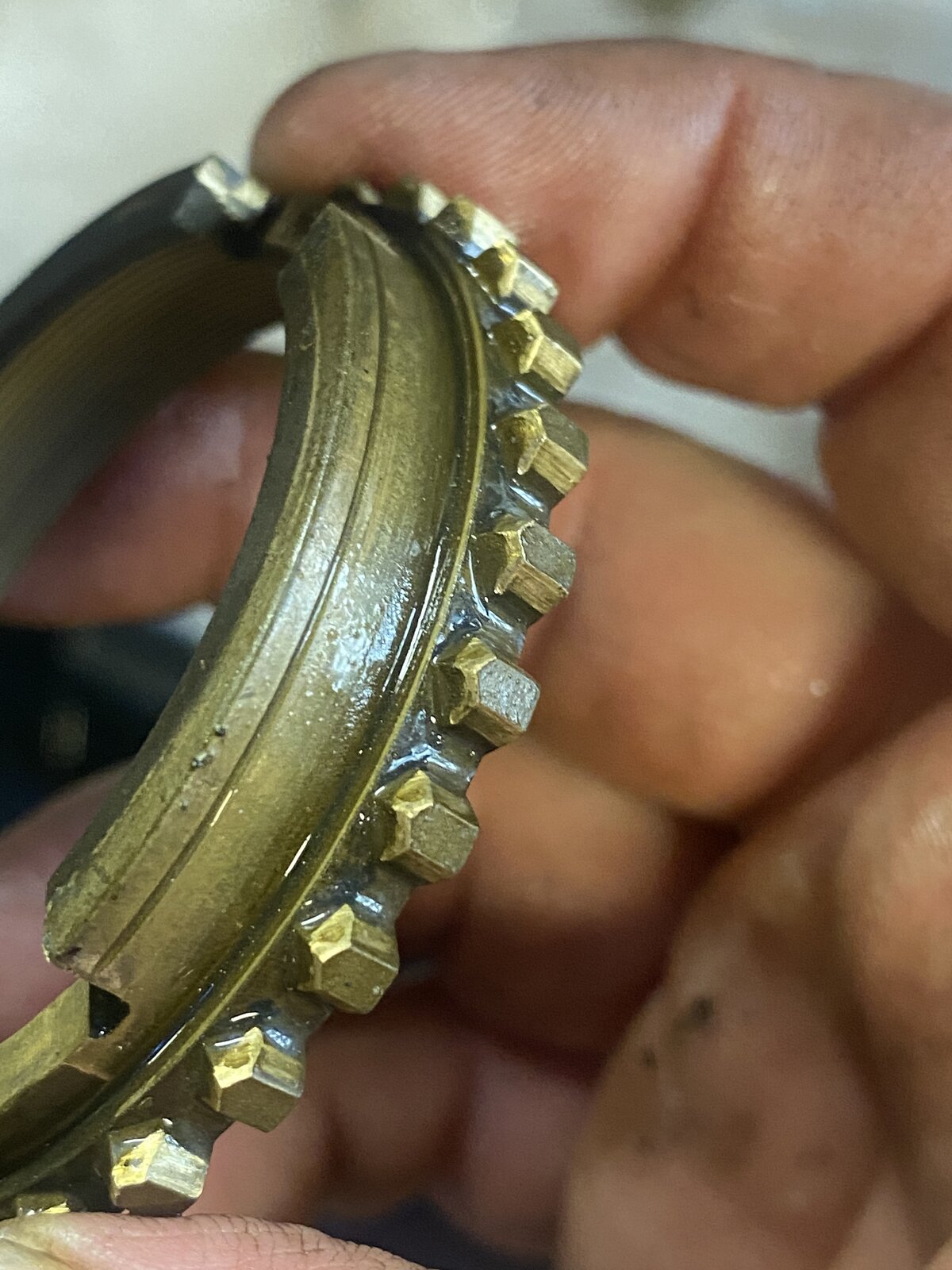

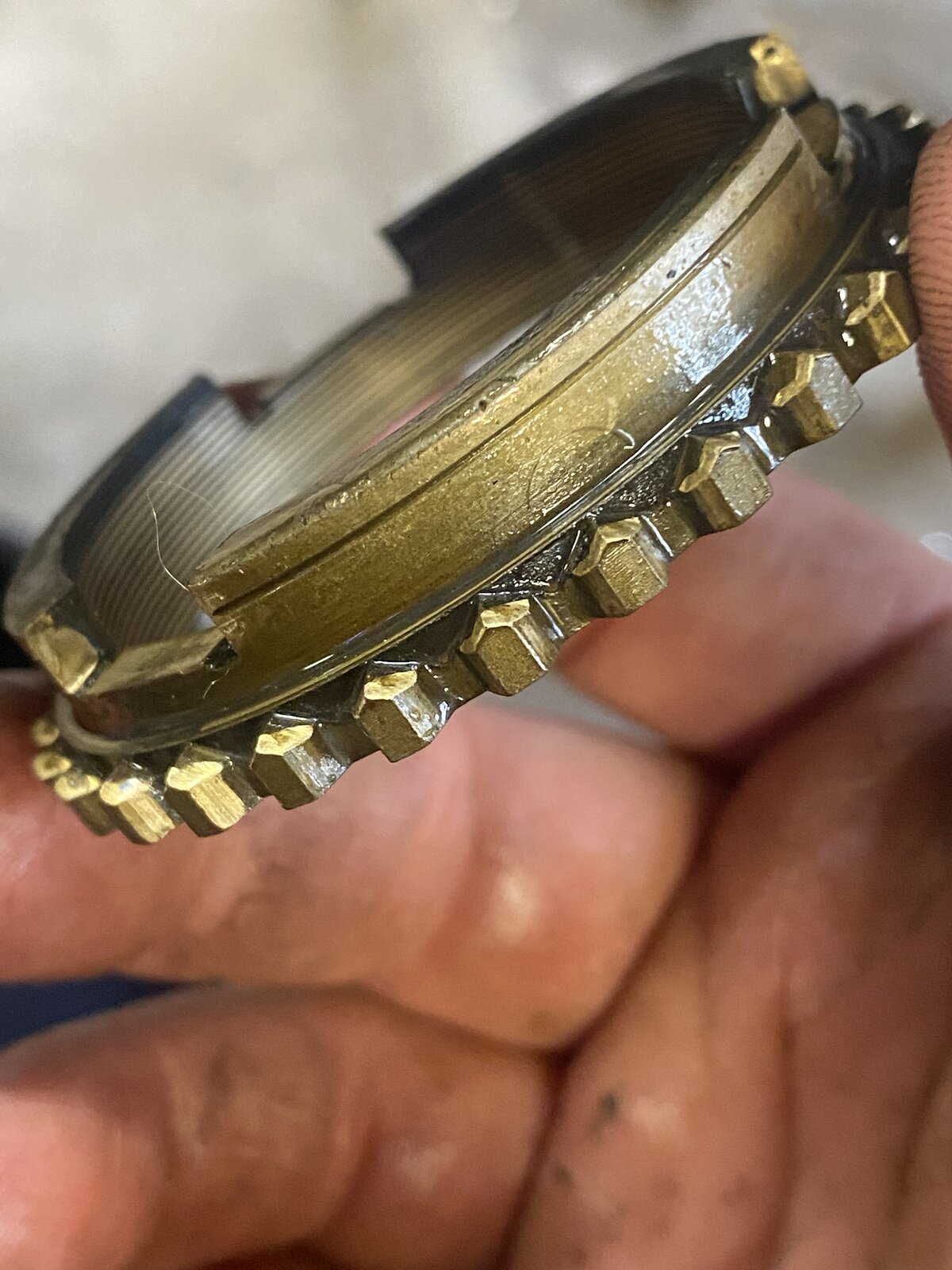

    Almost certainly the brass ring for second gear is close to worn out. The front ring is for high gear and generally doesn’t see as much wear. They should both be replaced if you’re going to refresh the transmission. There is some wear on the small steel synchro teeth on that input shaft gear.
    Popping out of second gear is a common problem for these units after many miles. Aside from closing up any end play looseness with new snap rings and thrust washers, you could possibly need a new second gear and/or a mainshaft. Adjusting the shifter linkage is a first easy step to rule out that as a problem though.
    clem likes this.

    That is a spring loaded detent that holds the sliding clutch in place, there are three of them on the gear. And helps the synronizers work.

    The little metal piece that sets back a bit in the picture, is spring loaded into a detent in the shift collar. When you begin to make a shift the metal piece moves forward with the collar and presses against the brass ring. The inside of the ring has grooves in it and it is conical shaped. Initially the contact "clocks" the ring so the teeth on the ring do not align with the teeth on the gear. Further movement of the collar allows contact with the pointed teeth on the ring. As it is forced against the spinning gear it acts like a brake either slowing the gear down or speeding it up. This increases the braking action until the gear speed and collar speed match. Once the speeds match, the brass ring moves over (un-clocks) and allows the shift collar to lock the gear to the mainshaft.
    With that said, worn brass rings will not cause the transmission to jump out of gear. If they are worn the gears will grind during a shift. Unwanted play, worn parts, input shaft miss-alignment, bad bearings, worn shifter detents will all cause a transmission to jump out of gear.

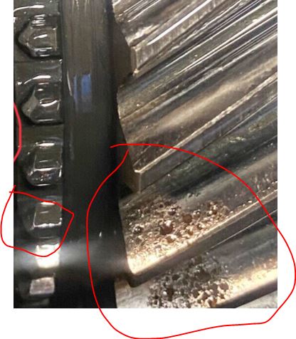

  10. Wrench97
    Joined: Jan 29, 2020
    Posts: 685
    Wrench97

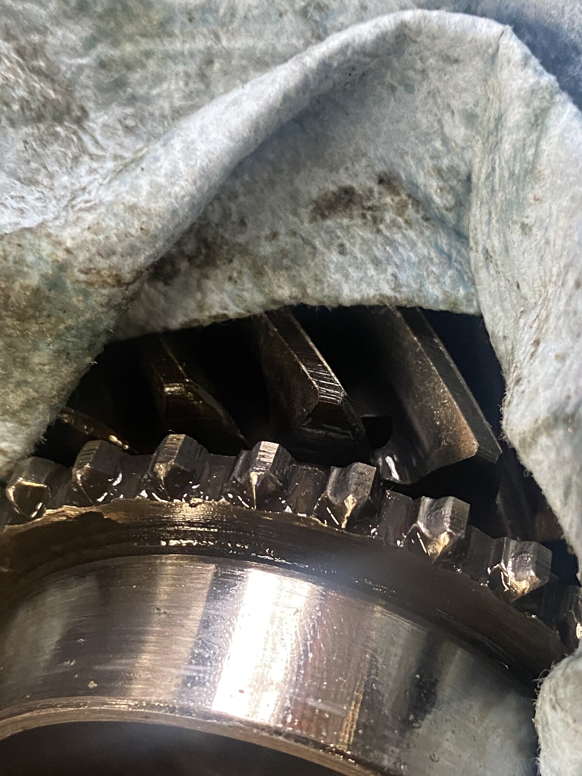

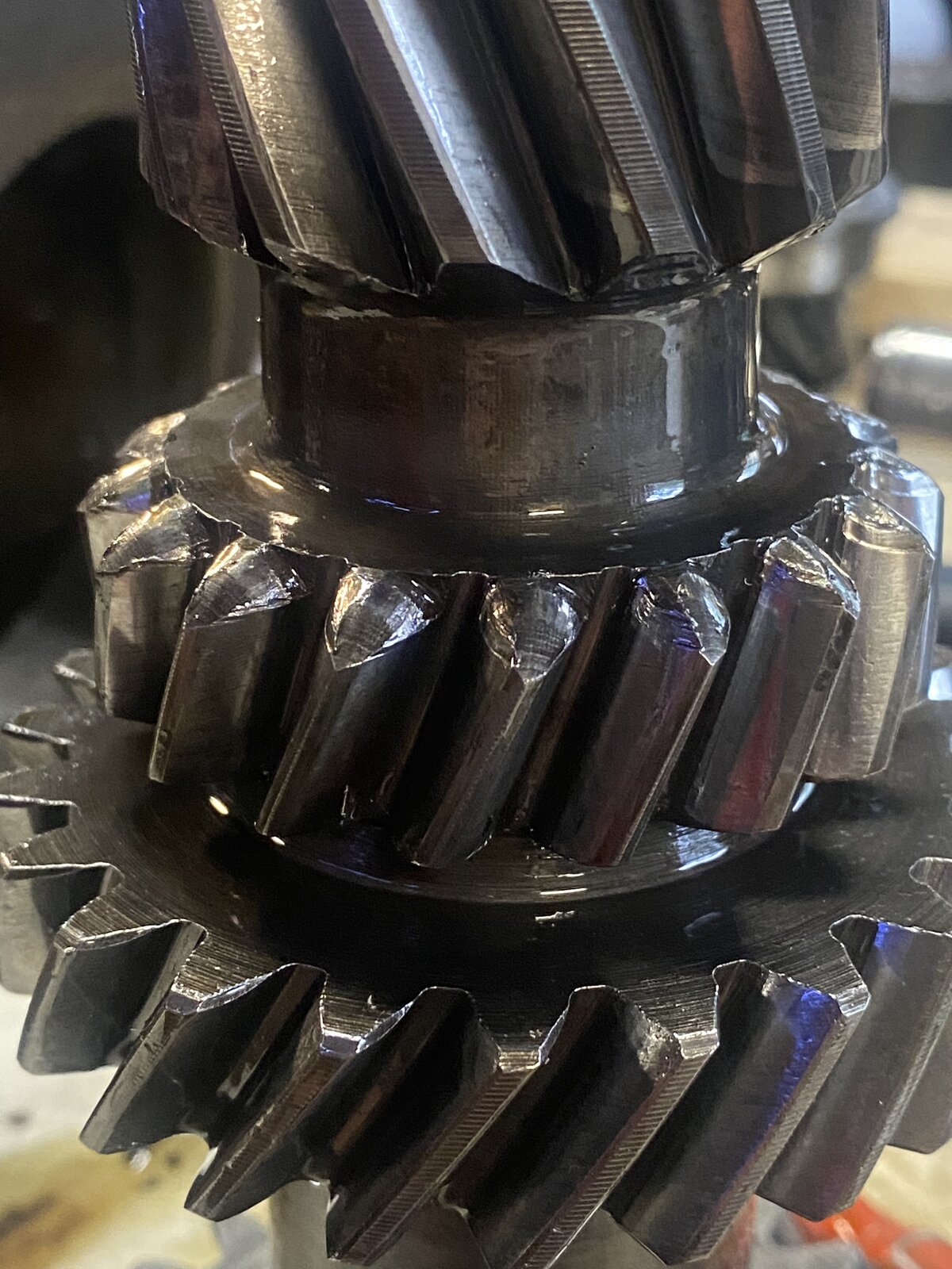

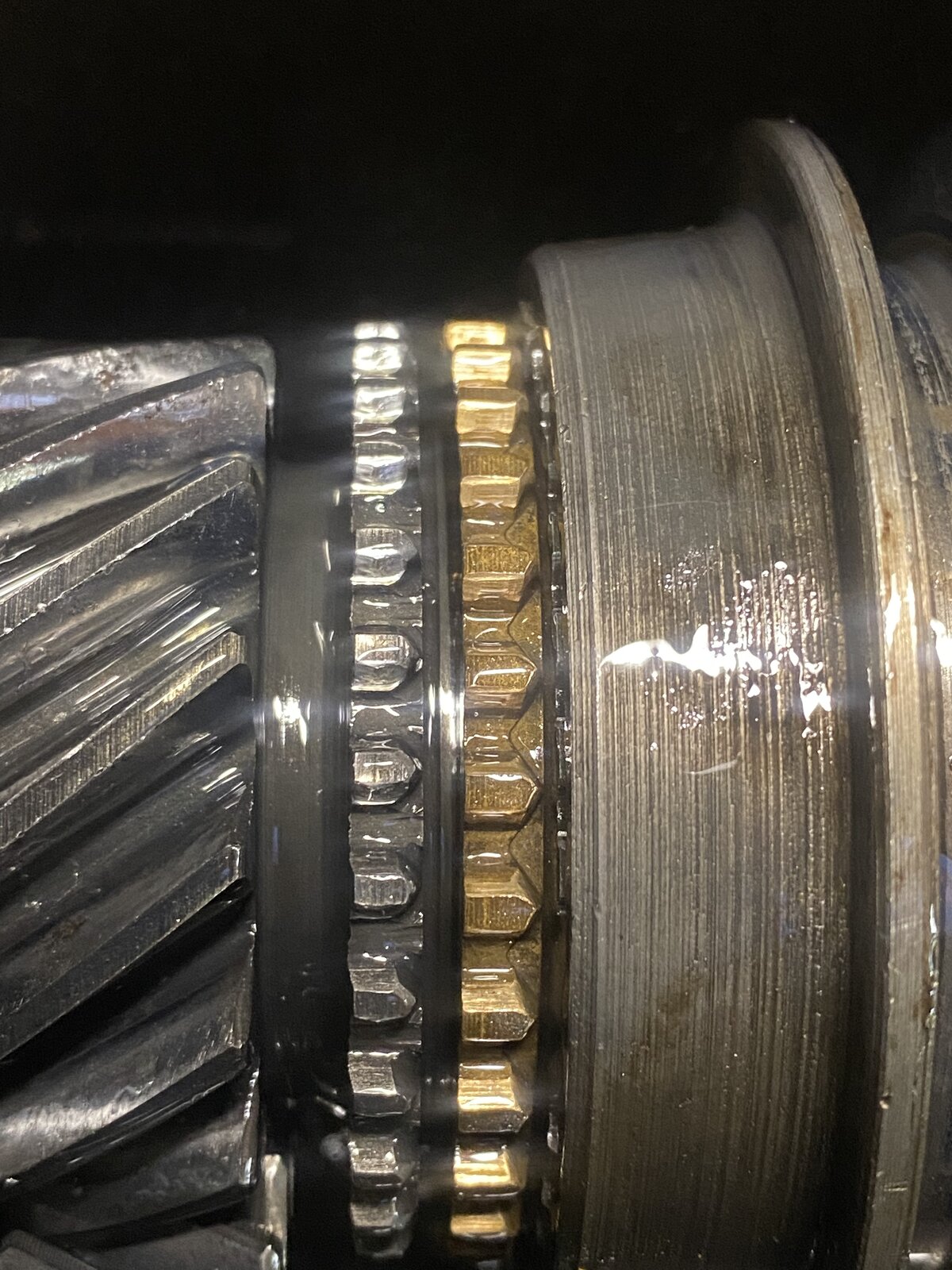

    The rust pits on the gear teeth and the wear on the gear engagement teeth are more concerning to me.
    More investigation is needed.
    Do you still feel the roughness when turning the input shaft?
    IF so time to pull it apart and check the bearings.

    The noise sounds like gear teeth hitting each other, is there wear on the 1st/reverse fork or on the cover lock outs?
    Looking at the brass synchro's they are pretty worn, spin second gear around and look at the engagement teeth for wear there are a couple in the image that would make me look at all of them for wear and looseness of the gear on the shaft. Check the reverse Idler gear for play also.
    As simple as those trans are if it was mine I'd pull it apart and go through it

    Included a pic of the fork. Doesn’t look excessive to me. Still has a lot of shape to it. And the detent system seems to operate normally and doesn’t appear worn out .

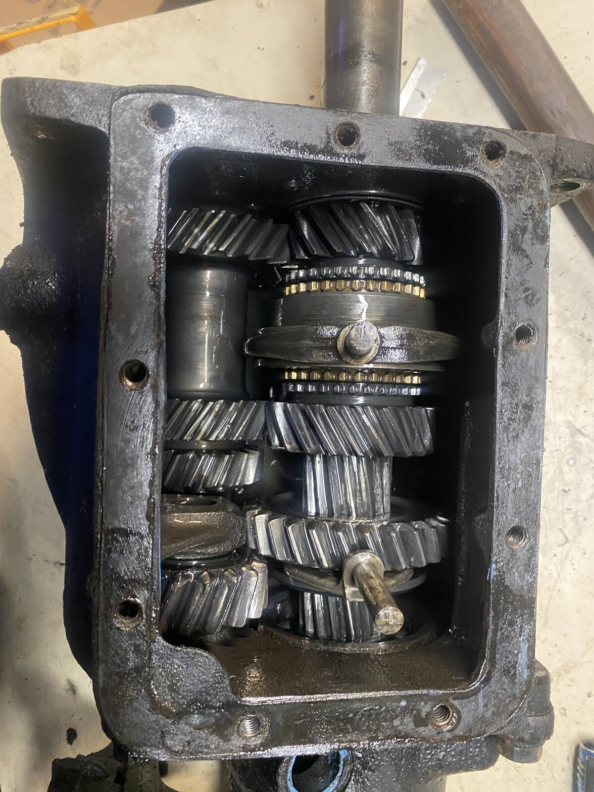

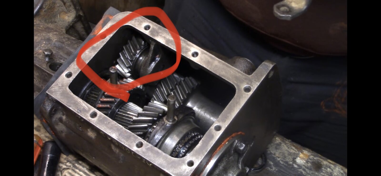

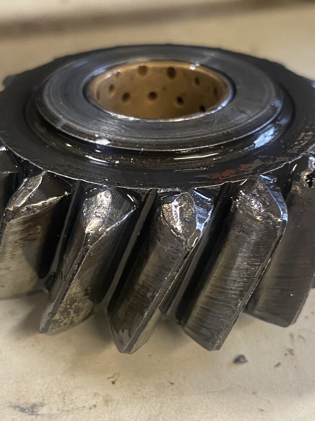

    I’m wonder if my idler gear is in backwards. Is that even possible. Here is a screen shot of a YouTube video with a 58 trans and a picture of mine.
  18. Wrench97
    Posts: 685
    Wrench97
    How much play is in the gear front to back?
    There should be a thrust washer on each side of the gear.

    The idler gear, the one you have circled.

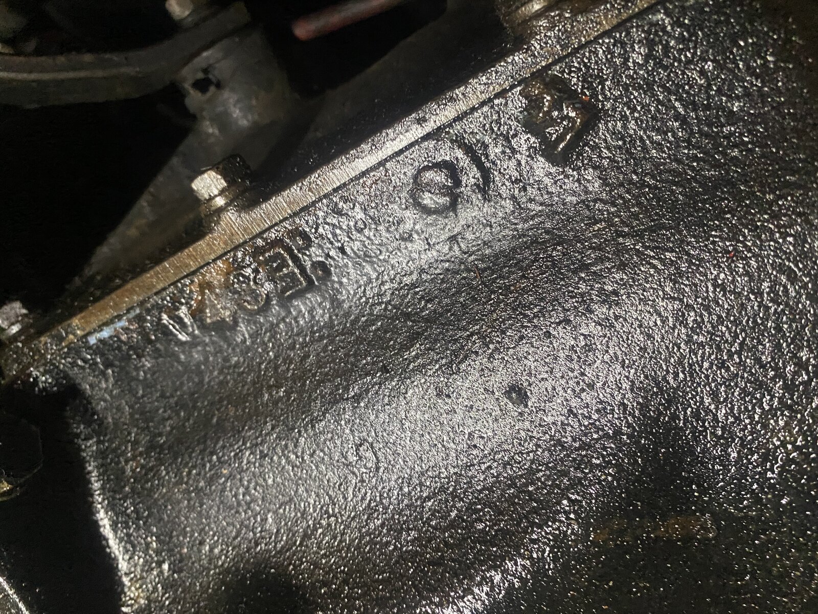

    So I blew this thing apart and looked at everything. I swear this thing looks like it’s low miles (not new, but low miles) like a fresh rebuild. All the brass bushings have almost no wear and there was still clean grease in the input shaft where the output shaft is supported. I really think this is not a natural problem but more like maybe wrong parts installed somewhere.
    My grandfather got the car in trade in the mid 90s the guy he got it from took the overdrive trans out and installed a regular 3 speed. My grandfather rarely drove it and said the transmission was bad and about to come apart. And it’s been off the road since 05 so extremely low miles accumulated since this trans has been put in.

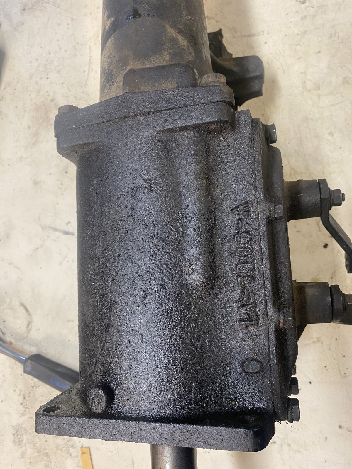

    what’s the best way to verify it’s got the right parts. I believe it’s a 7006-1a trans.

    7006-1a sounds like the main case part number.
    It would be the same on a 3 speed or a 3speed OD, I wonder if he simply modified the original OD tranny using standard 3 speed parts?
    Other then the tail shaft and tail housing they are the same.

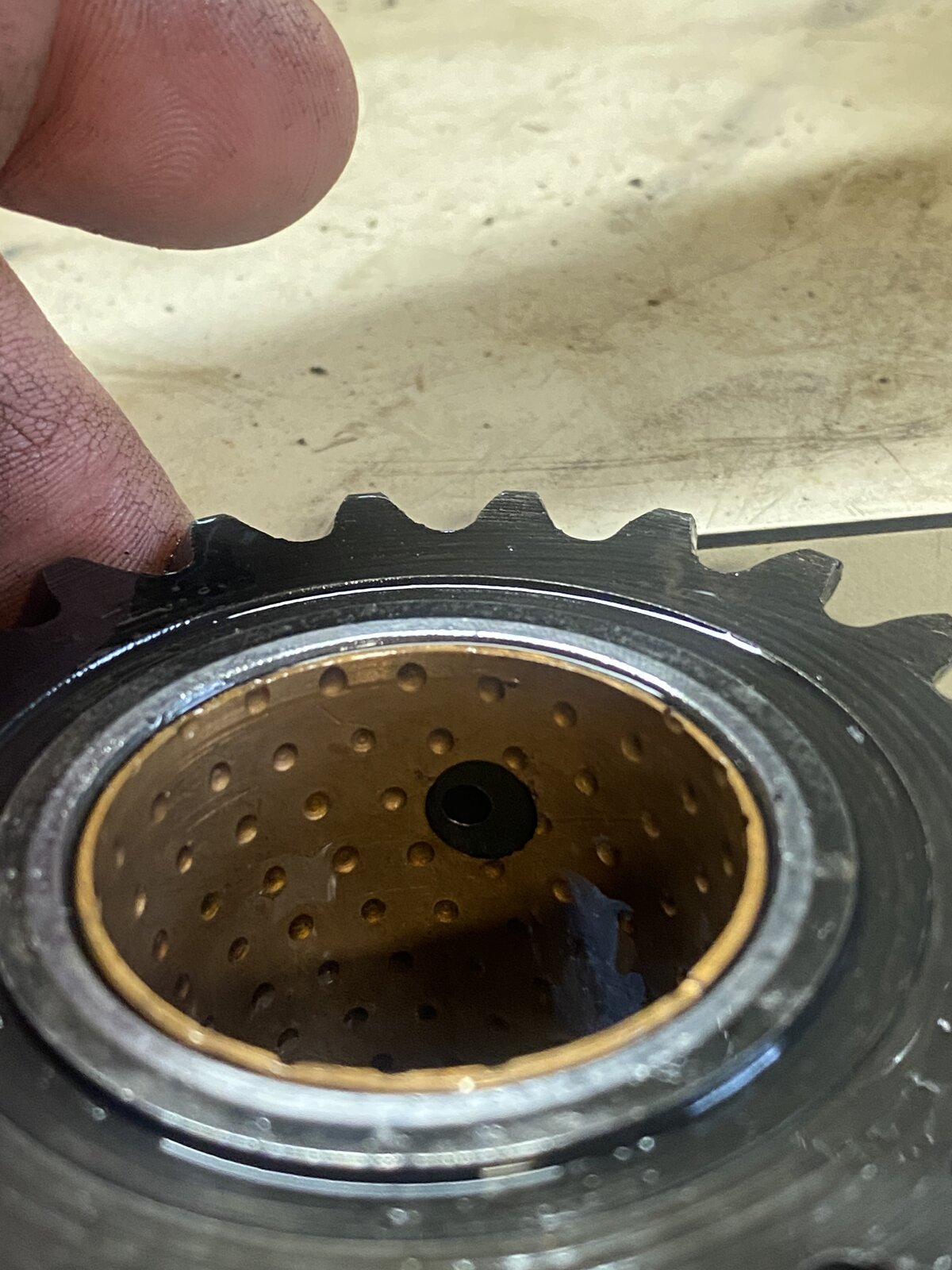

  26. Assuming the low/reverse slider is all the way forward, it sure looks close to the idler. Does the idler have a shoulder on one side?
  27. A.graham52
    Joined: May 31, 2020
    Posts: 62
    A.graham52
    It does have one on one side and the shoulder is facing the rear of the case. However the beveled edge of the gear is facing forward…

    I may have missed it but did it make the noise with the side cover off?
    Are the thrust washers the same thickness on both sides of the idler gear?
    The counter shaft 1st speed gear and the reverse idler are pretty beat up but that is kind of normal on a old non-synchronized gear set or it could be an indication the 1st/reverse slider gear grove is worn or there is play in the fork/side cover pieces allowing the slider to bounce off the speed gears.
