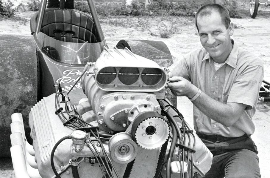

    Pete robinson is Wearing His Usual Smile. This photo Shows The 2 Inch Blower Drive (a 3 Inch Version Weighed A Few Pounds More, So He Rejected It) System That He Used For His Early ’Cammers. He Had No Belt Problems. But A Year Later, Blower Overdrive Dictated The 3 Inch Setup. The Cams In This Engine Were Still Chained Together.

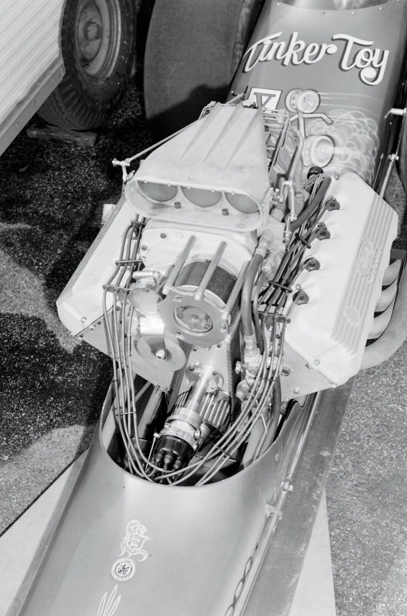

    Harvey Crane Made His Dynamometer Available So Pete Robinson Could Validate The Theory That Cam Chain Stretch Was Retarding Timing And Exploding His Superchargers. For Proof, He Rigged Degree Wheels, A Strobe Light, And An 8mm Movie Camera To Record The Phenomenon.

    And the outcome was?
    Don't leave us hangin'!

    I'm thinking that his su****ions were correct, that's why he designed and ran the gear drive system for the cams. [emoji16]

    @427 sleeper nailed it he proved the cam stretch and went on to develop a gear drive.

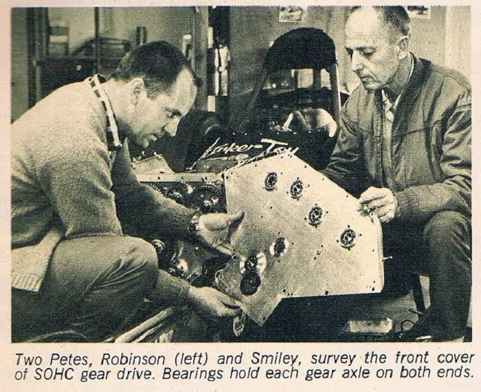

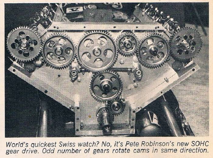

    Would like to see the gear drive for THAT!

    Were Mickey Thompson, Tommy Grove, Gas Ronda and the rest using this gear drive setup?

    .........For sure!

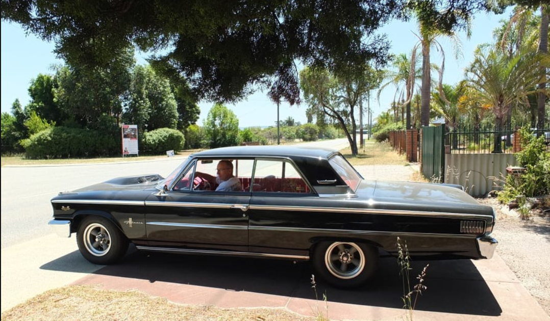

    I've posted other photos of this car before, once more
