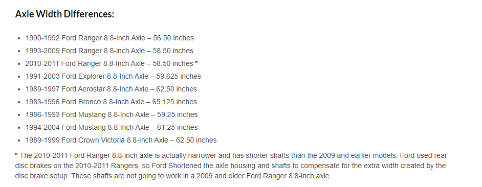

  24. Mr48chev
    Joined: Dec 28, 2007
    Posts: 36,519
    Mr48chev
    All BS aside, There comes a time when that "cheap" rear end all the sudden gets damned expensive.
    Ford Maverick is listed at 56.5 but I flat defy the guys who suggest one to run out and find a 5 lug Maverick rear axle without a h***le and a long hunt now.
    90/92 Ranger pickup rear axles are 56.6 and a few minutes on The Ranger station will help you figure out how to know what gear ratio a donor rear will have.
    To me gathering up all the pieces missing off that stripped rear axe that might not be the right width is going to be spendy and not prudent especially if it has a settled for gear ratio rather than a chosen for gear ratio.
    Your dime but my guess is that a Ranger rear end in good shape with the right gear ratio is going to run less than than backing plates, drums, shoes and springs and hardware for that maybe too wide 8 inch. Screenshot (1580).png
    Algoma56, MattMFC and arse_sidewards like this.
