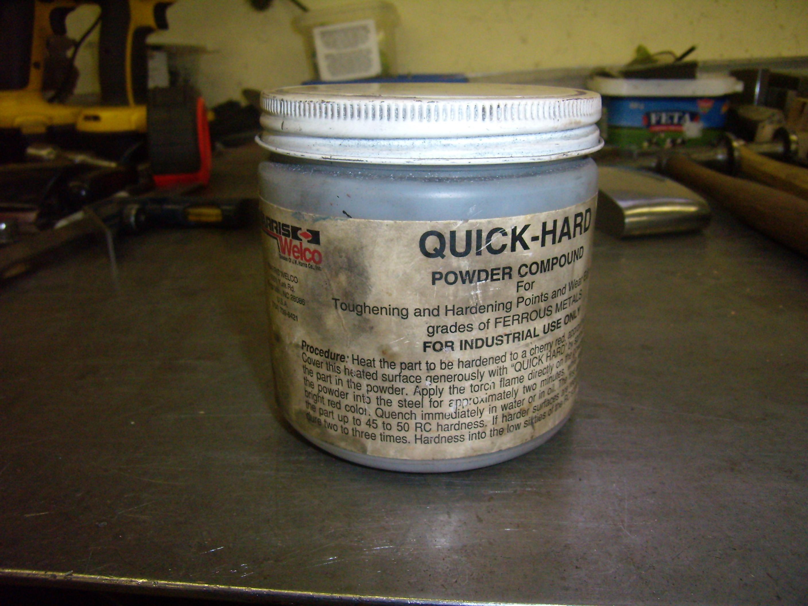

    -You've probably used surface hardening compounds, an application would extend the life of your special cutting tools and parts subject to wear. I'll attach a pic of a product I've used off and on for decades, works well for many things.

    I have never used an XY table on top of my 8" rotary table although I have made plenty of other crazy setups on it. Usually I position my work initially and then spin it. I have used surface hardening compounds like Kasenite but generally my tools are made from O-1 or W-1 drill rod, hardened and tempered.
