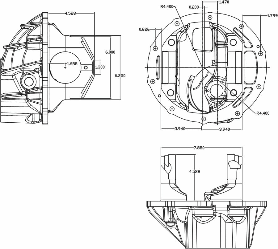

    1.688?
    But what you really want to know is the distance from the U joint to the center of the housing, eh?

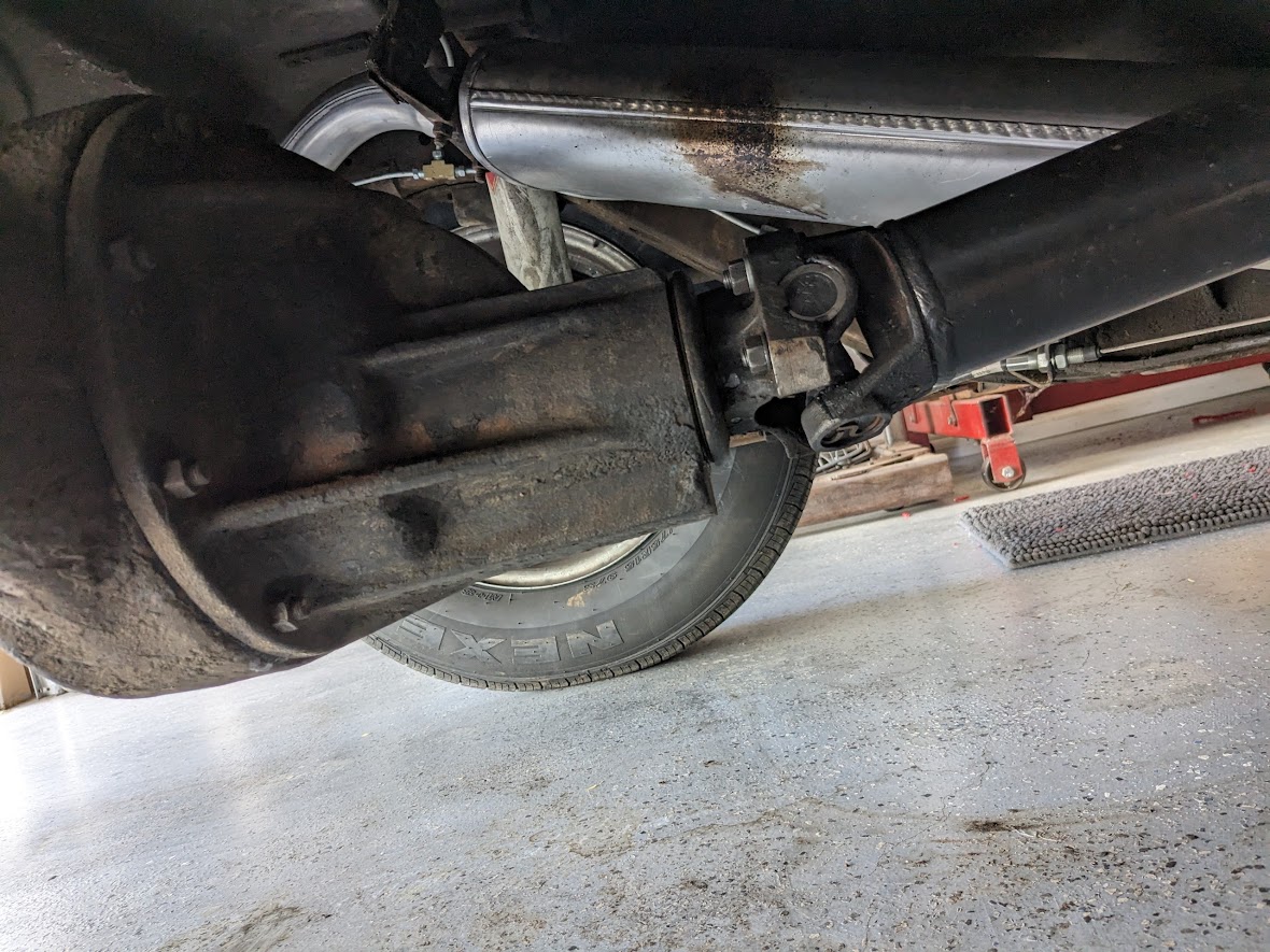

    But yeah, I could slide under my two 62 Chevys and compare the distance from U joint center line to axle housing center line. The one with the 9" has an aftermarket 1350 yoke, though.

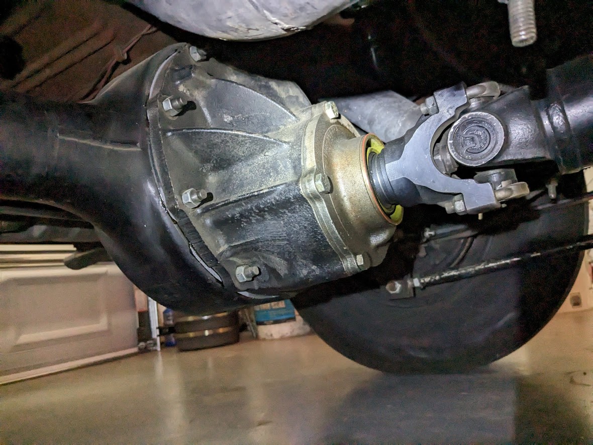

    The 9" I have is about 3/4" shorter from U joint to center of housing, than the original 62 rear. There are different length yokes for the 9", though, as mentioned.

    I actually got ahold of two different third members, one has a short yoke and the other a long one. I think based on the yoke being lower, and your measurements there, I'm going to have to have a longer shaft made. Inwas really hoping I'd luck out and have it all done in a weekend, but that's how it goes.
