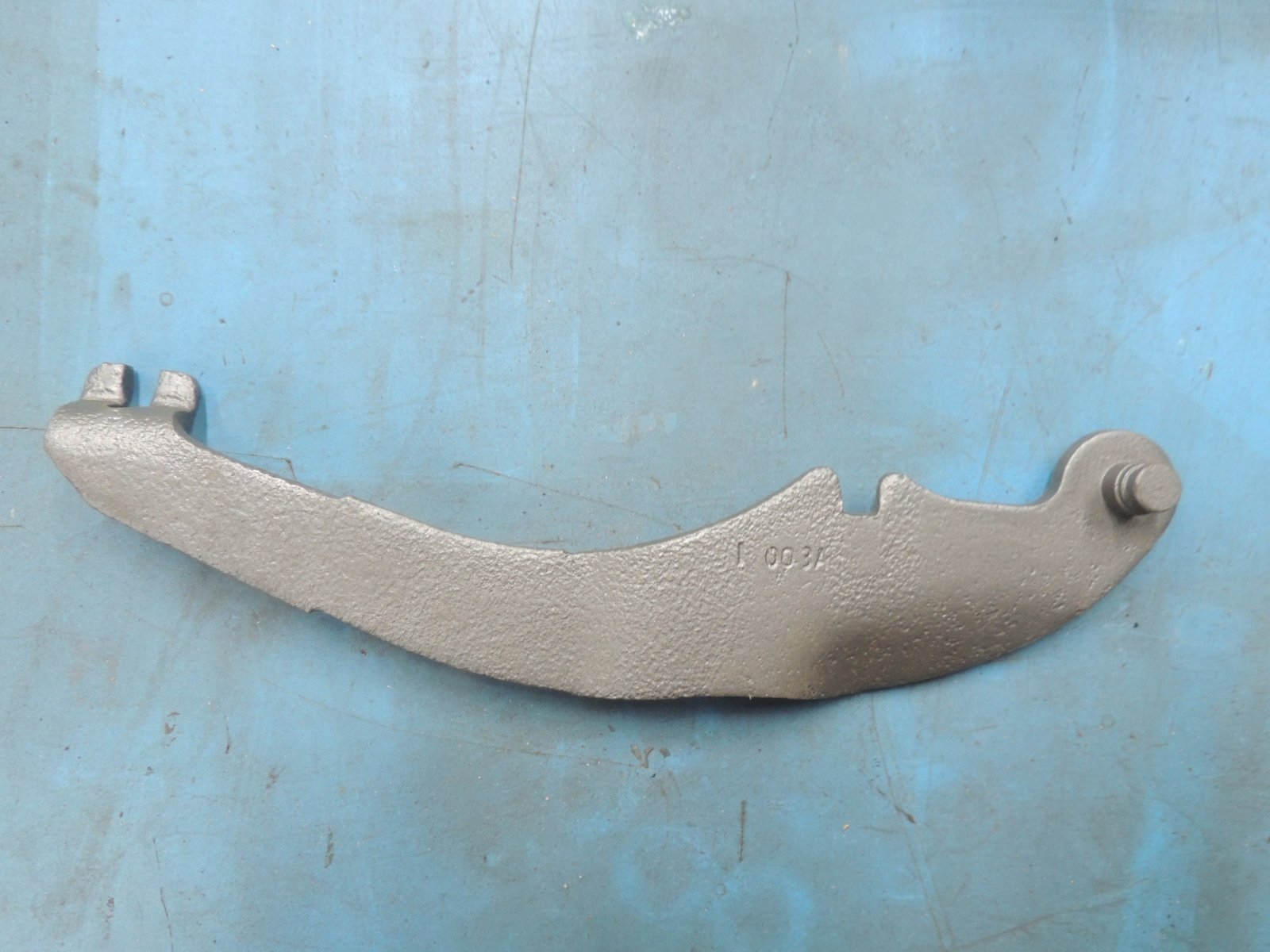

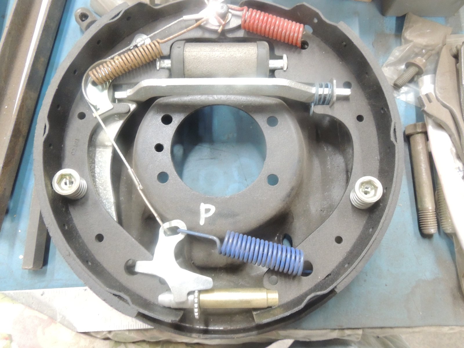

    Here are some pictures to help see what the original cable looked like. Its got a barrel shaped end that catches in the "claw" and needs the correct push-in size for the hole in the backing plate. A ball on the end of the cable might also work as long as it doesn't pop out. Probably a little ingenuity might be needed if you have a ball on the cable.
    Click on the pictures for a better view...........:)

  12. 2ManyJohns
    Joined: Jan 2, 2024
    Posts: 23
    2ManyJohns
    Hey ekimneirbo, thanks for posting the pics. Those parts look a lot more familiar and proper. I sent an email to QP, and theyre pretty good to work with so theyll probably work it out.
