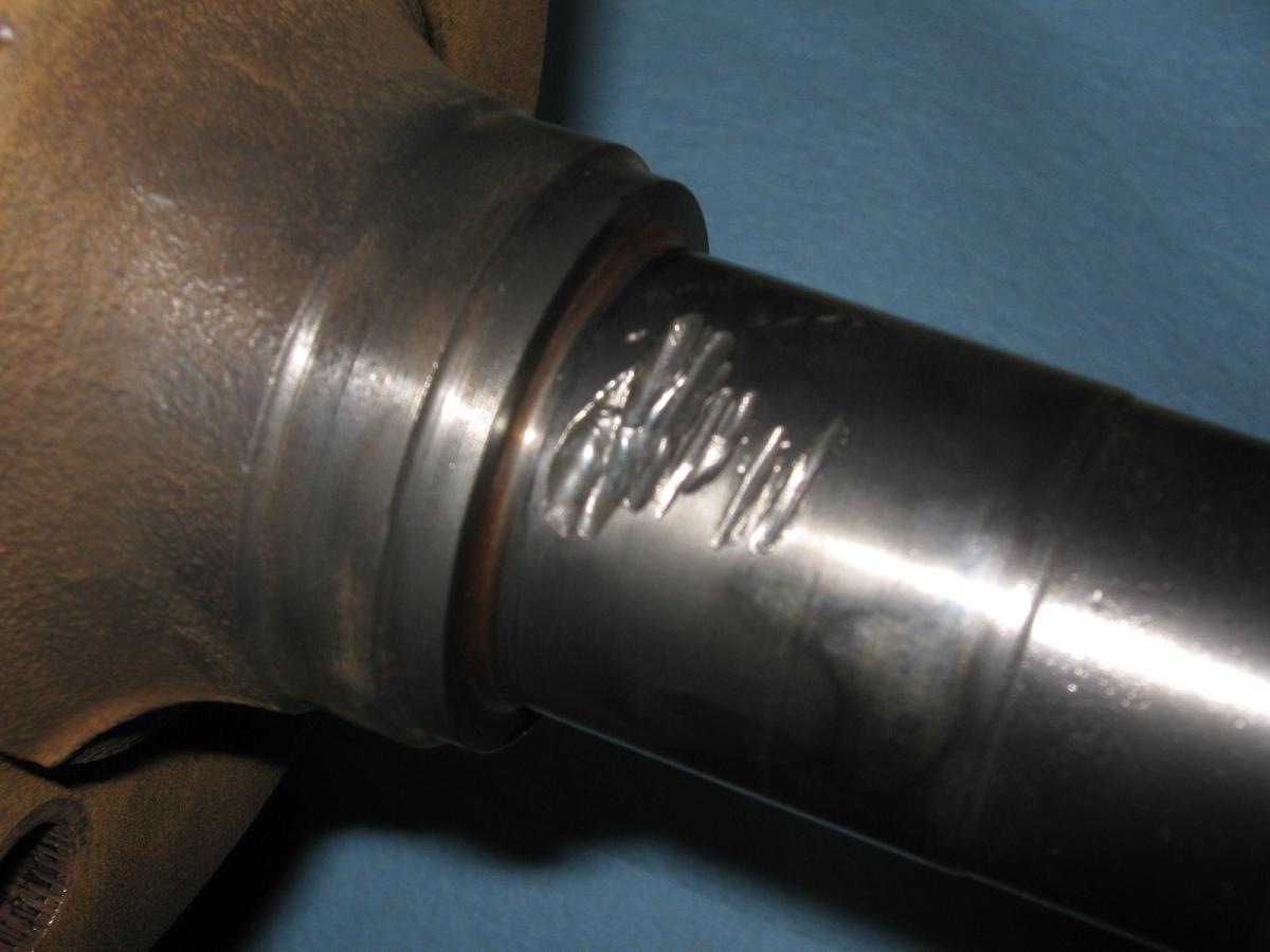

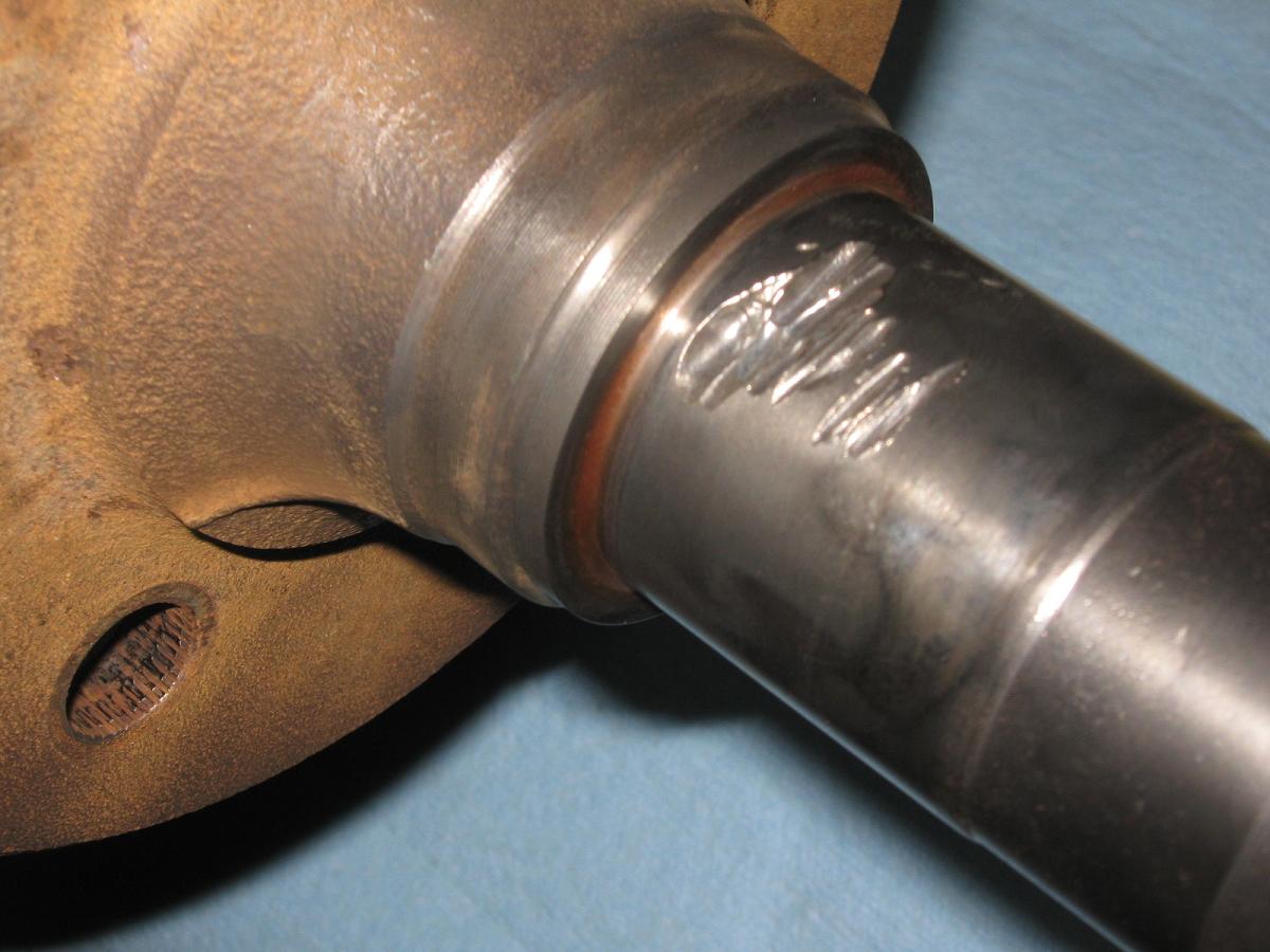

    So I took my 57 big bearing rear axles to one of the largest shops in the city to have the bearings removed. They torched them (and chiseled presumably). The counter guy set them in the trunk for me so I never noticed the mess until I got home. I cleaned off all the torch mess before taking these pictures. Now what? Is there any chance these are still usable??

    they are not good with a torch by the pics but some emery cloth and it will be fine

    Whoa, you found a hack shop, go back and get some money from them....

    Post 7 below yours is why you don't want someone taking them off with a torch. Too many guys with a torch make a bigger mess than they fix.

    I wouldn't even think about using those axles in that condition. Each one of those chisel digs are stress risers where possible cracks could develop.
