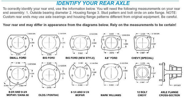

    There is more to getting a 9" than just buying one that's the right width. Generally the narrower ones are more expensive, but most of them have 28 spline axles which aren't as strong. Since you have a 4 link and apparently want more strength, it's often best to buy a wider one with 31 spline axles. It's also hard to get one that has the ratio you want......if its got a 3.25 and numerically higher ratio.....seller usually wants more for it. Depending on where you are located, you can pick up a complete 9" for $150 - $250. Buying an incomplete unit and then trying to get the additional parts will end up costing you far more. I'd suggest you purchase this book off Amazon. It will save you far more than it costs and will tell you what vehicles had what rears in them.

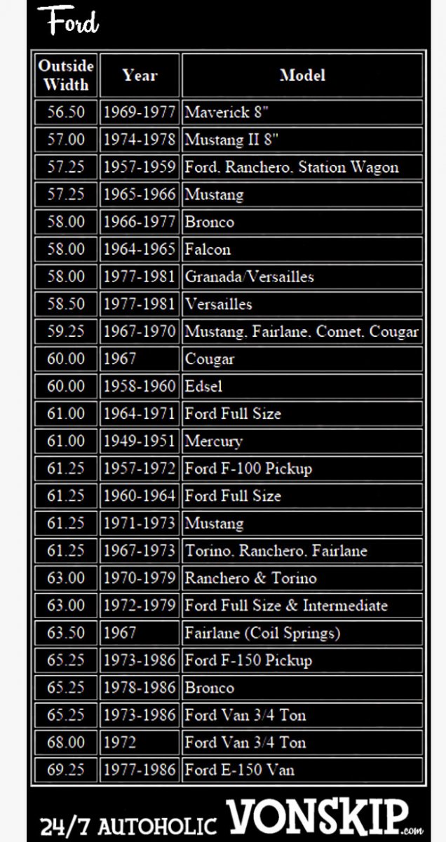

    Here is a list I have saved on my computer, it's a old list and I am sure there are a lot more nowadays. HRP
    • 65-66 Mustang = 57.25 inches.
    • 67-70 Mustang = 59.25 inches.
    • 71-73 Mustang = 61.25 inches.
    • 77-81 Versailles = 58.50 inches.
    • 67-73 Mustang, Torino, Ranchero, Fairlane = 59.25 inches to 61.25 inches.
    • 57-59 Ranchero and Wagon = 57.25 inches.
    lothiandon1940, Sharpone and Budget36 like this.

  15. I measured a 68 Cougar 8" I have and 59.25" is correct.
    Sharpone and lothiandon1940 like this.

    Anyone know why 67 cougars? Are listed at having a 59.25"and also a 60" in that list?
  24. Ford intermediate cars used different rear axle ***emblies depending on the engine used. 6 cylinders and small blocks got the 8" rear, and FE engines got the 9", although I have seen a small block (289 or 302) with a 9". Tolerances also a little broad, so 59.25" or 60" not far apart. Brake packages can also come into play. I am sure @Crazy Steve can add more.
