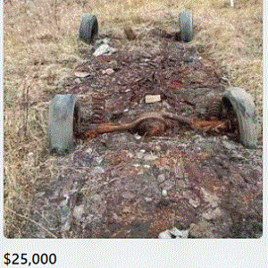

    What the value $$ of a Ford 9" ?..... i.e., what would you pay max?

    Dude has it priced at $450 on the pictured above located in Gooberville. I was thinking that is a laughable price.
    Use to be able to get one at pick-a -part for $40 bucks

    [QUOTE="Bangingoldtin, post: 15321258, member: 357034"...............A 9" center section has some value, a 9-3/8" less........................[/QUOTE]
    Curious , How do you quickly determine if its a 9-3/8" vs 9" ..... if your gettin' at a junk yard in the dirt?
    Can you only tell its a 9-3/8" from inside and pulling out the carrier?

    it's a 9", it doesn't have the curved rib that a 9-3/8 has

    And for those that don't know and think "they must be stronger because they are bigger" keep in mind that AFAIK, the aftermarket has near zero support for the 9&3/8" rearend.

    The thing about the 9" rear is that very few of them were heavy duty units, most were open 28 spline with highway gears. And the width and mounting is wrong, and the brakes need to be rebuilt or changed, etc. So you end up replacing most of it when you put it in a hot rod. That's why they're not worth very much, and why so many guys pay $2k or more for a complete 9" rear set up to work in their car, instead of buying a used one.
  19. Not all Ford axle housings are created equal... The coil spring and pickup housings are the stoutest OEM ones and least likely to bend under severe use, but most will need narrowing for use under a HAMB-era car plus the removal/relocation of any bracketry. These are a good choice if you're planning on an axle housing mounted rear sway bar, I've seen the lesser housings bend with a rear bar.
    Seeing how you can now buy a brand-new 58" WMS-to-WMS housing for $400 that just needs your brackets installed, these have become less valuable. And as has been pointed out, the diff will likely be a tall open ratio with 28 spline axles, an additional upgrade cost. If the drum brakes are present and complete for rebuilding (and usable for your use), that can add value. New drum kits are $350 and up.
    IMO, to the right guy this may be worth as much as $350, but personally I wouldn't give over $200 for it.

    When I was collecting parts for my roadster project in the late 90's I ended up with three 9&3/8" units as a package deal, looked just like the one in the photo, and, only because I didn't even know they existed, I think I paid $50 for all three, pulled them apart to I.D. and blew all the bracketry off one to use, then found out they weren't a nine inch and not too desirable, ended up giving them to a friend of mine.

    Moser 3.50 posi, just the chunk, $1700 in E. Tennessee. $600 just south of me in Georgia, looks just like the one you have pictured. $500 for one that's been shortened, and $50 just for a housing.
