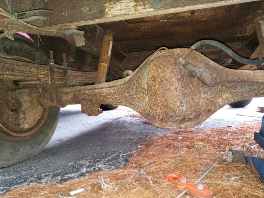

    I have what I beleieve is a 9" ford but not entirely sure but the bolt pattern is 5x4.25". I dident think they made a 9" with a bolt pattern other than 5x4.5" and 5x5.5". I have no idea what the rearend originally came from. Hoping I can just swap axles to a 5x4.5 bolt pattern. Has anyone seen this or have any idea what this could have came out of? 20210130_164647.jpeg 20210130_164625.jpeg 20210130_163538.jpeg 20210130_163754.jpeg

  2. First off that is not the way to measure wheel pattern. It is clearly a 9" and being it's in a Truck probably 5 on 5.5 pattern unless it's in an Econoline.
  3. I think T bird, Cougar from the late 80"s had that pattern.

    Its not the original rear to the truck, its under a 65 gmc truck and I have some 5x4.5 wheels off a mustang that will not fit lug pattern is too big. Please dont bust my balls too bad ive always measured wheels that way and never ran into this issue...

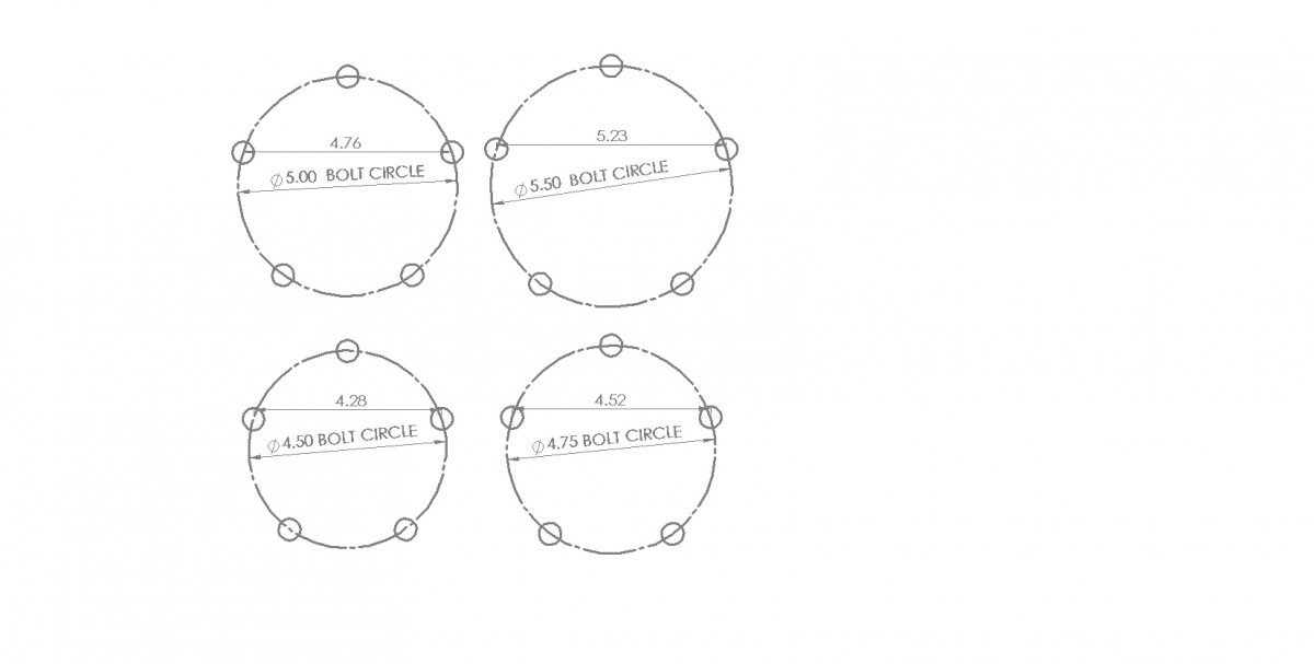

  18. Ken Smith
    Joined: Dec 6, 2005
    Posts: 493
    Ken Smith
    Alliance Vendor
    As noted above: measure across 2 studs, add about 1/4"

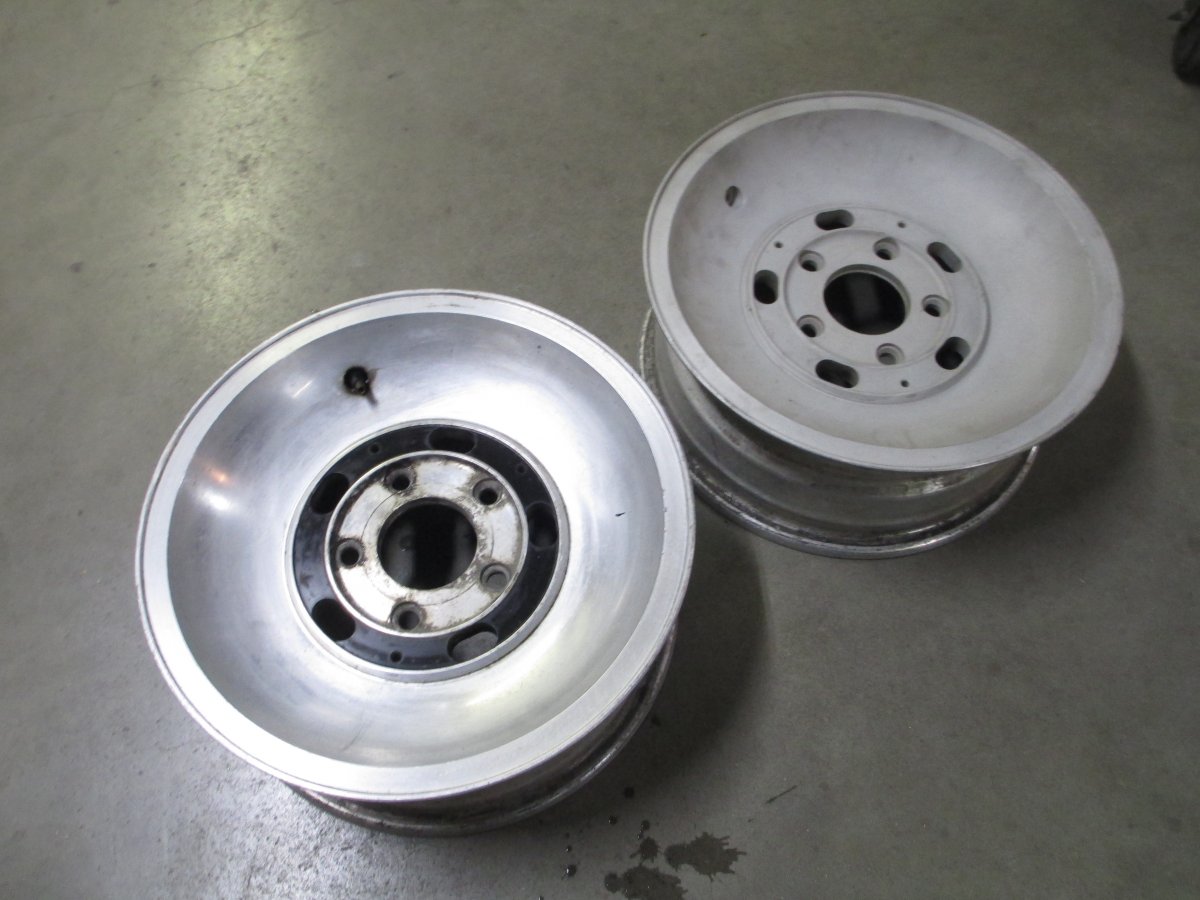

  21. Marty Strode
    Joined: Apr 28, 2011
    Posts: 9,725
    Marty Strode
