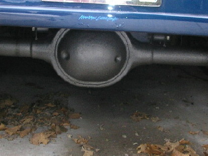

    Once it's installed you probably won't see much of the rear-end, especially the top. Here is a picture of my 29 coupe, with an 8". A 9" wouldn't be that much different.
    Red
