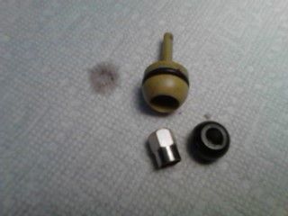

  10. caton462
    Joined: Jul 17, 2013
    Posts: 176
    caton462
    The part in the pan probably plugged the dipstick hole.
  11. tommyd
    Joined: Dec 10, 2010
    Posts: 11,999
    tommyd
    from South Indy
    get-attachment.jpg The part that looks like a spinning top is what I'm used to finding in the pan. The black rubber grommet is what I found. I put the chrome tire valve cap next to it for size reference. Beats me?
