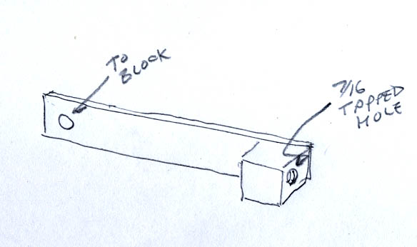

  3. Something like this
    Adjust length as needed to get belt alignment, use spacers if needed for the water pump bracket. I'd use stout material, 1/4" flat stock at a minimum. Weld the tapped boss onto the end.

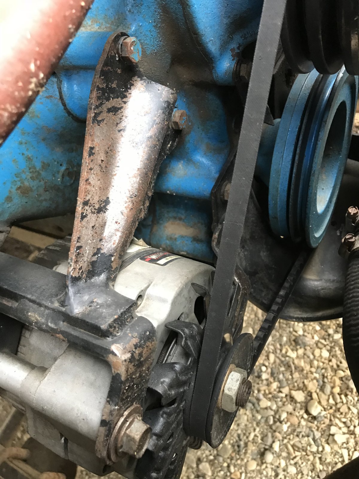

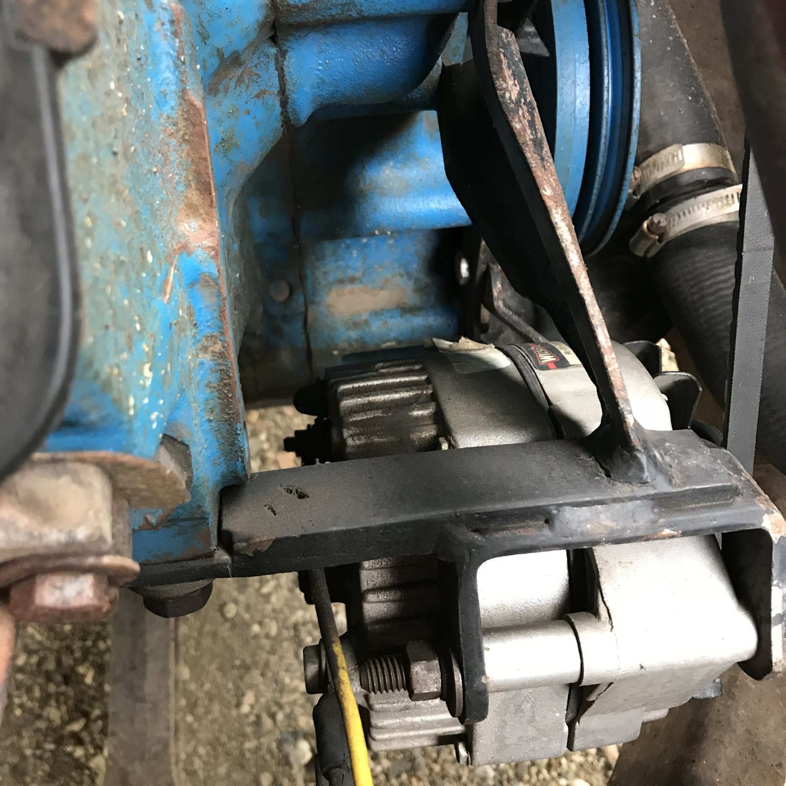

  5. Wanderlust
    Joined: Oct 27, 2019
    Posts: 1,087
    Wanderlust
    Mine done by previous owner, not pretty but it works 23F0FBE3-D151-41E4-8D7C-0EF86891A888.jpeg 3CA28E8A-6624-4712-8F91-50AA24772566.jpeg
