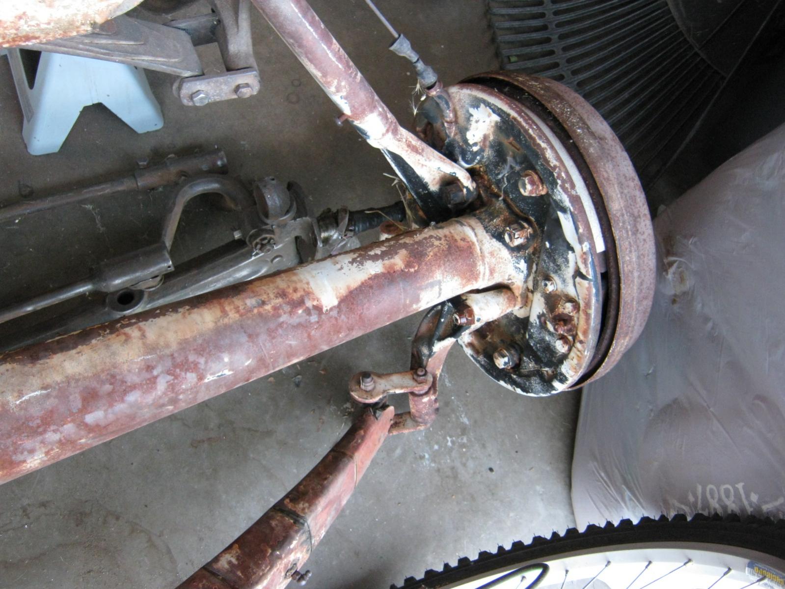

    AV8-Rider
    You probably got it there Bruce.

    Talking of axles, this is my dropped and filled one. Most likely an Okie Adams.
    RFemember the brakes Bruce????
    Kinda strange huhh, that the axle one of the more beloved parts on a hot rod.
    Perhaps 'cause it's so important to stance and so easily visible on a fenderless car.
    Paul.

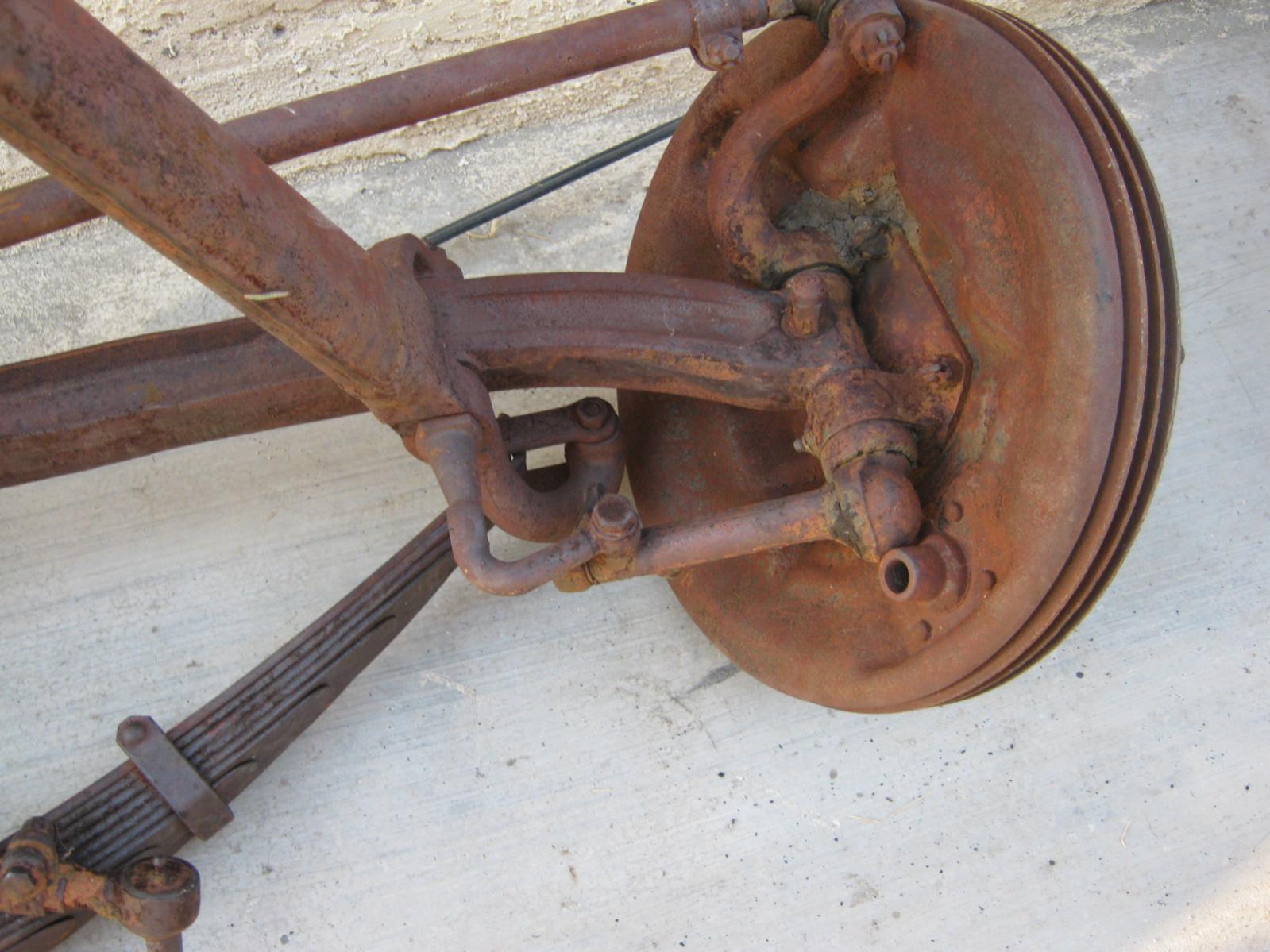

    Here is some more axle trivia for you hot rodders to chew on.
    Bought an old California buildt (Redwood City) T Touring this summer.
    Hopped up in 1953 with the drivetrain off of a 40 60HP Pick Up.
    The front axle though is a heavy beam.
    It has a drop I have certanly not seen before.
    It's quite flat and "thin" on the neck.
    Not the best pictures fer sure but I guess you get the idea.
    Anyone knowing what, Where, who this comes from? I'd love to know.
    Paul

    I think some were stretched a bit when they were dropped. Thats when they got a little thin. Some were heated and hammered bakinthe day.

    That one has been shaped about like the hammered ones...but perfectly smoothly and uniformly. I don't have any idea of how, but this was done mechanically with maybe soem kinfd of rolling or pressig?? There had to be some kind of gigantic machine replacing the guy with the hammer.
