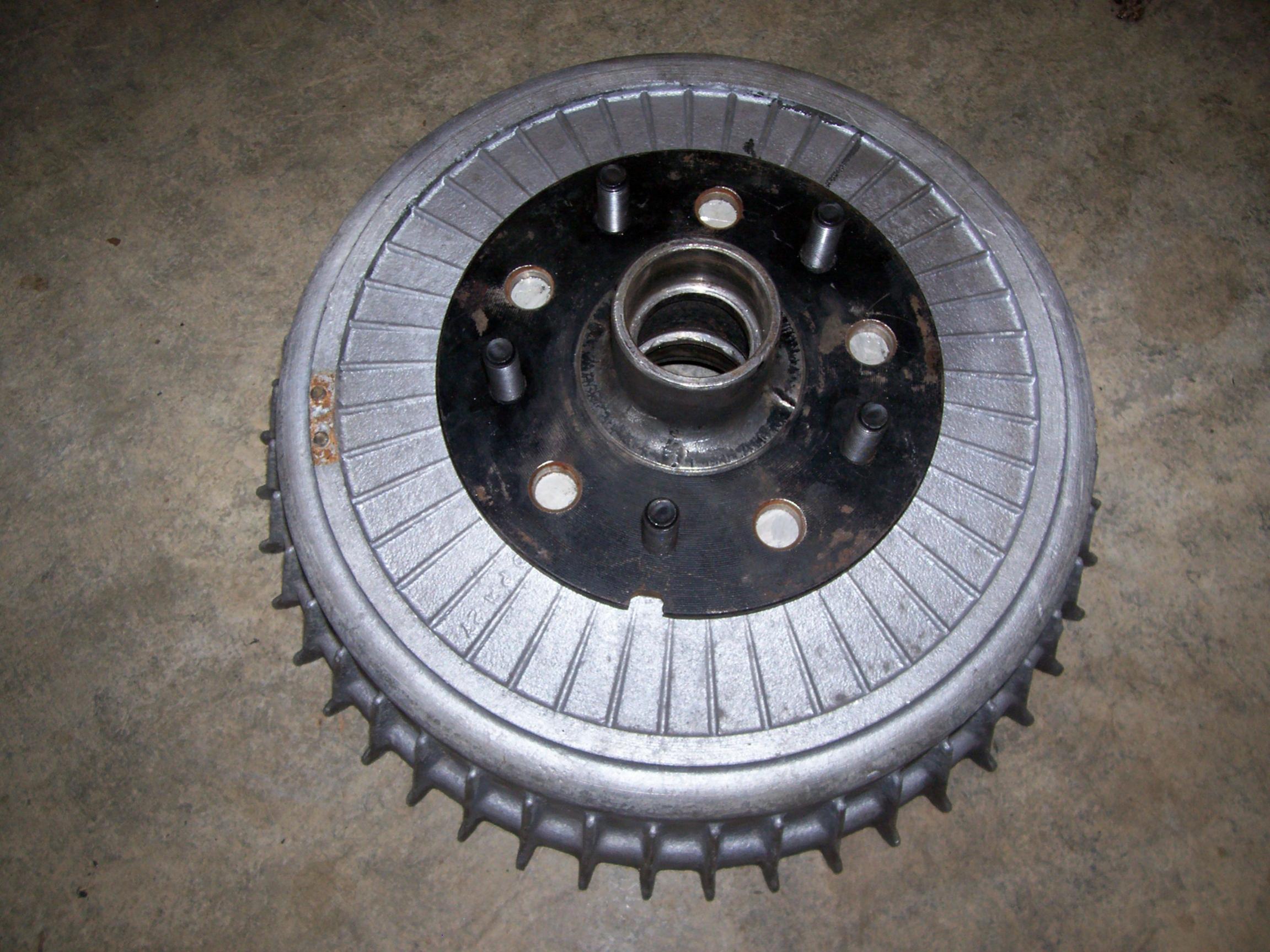

    How do you tell the differance between 46-48 hubs and 40 ford hubs. Are they inboard or outboard. Any pics would really help. I am collecting parts for buick drum swap.
  2. The hub you are looking for is a 42-48. It has a notch in the edge and the drum mounts behind the flange.
    Bob Wilson in nearby Flower Mound can do the necessary machining. He does more conversions than anyone else out there and his prices are right.
