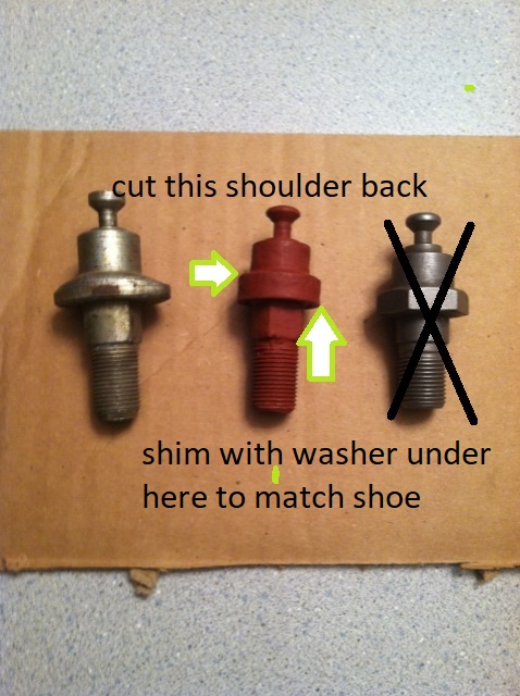

  26. Does anyone know the measurements for the F2 anchor pins? I found the F1 style and they have a measurement. IMG_0121.jpeg

    Cut the shoulder of an F-100 pin down to match the thickness of the shoes. The modified pins will take a shim washer to bring them up to the correct height and require an external star lock as a split lock will be too thick.
