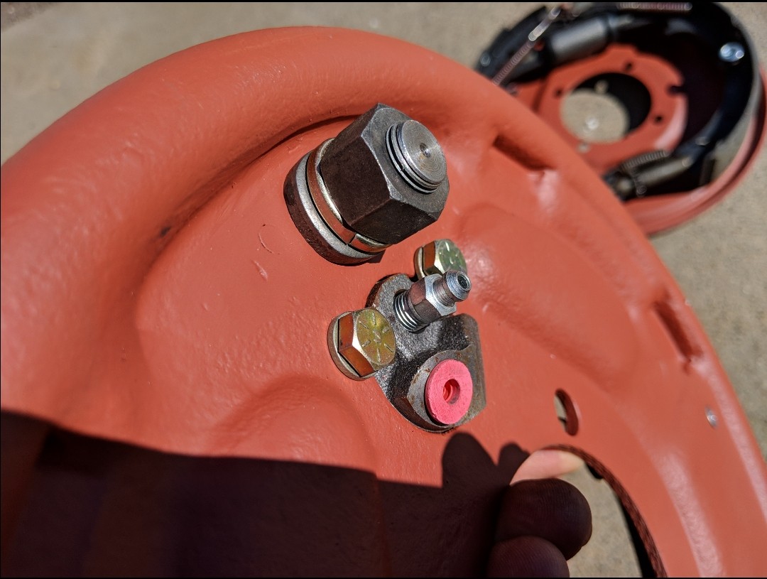

    @Rich B. I wasn't the stainless guy. Made mine out of 4140 but I do have a cad file. For some reason I am unable to upload the F-2 anchor pin dxf file here. If anyone wants it just click on the txt file below to open and save it to your computer, then right click the file to rename, and change the file extention to dxf. You can then open it with any cad software you like. I don't have any pics of just the finished anchor pin it seems. I know one of my phones died around that time and I lost some stuff. These two pics show the pin I made assembled in the brake. The dxf file is made so you can flat the area that goes thru the slotted hole in the backing plate. I used the special slotted washers off some F1 or 50 Merc front brakes underneath the big nut outside the backing plate.

    The ones I made are machined to the same functional dimensions as the left hand one in this picture that @RICH B posted. I measured some original F2 front pins and made a second set to convert a set of rear backing plates from fixed to adjustable anchor pin.

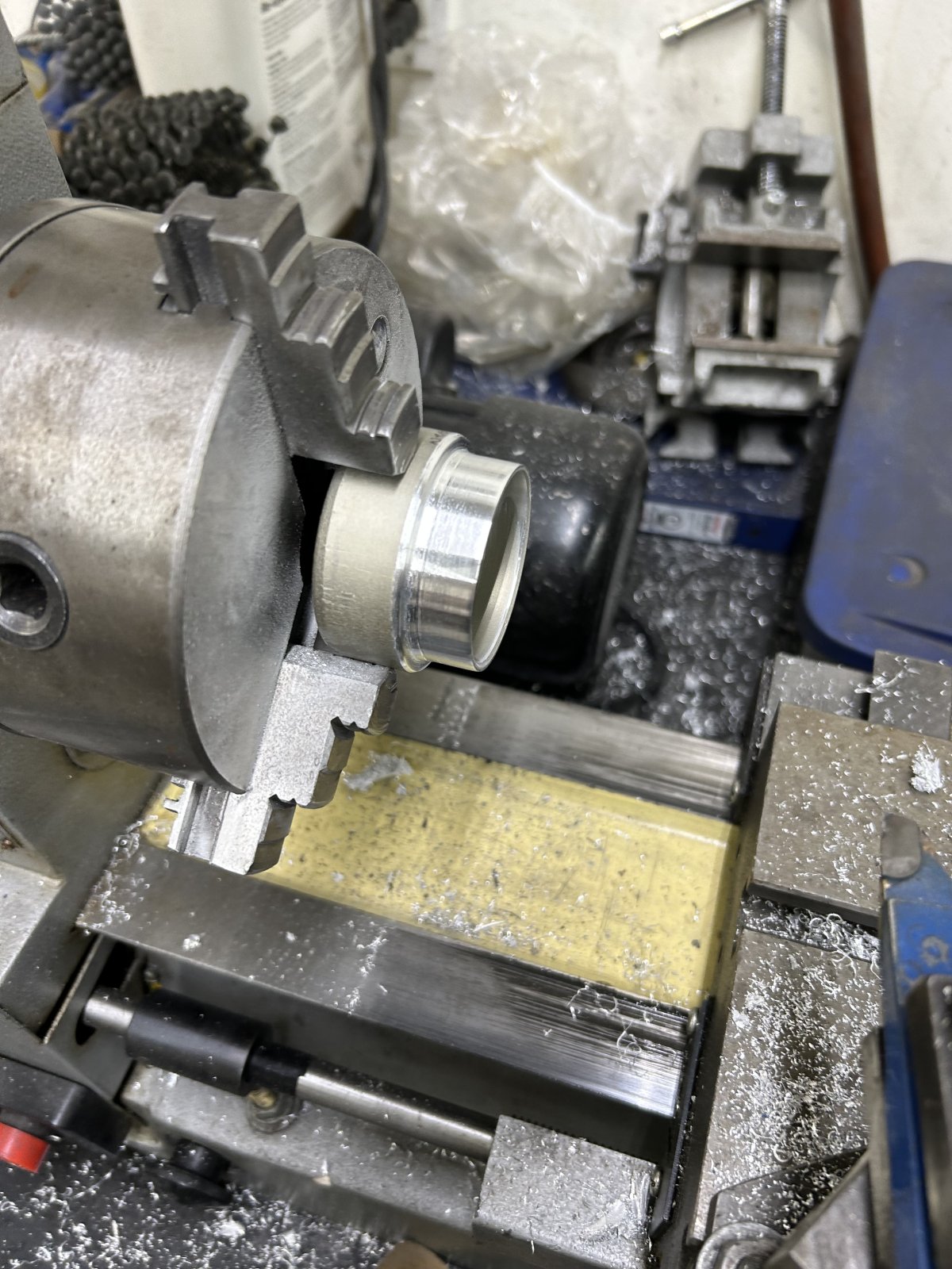

  29. After taking a few measurements and looking at the 2.085 cap I decided to scrap the idea of opening up the end of the hub to make that size fit. There is enough metal to do it , but I don’t like the look of that big cap. I am going to make a bushing that will bottom on the outside edge of the outer bearing race. I found a brake caliper piston from an old Harley Shovelhead that is the same outer diameter as the wheel hub. This should work well as a bushing once I turn it down on the lathe. The chrome dust caps are a must for the wheels I’m running and it’s the look I’m going for. Hopefully I can make it work. I will take pics and measurements if I’m successful.
    pprather likes this.
  30. Got the bushings made today and everything works well. I will post pics with the measurements of the bushings if anyone else is having an issue finding dust caps for 48-52 hubs. I used the Speedway chrome dust shields that measure 1.786.
