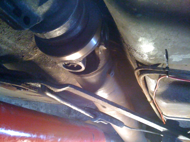

    I ran into a problem when installing the drive-shaft. The yoke didn't fit in my trans tunnel because it has that stupid balancer (see pics). I went on evil-bay and found a ton of c4 yokes without that stupid balancer, here I was ready to swap to a Fordomatic. I'm not even sure what year my already installed c4 is. I do know that it's somewheres from '78 to '81 and that it has AOD. It's mated to a '78 200 motor.

    Take a hammer and knock that ring off. It doesn't balance the drive shaft, its for harmonics. Knocked mine off years ago, no vibration.

    All C4 tail shaft are 28 spline. You just need one without the balancer on it.

    I done good because you done good. I knocked that thing to hell and back then back to hell and voila! The damned thing fit. :D Drive shaft is in!!!! I know I sound like turd muffin gettin all excited over such a small thing, but damn it's been a looooong road for me and I'm almost near the end. Now I gotta get to that pedal and carb :mad:

    That driveshaft is set too deep into that transmission, see the coloration of the old markings on the shaft, it needs to be out there. One good bump and you will snap the yoke the shaft or the uni"s. You may have snapped your speedo gear pushing it in that deep. Sorry I couldn't stop by. I have pneumonia. Lots of pretty blue pills to keep me breathing. Yippie.
  10. Pay attention to what Francisco said. If that driveshaft is run with the yoke pushed in that far, you are going to break some expensive stuff!

    Shit. I might have taken that picture before I attached it to the rear end. Great! Now I'm up in arms!

    Well, I'm glad. You see... when something might be wrong with anything... my OCD kicks in and I lose sleep.
    I just had to investigate if it was really in that deep.
    You be the judge. Good or no?
    Good looking out men!
