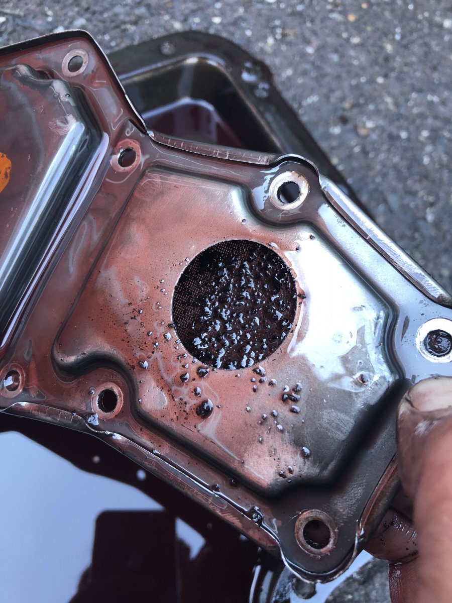

    A28CD67E-E787-4890-8963-B41D4F24227E.jpeg Filter was totally clogged with sludge and debris. Wasn’t metal... not sure what it is. Bands looked good from what I could see. Surprisingly look brand new inside. Thinking fluid has never beeen changed since 1971. Cleaned everything and putting a new filter in tomorrow. Hoping for the best.

    Did you get a picture of the bottom of the pan for us?
  13. Hay, what do ya know. The filter was doing it's job. If your going to re use the fluid be sure to put a Paint strainer in the Funnel to pour the fluid through. I'll bet you'll get a few more Miles out of her.
