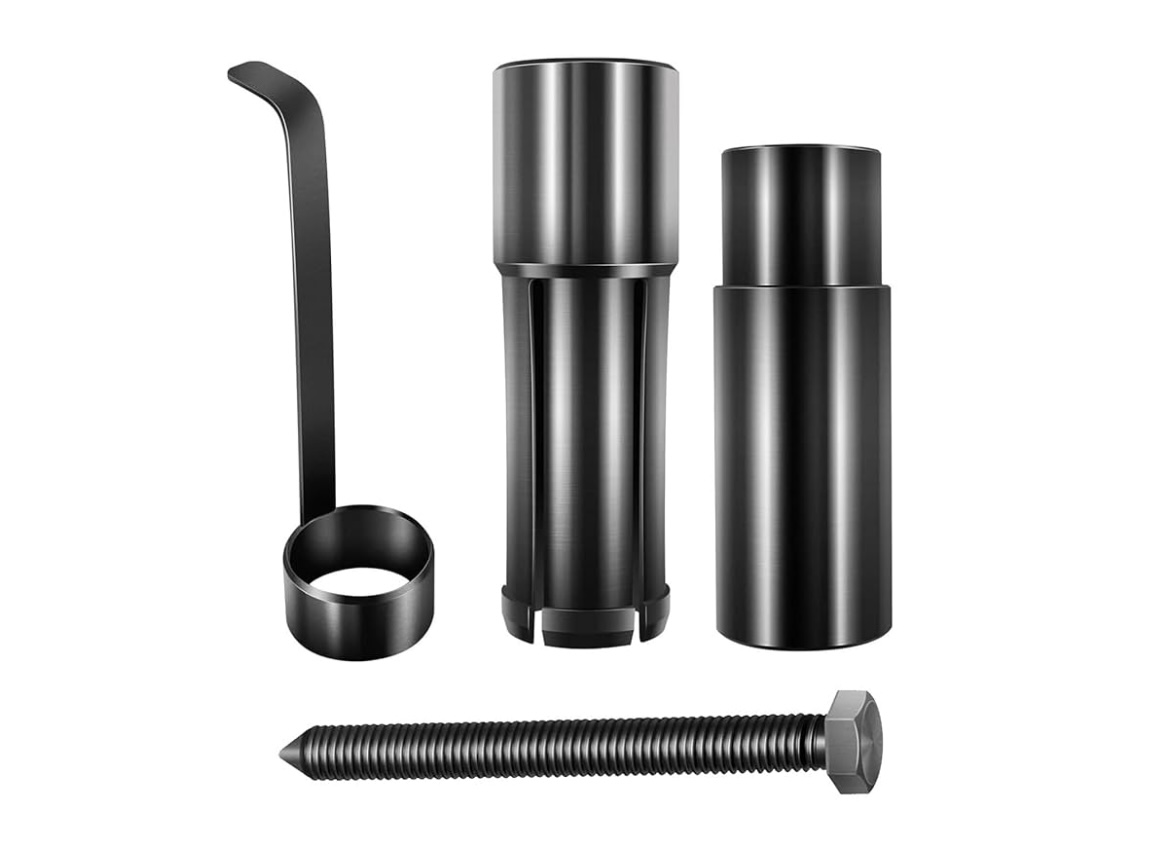

    Anyone removed the output shaft bush and seal from a Ford Cruise-o-matic while the box is in-situ?

    You need this for a cruise o matic. Bushing removal and installation tool. This one is for a TH350. This may work. Pretty sure TH350 and C-4 are the same. Cruise o matic may be same as C-4.

    Thanks Kevin. I’ll get a new bush first and compare the diameter

  9. I have one of those steel tools with an expander on the inside. I used it to remove and replace a t5 bushing. It worked well. I had the alum version before and it was a waste of money. I think the ebay seller was Zamcotoolsusa. The t5 is the same as the c4 which is the smaller id. The c6 is larger which I believe is the same as a tremec 3550 and the newer tko and tkx units.

    I’ve ordered one. We’ll see if it all goes to **** next week!

  11. There's a video on youtube that a trans guy is showing how to use the tool that will answer questions if you have any.
