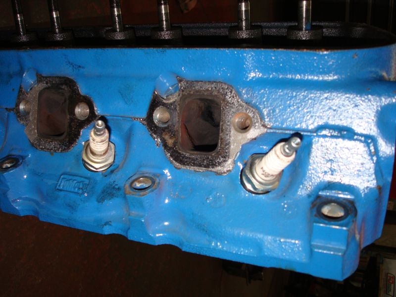

    Yep one year only - J-Code Mustang and Shelby GT350 WITH Thermactor ports which hinder exhaust flow

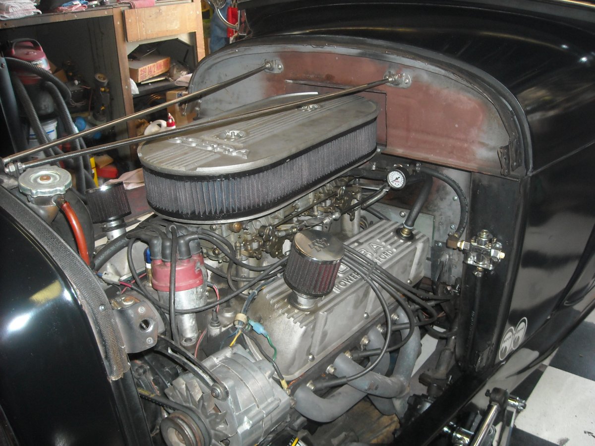

    Like this??
    Or the *****en 2x4 set up
