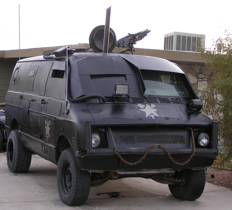

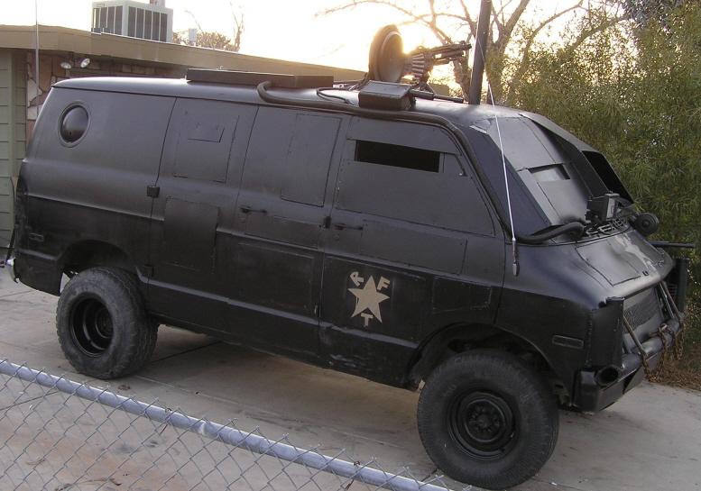

    I bought this dodge van ($100.00) for the motor and trans 360/727, and desided to have so fun before i called the junk yard. I guy offered me $500.00 for it when im done...
