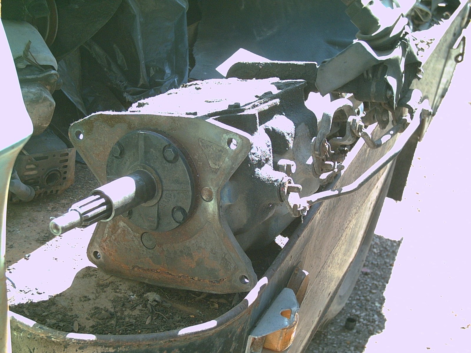

  4. Bellhousing for 1973 302 with 3 speed all synchro trans.
