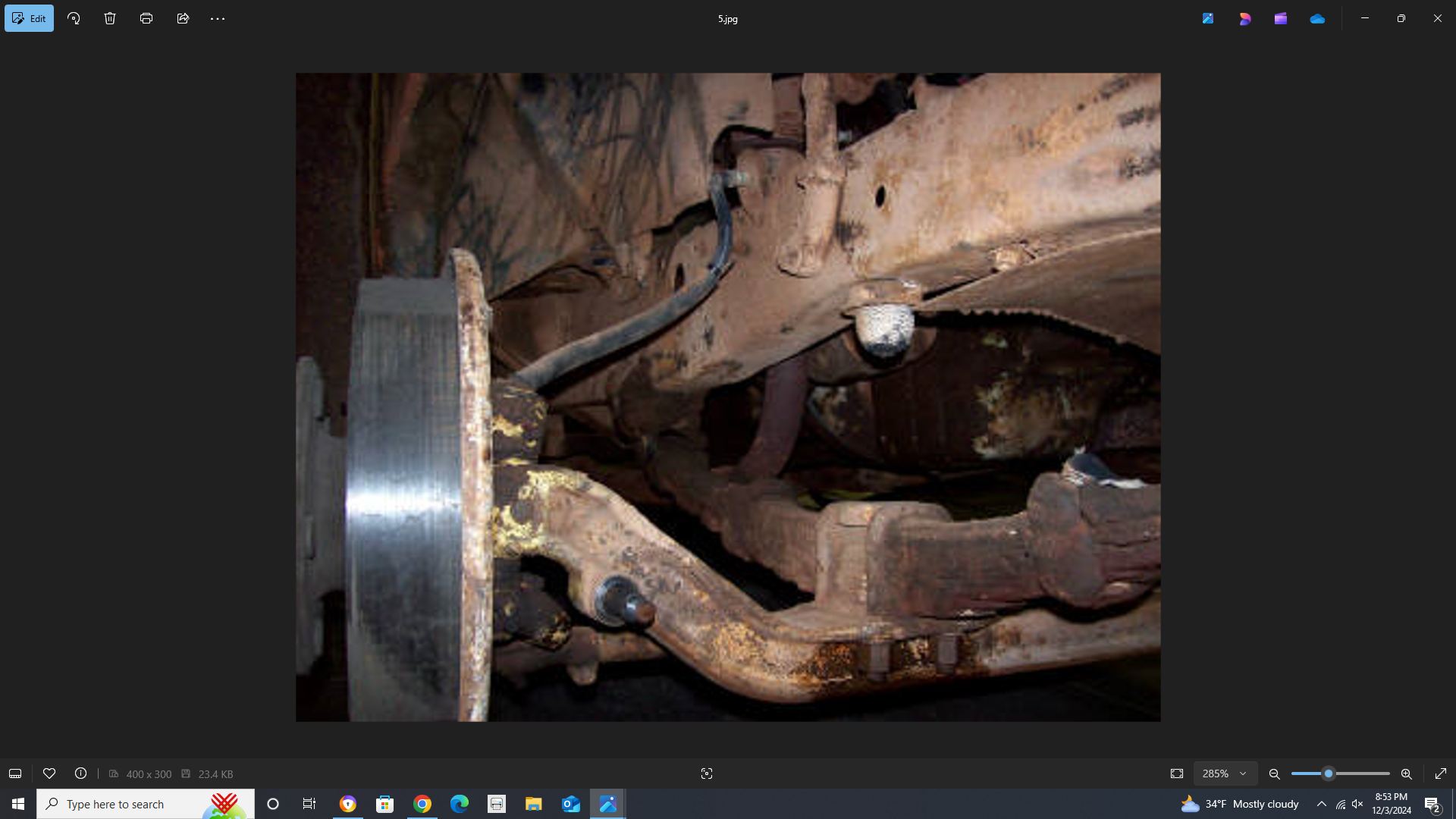

    Look at the taper for the king pin pinch bolts and then hope you remember what side the threads of the bolt stuck out . I'm thinking that the larger side of the taper goes to the front and the nut is on the back and serves as the steering stop. I think that was the way the 52 axle I had was when I snagged the front drums and backing plates off it. I don't have a picture one of that ch***is as they were on a computer that died a tragic death.
    Snagging this off Sid's site the shock stud goes to the front and the king pin pinch bolt goes in from the front . Screenshot (1682).png

    Factory specs call for around 1 degree positive if that because the trucks didn't drive that fast then and steering ease while turning was a lot more important than tracking down non existent freeways in that time frame. The more caster the more steering effort it takes at low speed. Screenshot (1691).png

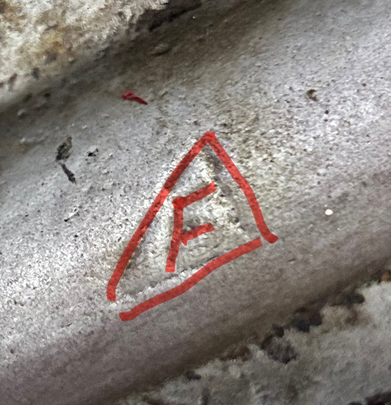

    As far as being symmetrical I don’t have an absolute, definitive answer, only what I’ve seen over the years. Model A and early V8 axles I’ve run across over the years may have AA, EE or in the case of the Model A axle pictured an F in a triangle on the forging. This photo is an A axle that was dropped, distorting the F.
    Some say that identifies the steel alloy. Maybe, but AFAIK Ford used a steel alloy that included vanadium for added strength. Could the different letters, and as on your axle the R, signify the forge shop or forging dies used?

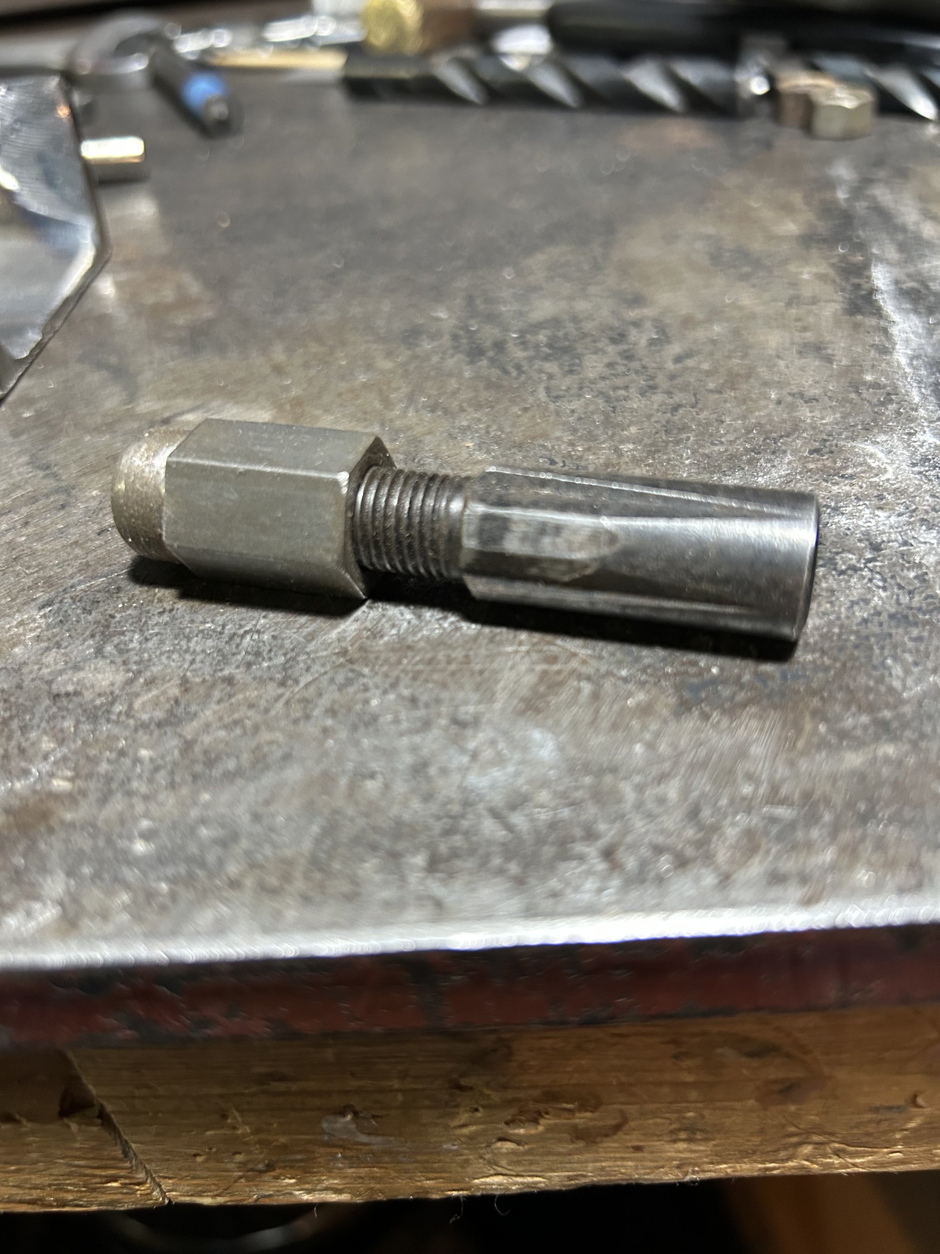

    Also, somewhere over the years someone did a king pin job on your truck, they didn’t reuse the steering stops. That’s not uncommon, they can get beat up and new ones don’t come with the k/p kit. It looks like the retainer has 3* machined into it to tighten the pin in place.

    If I had seen an F, I would ***ume that was the front! These letters meant something at the factory. like you said, maybe forge shop, dies, or even year, month, dwg revision, batch, etc.
    My stops have been missing since I got the truck in '84. During this research, only now I realize those are stops and they are missing.
    I was thinking the retainer pin had a slight taper.
