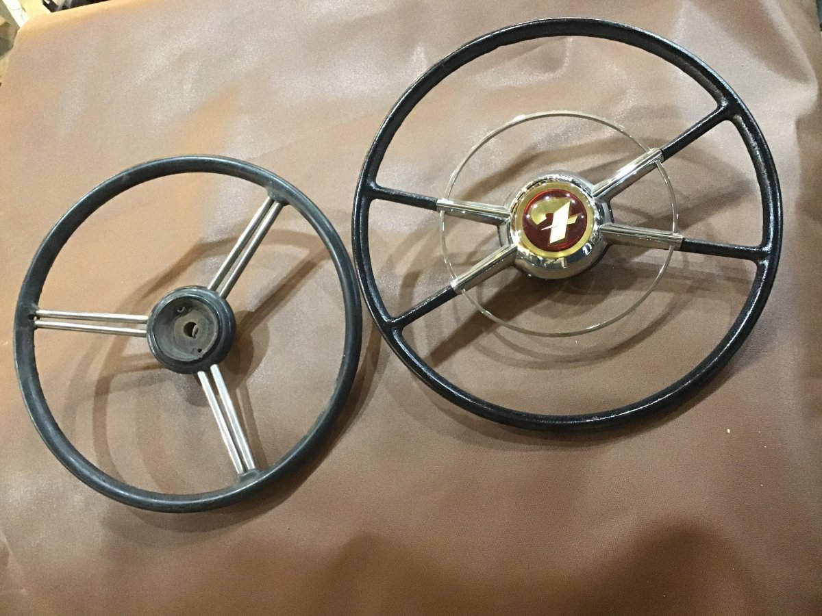

  3. continentaljohn
    Joined: Jul 24, 2002
    Posts: 5,827
    continentaljohn
    Lots of cool steering wheels that fit the splined taper end of the f1 shaft 1936 Oldsmobile accessories wheel and Crestliner... image.jpg
