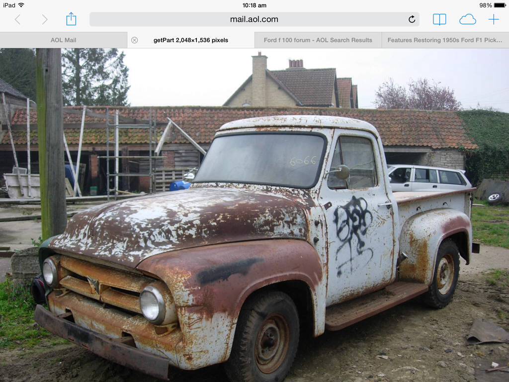

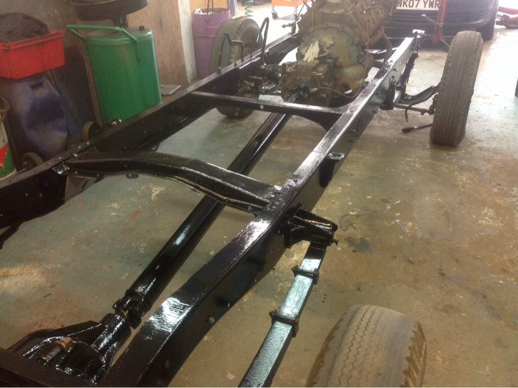

    Hi all this is my first post so here goes. this is my f100 53 flathead pickup 4 speed syncro. I've had it 2 months now and have made quite a lot of progress. I have purchased 80% of the parts needed
    It is totally striped down most of it is at the sand blasters and am waiting for its return in the meantime I have been working on the frame. the whole truck apart from surface is a totally rust free and from Oregon
    This is my first venture into American iron and I am as green as grass in relation to its refurb anyway here goes. I am wanting to leave it as standard as possible with the exception of pepping the engine up a bit ie just carb and headers so my question is what carb to use, is a 4 barrel the way to go if so witch one also what headers to use any help will be a great help thanks norm

    Thanks for the encouragement guys I'm still waiting for the body etc to return from the sand blasters but I'm expecting some more parts from the USA on Tuesday hopefully we will be able to start work in a couple of weeks here are a few more pics of the poor old girl

    The left front wheel on your truck in the photos is not original to the truck. It is from a later Ford pickup or from a '49 - '51 Mercury passenger car. The original wheels had the same design as the left rear wheel, and were available in 15 and 16 inch sizes. Hope this helps.
