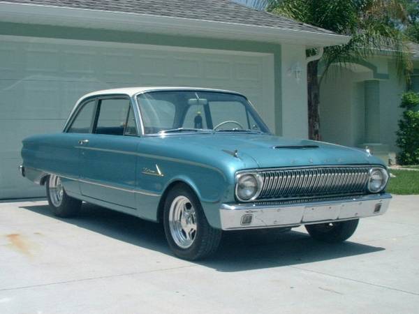

  9. spiffy1937
    Joined: Apr 9, 2006
    Posts: 733
    spiffy1937
    from Florida
    I know this is an old thread but I just found it. I put a 302/C4/9" in my '62 with no problems. Go to www.falconparts.com for info (click on "tech") and parts. The 6 cylinder springs are fine now that I installed new ones. I also put in a 3 row radiator, Granada spindles and disc brakes along with '63 control arms, '65 steering linkage and a Mustang II master cylinder with a GM brass proportioning valve. This make for a real nice, fun to drive car! :DI also used Hedman headers that fit great. The only thing I'd like to do is change to a power brake setup if I can find a booster to fit.
