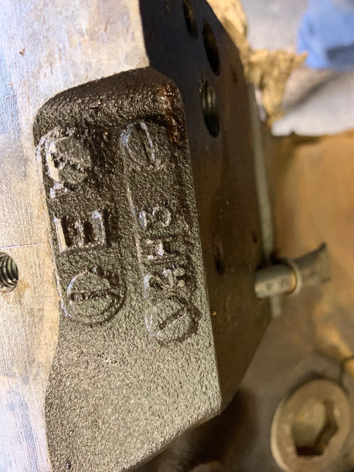

    Head numbers are easy, they are in between the two center ports.*

    The date code in day2's picture, 0E6, is May 6th, 1960, eh?

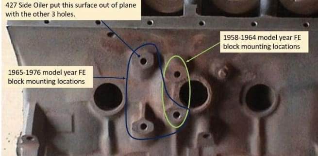

    Is it a 2 or 4 bolt engine mount block, as that narrows it somewhat. 427s are easier as they're cross bolted. 428 information attached.
    The best way to identify an FE is to measure bore and stroke. Block castings 352 was used in a few engines. www.mustangtek.com
    There is a pad on the right rear of the block on the vertical surface below cylinder head. If there is a stamped serial number and 4 engine mount bolts, it would be circa/post 1968.
    Check casting date on underside of oil filter adaptor
    Look for casting number on block
    Spooky, loudbang and Deuces like this.
