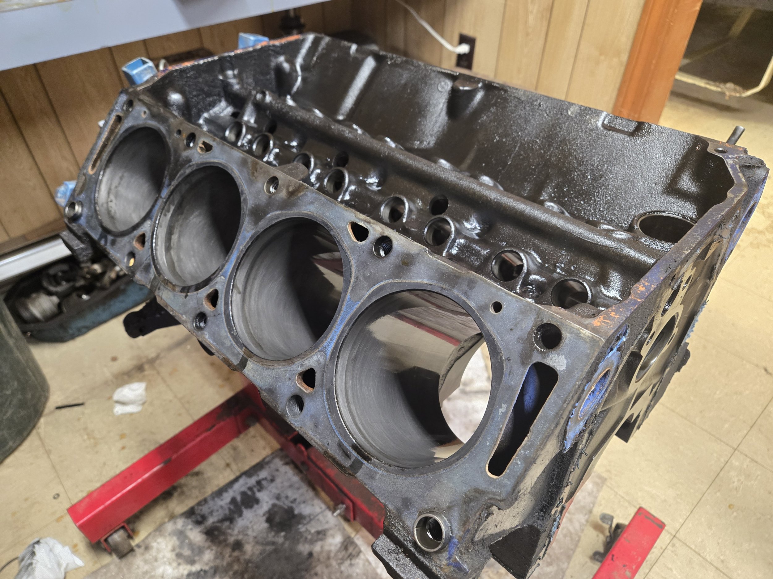

    Take a plastic hammer and tap on the edge of bearing to make it rotate in the bore then you can grab the edge and pull it out. You need to inspect the cam bearing if they look worn I would take it to a machine shop and have them clean and replace those. For cleaning at home I would only do this if I have a really good compressor.

    Thanks Saltflats. That came out in about 3 seconds.
    I do have a good shop compressor at least 50 gallons or so, so I ***ume you're saying just blow dry it immediately after cleaning?
    Honed the cylinders today so now it's time to measure bearing clearances (judging by what I've seen so far I'm ***uming they will be good), buy rings and gaskets, clean, and start re***embly.

    Saltflats, I guess I am not a good judge of volume - I checked today and it is a 200 gallon tank LOL. Next week is supposed to be nice weather, so planning on degreasing/washing/blowdrying/letting it sit in the sun to finish off the drying, then a coat of something (any recommendations anyone?) to protect it until I start the ***embly.
    Doug, thanks for that advice. I will take and apply all of it.
    I did the math today to figure out what compression ratio I have. I realized after the fact that I forgot to take into account the head gasket thickness (which I don't know yet anyway) but without that factor I have 9.4:1 compression. That is ***uming that my C6AE-R heads are about 72.5cc (according to a member of blueovalforums). I can live with that, and I would like to try the aforementioned steel shim gaskets. Every one I see is for 390 and up. Will that work for my 352? The FelPro head gaskets that were on it were 1/2" or so bigger diameter than the actual bore, so maybe it's not a big deal?

    I did pretty much the same as you honed and reused the pistons, I went with Hastings cast iron rings from RockAuto.

    Not much time for the FE lately, but I did hone the cylinders a few days ago and ready to buy some rings. I have done some research and there is more to buying rings than I thought! I called Summit for some technical ***istance/advice and she didn't know anything other than "most people like the moly rings".
    So my engine is pretty stock with stock pistons (I'm pretty sure) and a decent street cam (according to you guys). I am not going racing, but I do like to rip through the gears (four on the floor) and the rpms get on the high side for a second but not crazy. Other than for shifting, the pedal is on the floor until I get up to speed unless there is somebody in front of me holding me up LOL. What material do you guys recommend? Rings are pretty cheap, so I don't mind getting the best that will work for my application.
    If more info is needed to make a decision, then ask away.

    IMO cast iron rings for your application, I think they seal better in a re honed bore and should run good for many miles. If you’re reusing your pistons make sure your ring groove tolerances are OK.

    Cast iron rings fer sure...
    IF planning to run steel shim head gaskets why not get the heads milled ?!
    1. to bump up CR
    2. to get a smooth 'true' surface so the gasket will seal better.
    Money well spent and its not like you're on a dead-line to finish.
    "Look into" advancing the cam timing a couple degrees for more low end 'jump' ! Seems it advanced 2 degrees already
    Most 'on-line' computer-jockey and wannabe engine builders agree 6* advance will make a noticeable improvement on low end torque and you're not planning on reving above 5500 RPM anyway !

    Plain uncoated grey iron rings are suitable for lawnmower engines and that’s about it. The industry moved on from that technology years ago, and there’s really no good reason to use them today.

    What’s your suggestion for a dingle ball honed cylinder with with in spec taper etc. I’ve used cast iron rings with good results but if there is something else that seats well in said bore condition and works/lasts longer I’m all for it.

    Yes, I ordered cast iron rings based on the intel above. I'm good with it. She'll get 1 or 2k miles of "spirited driving" a year. Rings aren't here yet, but due on Monday.

    you can use one of the old rings to clean the ring grooves snap it in two or three pieces and use it to gently remove all the carbon from the ring grooves i also like to use a simple rifle cleaning kit with cloth or cotton patches to clean any oil p***ages then a trip to the car wash to clean al l the small corners out then home dry

    Even thought the ship has sailed, I'll add that I've done a couple of hone and go jobs. My Dad called those a ring and bearing job. One on a smokin' joe '65 413 that ran really well. So well that I bounced that Polara off a tree, then swapped the 413 into a Charger and lost my license right quick. Also did a German car that had 180k miles on the clock, hone and go, I think it went another 70k miles.

    I had trouble getting those to seal on my resurfaced heads. Steel shim head gaskets need a very good surface finish that my local engine place didn’t seem to be able to do. I used a Felco composite type in the end.
    You’ll be surprised how well a 352 goes. I’m sure mine on a 2bbl is quicker than the Ms modern car even in a 4000lb Mercury
