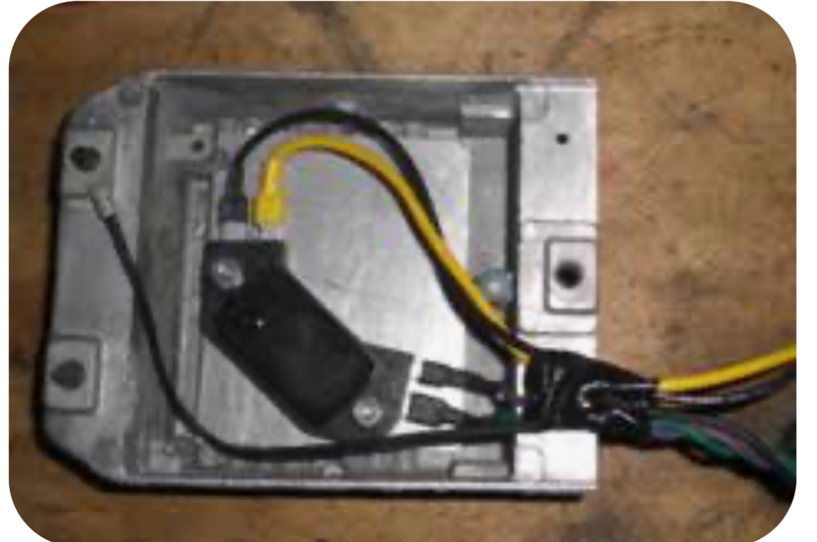

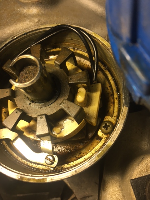

    I'm running a stroked 390 FE motor in my 1964 Mercury Marauder that was converted to a breaker-less set-up back in the 80's. The 360 FE motor the distributor was harvested from came from a 1975 Ford a pick-up truck so I always****umed it was a Duraspark unit. The problem is that the ignition control module bears no resemblance to the Duraspark box and I have no idea where it came from. There are no numbers on the module that I can cross reference. The distributor is a Motorcraft unit but internally it doesn't look like a Duraspark either. It has 2 wires connecting to the sending unit and I'm guessing that perhaps the previous owner bought an oddball breakerless setup from a vendor like J.C. Whitney back in the day. My ignition control module works fine but it's been running super hot and has been leaking lots of a tar like substance, hence my desire to replace it. I've wired up a brand new GM HEI module as per the instructions I've found to but have had no success with it triggering a spark. FYI, I'm attempting to use the stock canister style coil that I'm been running with the mystery ignition control module for years.
    I'm getting pretty frustrated at this point and guess that the spark trigger mechanism isn't providing the type of signal the GM HEI box needs to see. Throwing a lot of money at a new setup isn't really in the big picture at the moment so any help would be greatly appreciated.
    I'm attaching photos of the inside and outside of the distributor and a shot of the mystery box with the hopes that someone may be able to enlighten me as to why this setup isn't working.

    prestolite, but the ones you can find to replace it have only 4 pins on the connector, plus a separate pin
    like SMP LX401
    look up 1975 Jeep applications

  4. That's not a Ford Duraspark distributor. The stamped number D2TE visible on the housing identifies that as a '72 truck unit which would have had points. Just what you have is a mystery; starting in the early '70s, everyone and his brother was selling 'electronic ignition' conversions, most of which soon disappeared off the market. That isn't one I've seen before. Hopefully it hasn't been cobbled together from****orted bits.
    If it is a converted '72 unit, your cheapest fix would be to reinstall points which will necessitate some rewiring and maybe adding a ballast resistor if one isn't there. My second low-cost choice would be a Pertronix under-cap module, eliminating the exterior box. Again, some rewiring would probably be needed.

    maybe it's a hall effect sensor?

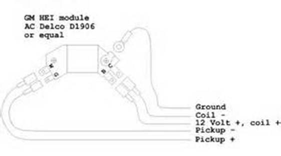

    Probably that pickup in the distributor is made to work with that “mystery box” or as mentioned a type of Hall effect sensor which is basically a switch, you need a proper reluctor and pickup unit that triggers the GM module wired as below with no “mystery box”

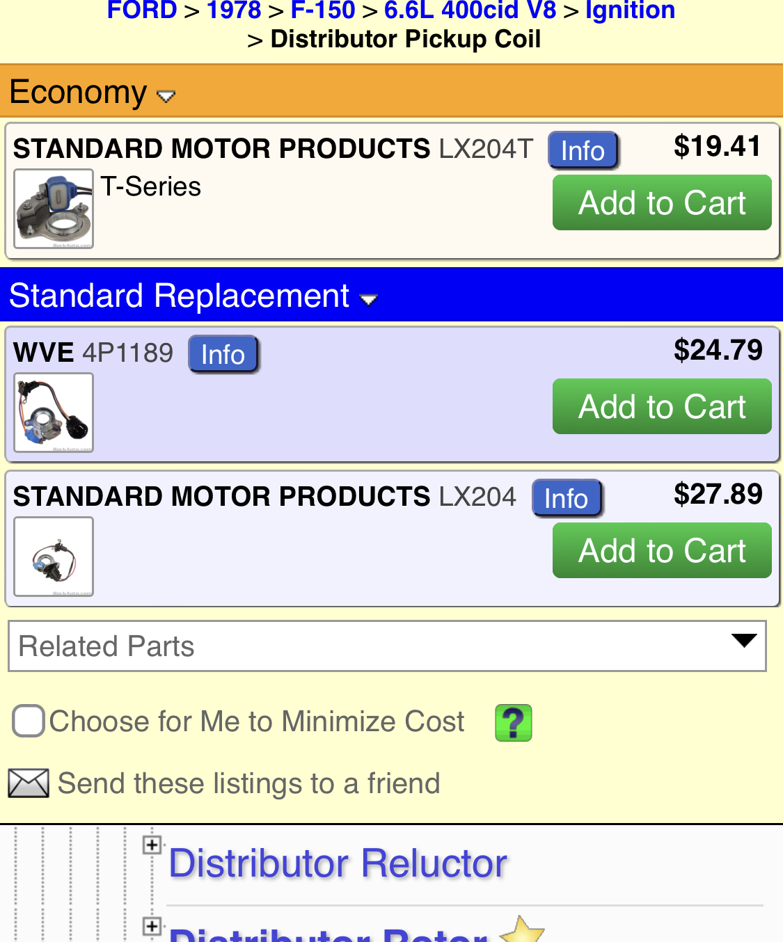

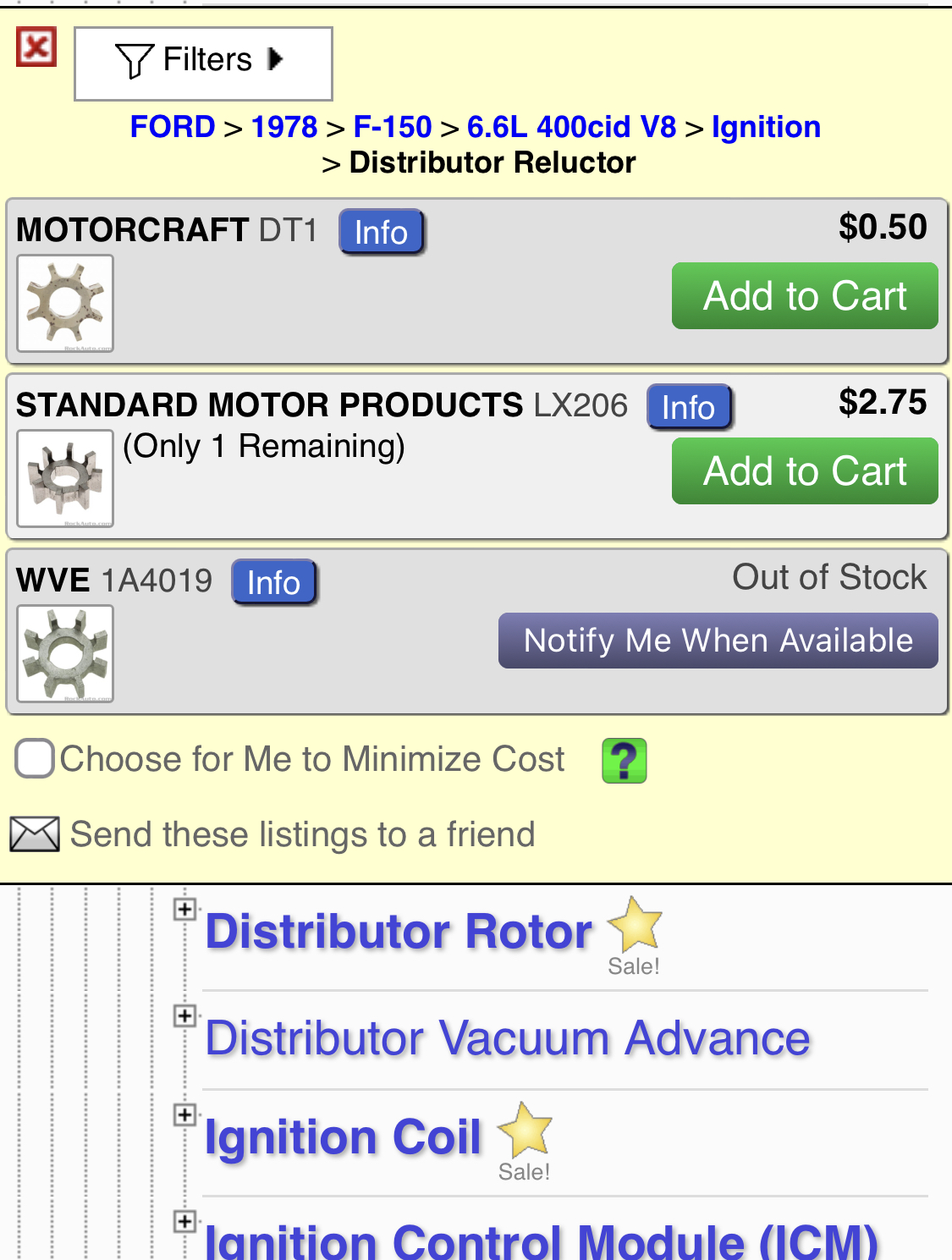

  15. Heavy Old Steel
    Joined: Feb 1, 2019
    Posts: 103
    Heavy Old Steel
    Going to require some work but, If you are able to do the mods in your distributor to get these 2 parts installed in there and set up the timing and air gap at .007-.008 it will work
  16. gwingard
    Joined: Nov 18, 2009
    Posts: 4
    gwingard
    Your diagram is precisely how I had the GM unit wired so it would seem that the triggering mech in my distributor produces a different type of pulse.
  17. Heavy Old Steel
    Joined: Feb 1, 2019
    Posts: 103
    Heavy Old Steel
    Correct
    A reluctor will create a voltage that triggers the GM module

    chicken
    from Kansas
    The Duraspark reluctor and pickup coil produce an AC voltage signal that can be measured on a meter if you spin the distributor by hand. I usually see 1-3 volts AC. The HEI pickup does the same. Your distributor likely uses a switching mechanism as stated above...Hall Effect or Photo sensor and won't work well with the HEI module. Easiest way is to get a Duraspark distributor for a mid '70's FE engine and use it with your module. I'm running that setup on my small block Ford and using a stock can-type coil. Works perfectly.
