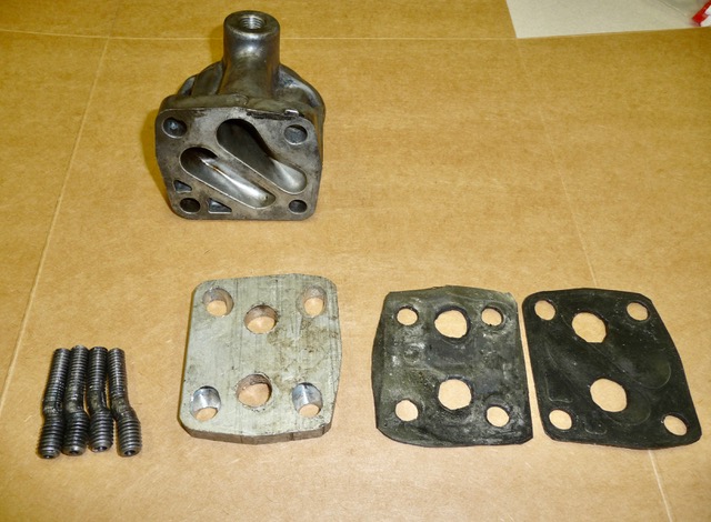

    I saw a loose FE housing laying in a s**** yard and thought it might work on my hemi. A sandwiched aluminum plate and some modified bolts and it worked

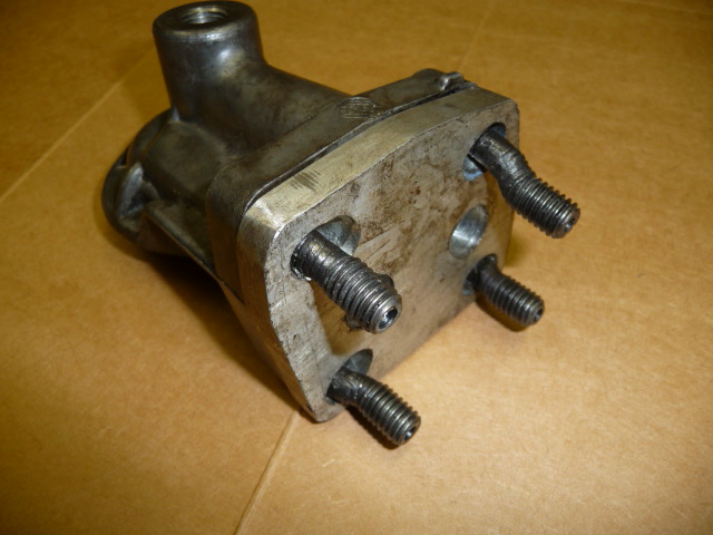

    The studs need to be offset and 3/8 on one ending 5/16 on the other. The plate is 1/2"

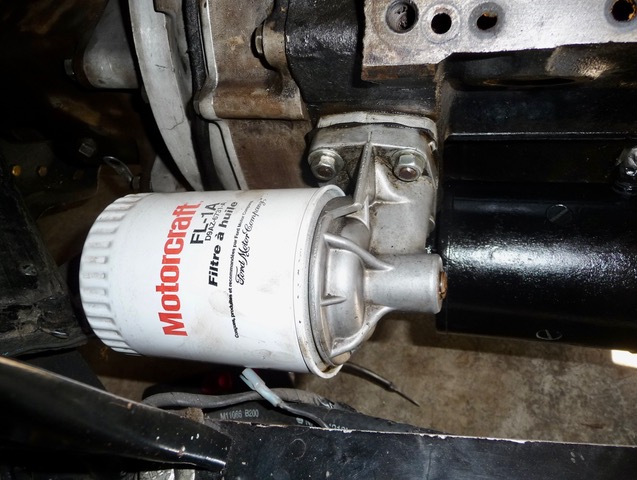

    I like it because it uses the big Ford filter in my Ford. It angles the filter straight back out of the way.
    You put the block gasket in place and screw the studs in. Slip the outer gasket on and the housing and bolt it up.
    I ground the bolts down and rethreaded the ends. I got the offset by spacing the ends out and heating and squeezing in the vice. They are all the same.
    No mods to the housing or the engine.

    I wonder if there would be a market for a sandwiched adapter plate.

    I'd be afraid that those already compromised bolts might break under long-term continuous vibration. On the hemi in my race car, I used the 1/2" aluminum plate as an adapter for a remote oil filter (drill 6 holes, tap 2 for 1/2" pipe) and ran dual remote filters. The "old-timers" in my race club said that "them hemi's need lots of oil". By the time I got done modifying the pan, adding dual filters, and installing an oil cooler, it took 14 quarts. The only problem I had was warming the engine up for 15 minutes before the first race.:eek:

    The bolts have proven to be just fine. The car has been on the road since 1990. This is the only filter and bolts ever on it.
    They sure would be under more stress in a race car and not in a smooth running street car.

    I'm sure your real life experience says more than my mere speculation. Those bolts sure do seem "tortured", though.

    If someone wanted to produce this without the tweaked studs ( which I consider a brilliant solution for a one-off) it could simply be offset a short distance and use separate fasteners for the block and filter housing, being careful that the p***ages connect.

    I'll bet the Harley studs were specifically designed and produced for this purpose, not ordinary bolts mangled in a vice.

  21. I wonder if it may be easier/cleaner to plug the existing holes in the filter mount then re-drill to the Chrysler pattern. It looks like a few may be close to the oil p***ages; a sleeve should fix that. A additional space-gaining measure would be to reduce the threads in the block down to 1/4" then use grade 8 bolts. You don't have the heavy steel filter cartridge hanging off it anymore, should be more than adequate. That should eliminate the intermediate plate altogether.
  22. Andy
    Joined: Nov 17, 2002
    Posts: 5,389
    Andy
    Per engineering handbook. Tensile strength of a 5/16-16 bolt is 6600 lbs. Even at half strength they
    would still be sufficient.
    Piper J-3 cubs used a single 5/16 to attach the wing struts. They were in double sheer though.
