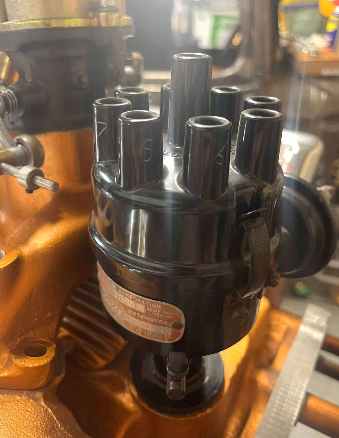

  8. Tat2Neil
    Joined: Jul 19, 2022
    Posts: 134
    Tat2Neil
    from Mesa AZ
    Yessir, I used a Pertronix unit to replace the original points. Put on a new cap and it works like a charm and I love the original look. Still the original rotor, if it ain’t broke don’t fix it.
