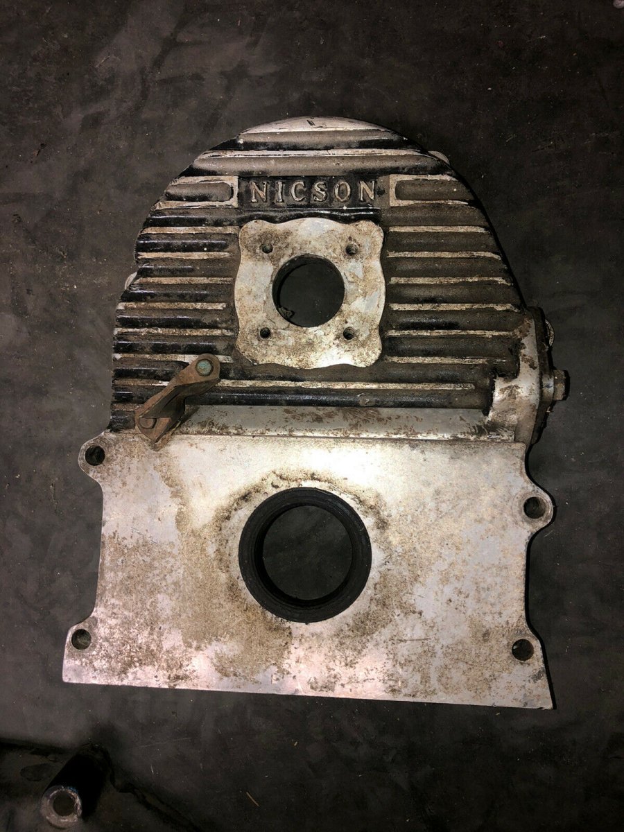

    There is also a cast iron front cover with a flat surface for mounting in medium truck/ FT applications, IIRC made for the 330MD that used some FE features. I have one in the shop, casting # is something like C7TE ****. Some boat stuff also has that feature, like the H&M part, but they usually go for big money

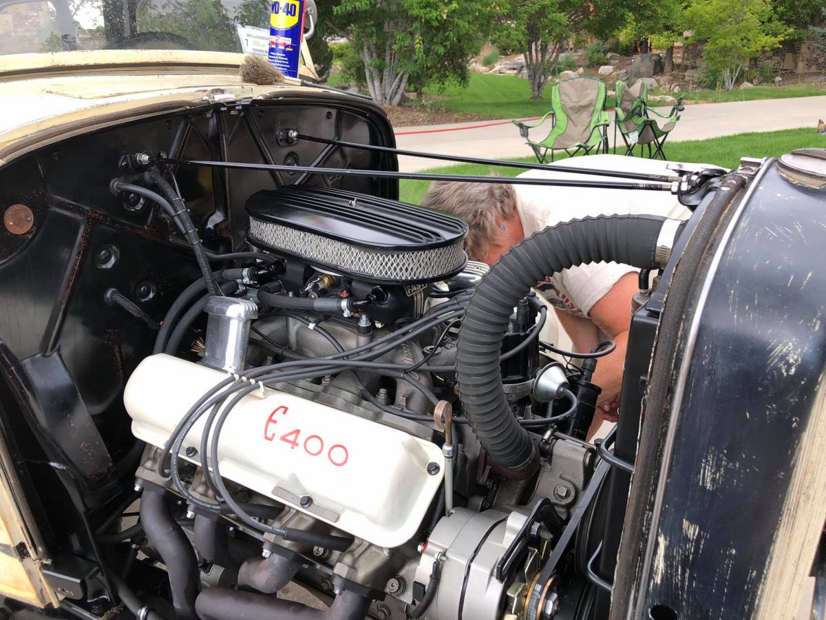

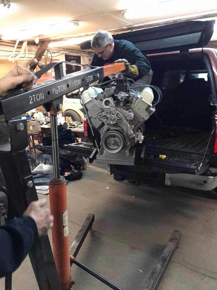

    I have a 406 in a Model A that I am building. It has regular location motor mounts that I found on Ebay. inexspensive headers that came from Ebay. You need a truck oil filter adapter, and the 4WD truck rear sump oil pan. I put the flat 32 firewall in my A and 4" of stretch in the front frame. I will get some pictures and post tomorrow.
    Dutchnola and Stogy like this.

    Gene is spot on about finding an old 330 FT with the front mount. I replaced a blown 330 with a 390 for a local guy a few years ago in his F-600, and that was one of the pieces that had to be transferred over to the 390. The center drop exhaust manifolds got in the way of the typical car and light duty truck mounts. I completely forgot about the front mounts on those motors. You can sort of see the mount in this old magazine image from Ford.

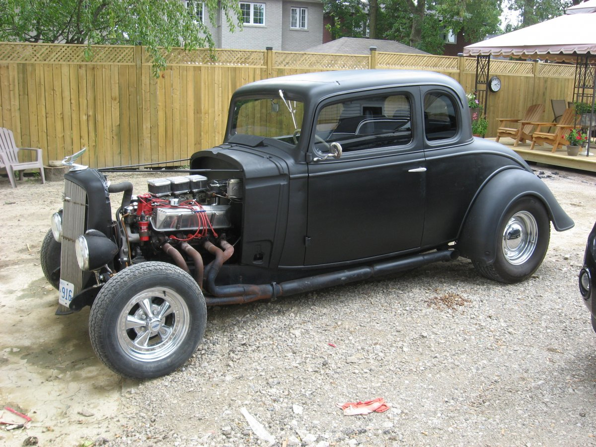

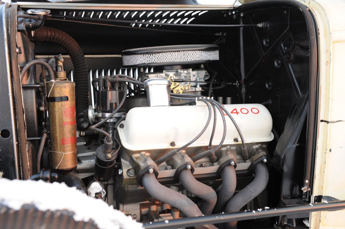

  22. 34 chev, on a 34 ford ch***is ,390 ford powered . Couldn't get exhaust inside the frame rails , ran remote filters as well ,but it seems thinking about it I did have the truck filter mount on it for awhile , They are a wide block !! noname.png

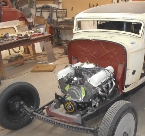

    Try and find a 35-36 pickup/truck firewall. Use the lower section from a 35-36 Ford pickup firewall and graft it into the 33-34 firewall. I think this will gain you about 4" of clearance by doing this.

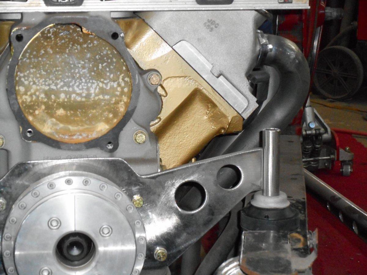

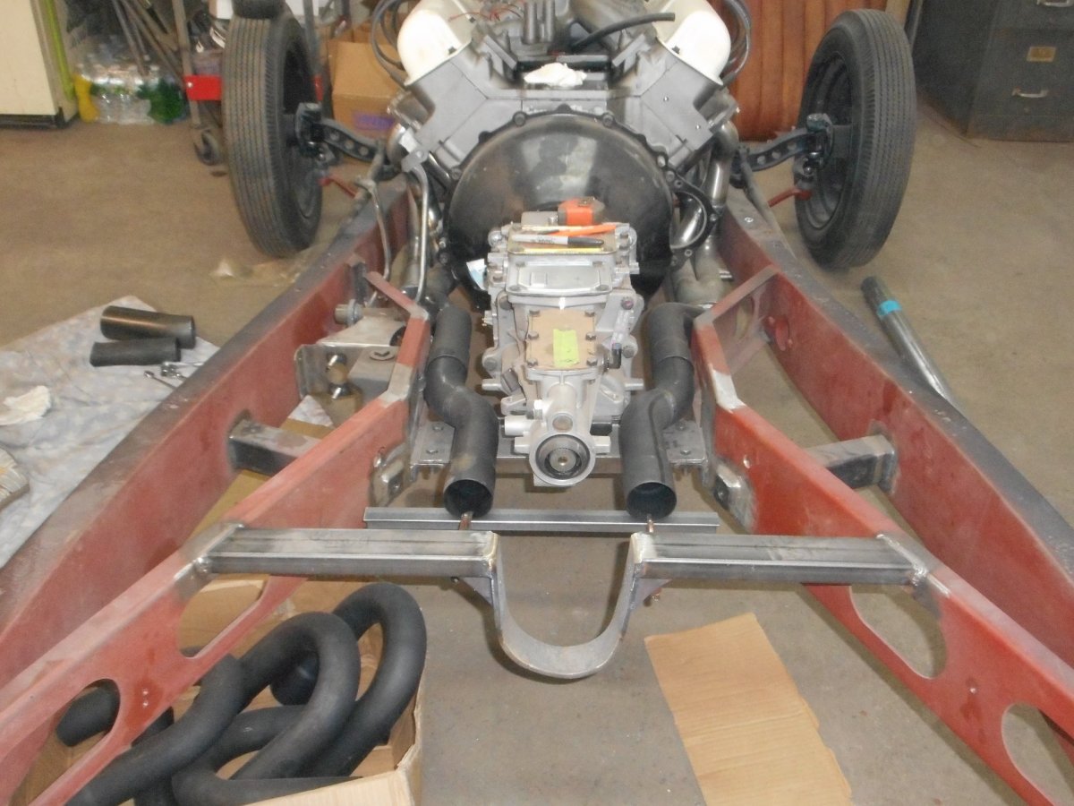

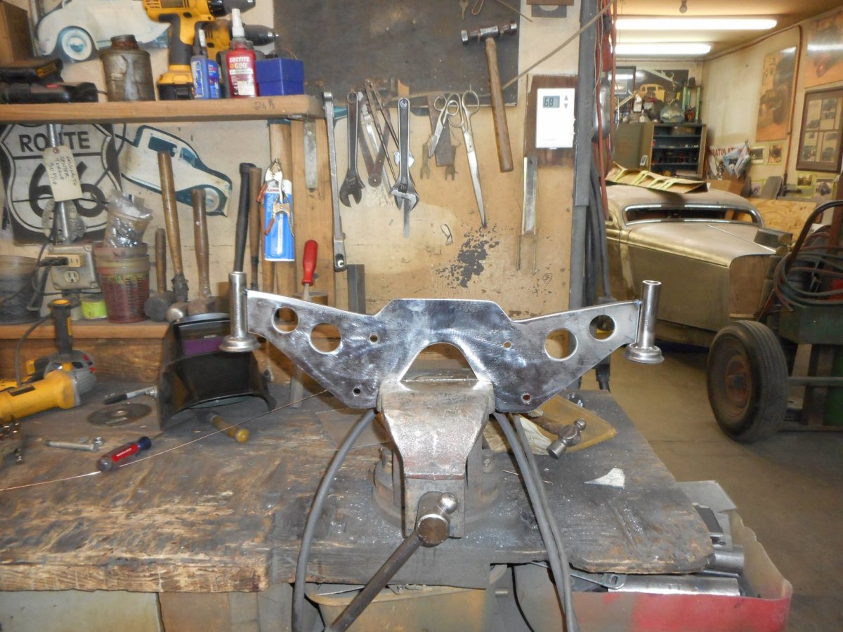

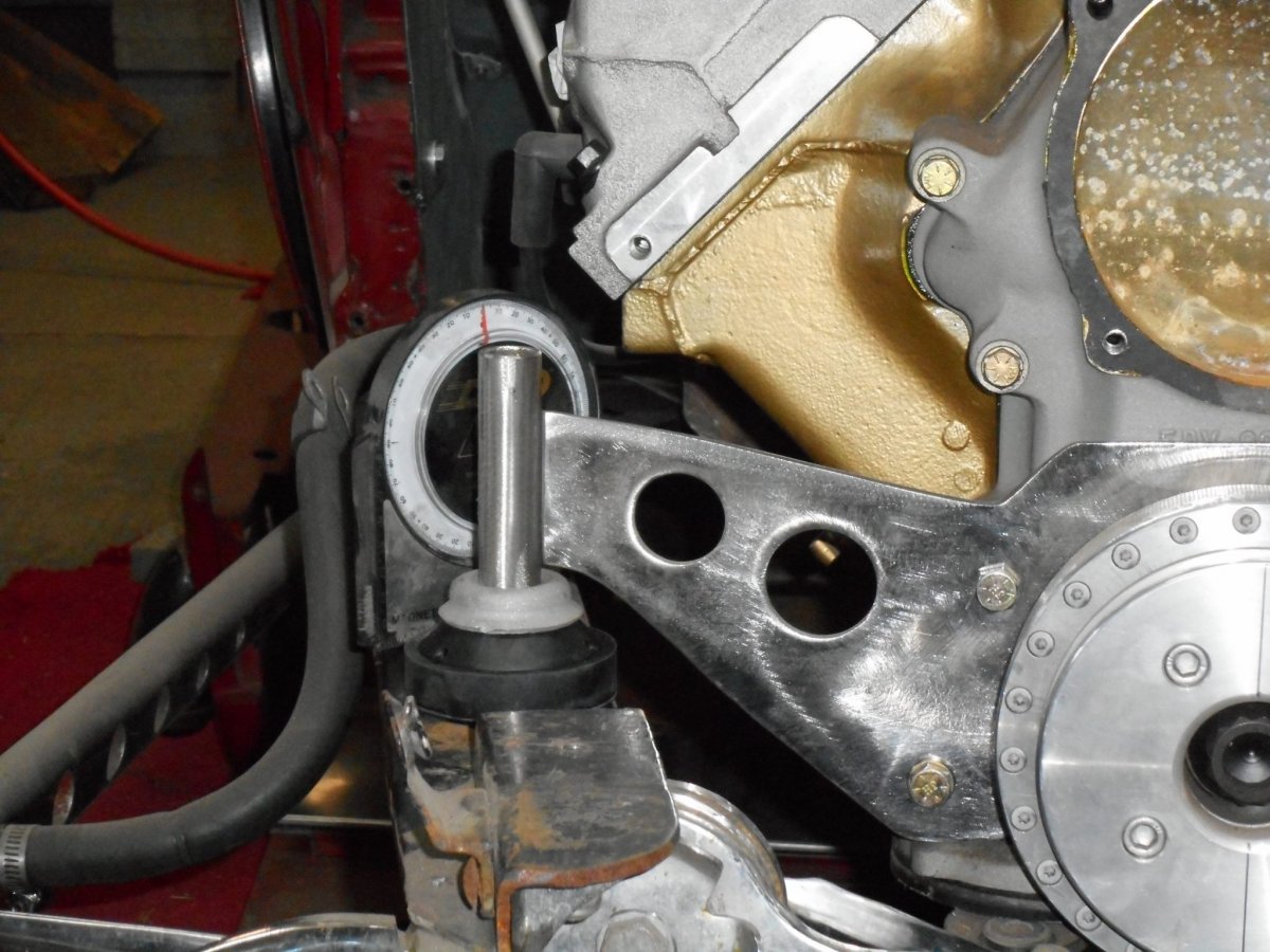

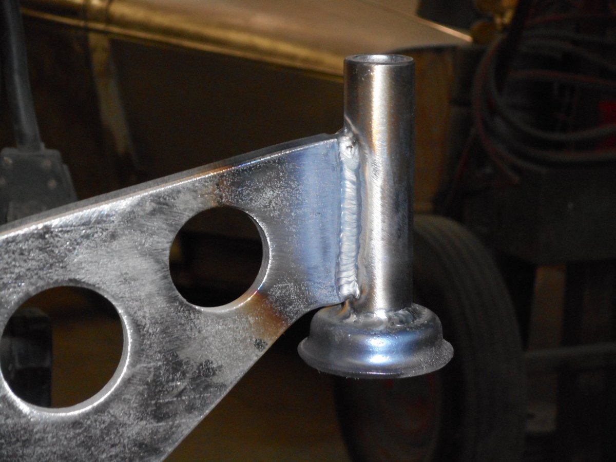

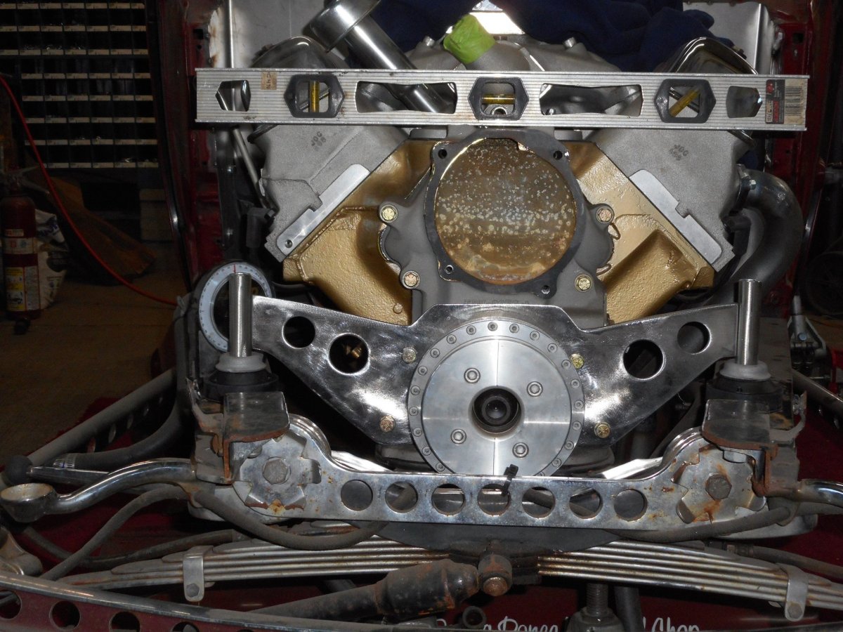

    I have several pic's of Judy's tudor from the Rolling Bones FB page that I have saved. From the pics I have it looks she's running a front mount with an oil filter adapter to move it along side the block. I don't think there is a mid mount on her car. She's also running cowl steering which saves a ton of room. Some of the pics are from a different car but you get the idea on how they build the front mounts.
    One thing you need to remember about running a FE in an early 30s Ford. The LH front of the engine gets really busy, really quick with the oil filter and fuel pump up there. What are you planning to run for steering?
    79922120_2756000597772331_6209585011281100800_o.jpg 81484870_2756004387771952_4666832999076069376_o.jpg 29340502_10204213850863982_3167336654776041472_n.jpg 29314489_10204213974347069_2586172707125067776_n.jpg 68825793_10206023262858151_5910309413763153920_o.jpg 29664790_1726322754073459_7733901870013074131_o.jpg 17546822_1346480345391037_5967163604251821987_o.jpg 17505190_1346480132057725_9102900533928563539_o.jpg 17504952_1346479975391074_5790643228860778022_o.jpg 17434493_1346479748724430_4036866452635033065_o.jpg 17493050_1346480672057671_4741431516944439828_o.jpg s-l1600.jpg

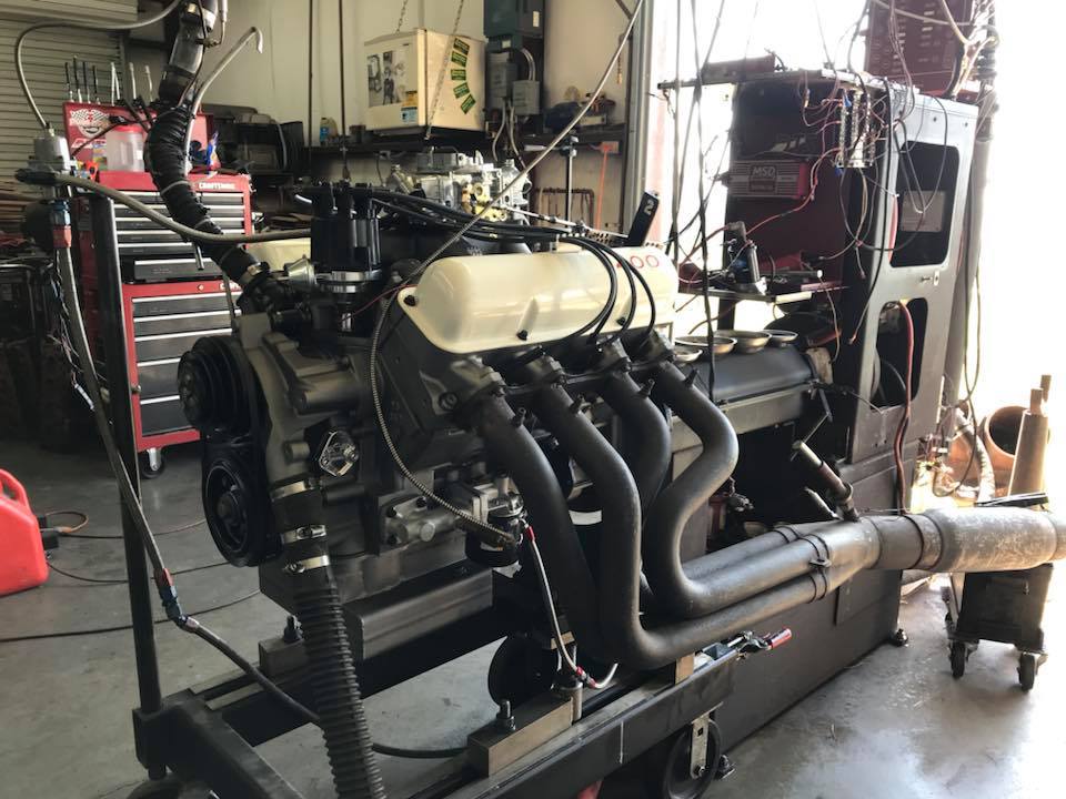

    Got any info on that engine build. If you didn't notice it has one of those kick *** intake adaptors so the intake on top is a 351 Cleveland bolted to the adaptor.
    Will do more googling about it but that is a spectacular engine. Thanks for the front mount pictures .

    All I know about it is that Ted Eaton built it and it makes a lot of power.

    Ironford you have hit the mother load of photos for me. Just what I was looking for. Detail photos of Judy's sedan. I was thinking front motorplate with cowl steering giving me room for the headers. R.B's posted a photo series on F.B. of the motor plate build, but I could never find it again. Thanks To everyone for the ideas.

    No worries, glad I could help! Here are few firewall pics. The Gold Hemi car uses a 35-36 pickup/truck firewall. The other picture is from Clarks 34 coupster build running a Y-block.
