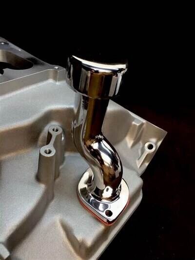

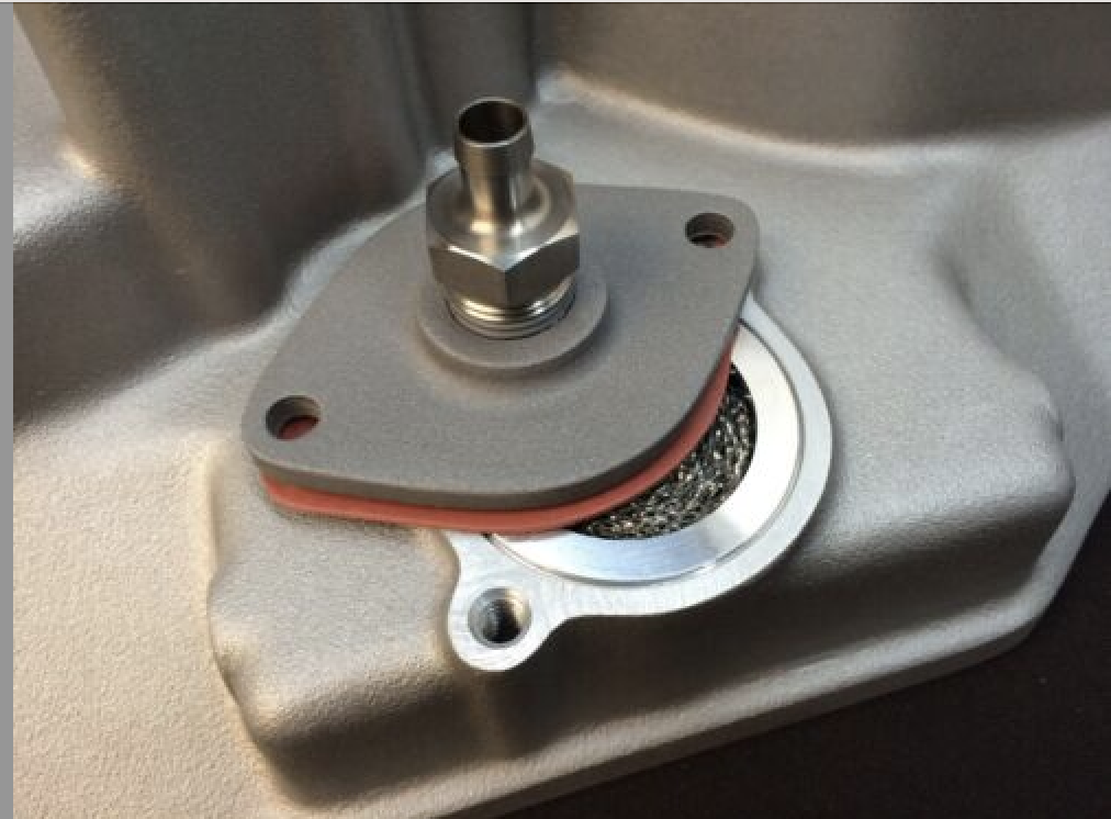

    You could always run on of these on your 428 P rear of the intake.
    I would just breath through the rear intake with a PVC set up.... and fill oil like Bones mentioned.

    I have seen that. I read somewhere on the internet that the cap doesn't come off... like it's attached somehow? I emailed a guy that sells them on ebay asking if it had a removable cap.

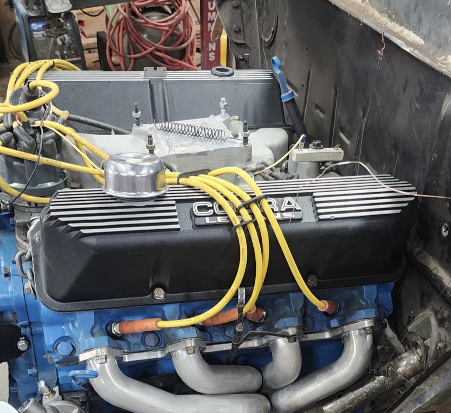

    It currently has the Cobra Le Mans valve covers that just don't match the look I'm going for. They are fantastic covers I wish I could just use them but I'm not sure my brain will let me. Definitely not running the yellow wires! Haha! 20241016_121600.jpg 20240919_124100.jpg

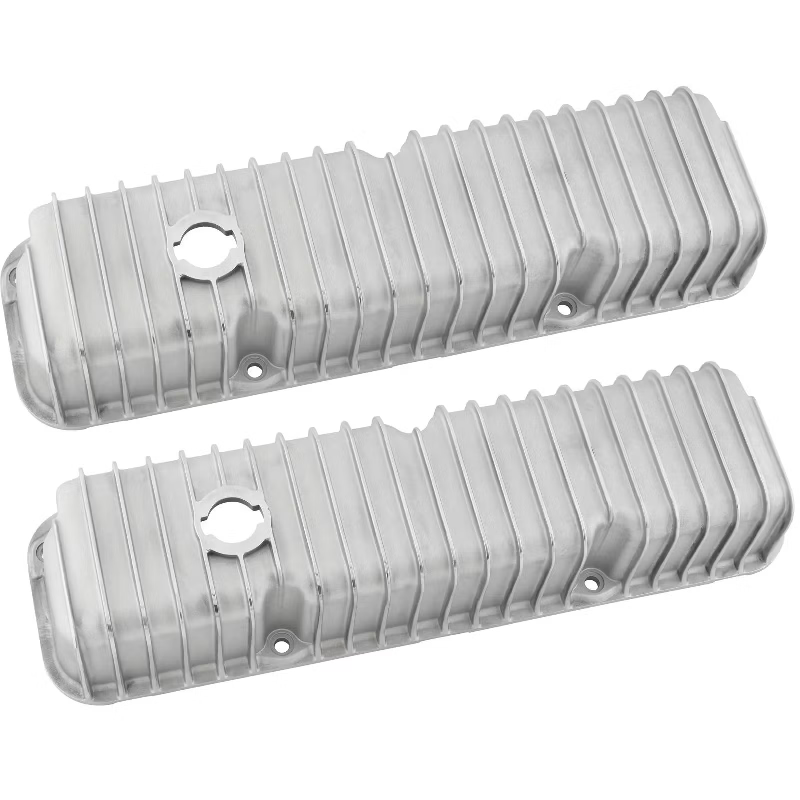

    If you like the look of those but don't want the "Cobra LeMans" or any other wording on them, Ansen makes them in plain finned (and just about any design you can possibly think of on them). I've got a set of their plain polished covers on my daily beater F100....Oh, and they're made here in the U.S.A......I actually got mine for discount, because I called up and they sold me some that were display models.
    https://www.ansenvalvecovers.com/collections/ford-valve-covers?page=1
