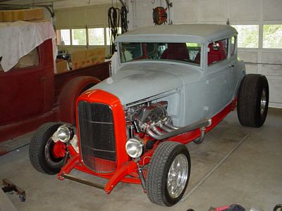

    If you think that's bad you should see my Model A Coupe with the 428 FE with two 4 barrel's on it. I have to put racing gas in it, or high test with octane booster so it doesn't get driven on long trips anymore.
